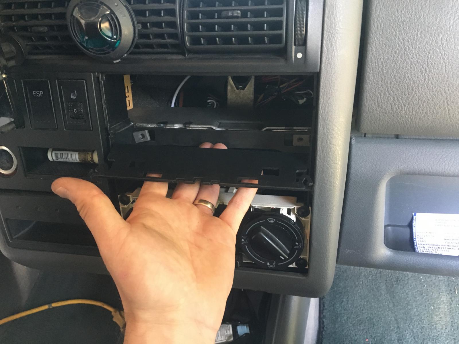

I just finished installing a SONY XAV-AX100 6.4" display touch screen head unit with CARPLAY and Android Auto in my 2001 Eurovan Weekender. This is a single DIN radio with a Double DIN display that with some cutting will fit in the Weekender.
Here's how I hacked it in; maybe it will inspire some of you as well.
Summary: About 1-2 hours, some cutting required, finish looks great although the headunit is not "secured" into the dash the way I did it.
Materials:
    1) XAV-AX100
    2) Metra 70-1784 Radio Wiring Harness
    3 )ISO to DIN antenna adapter
    4) Metra 99-9107B, which is apparently the newer version of the Metra 99-9102 2-DIN mounting kit (I also noticed a kit called "XTRONS Universal Double 2 DIN Frame Trim " on amazon that might work.
Process:
    1) Remove single DIN radio

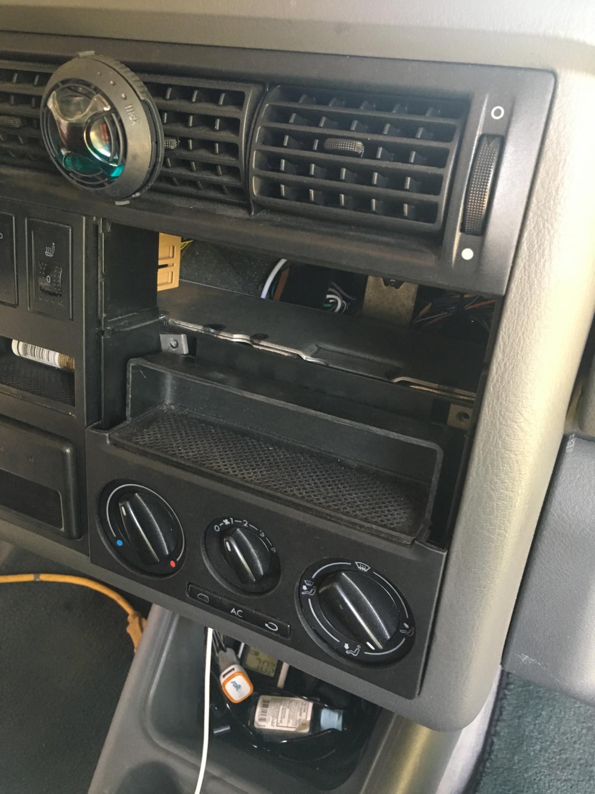

    2)Pull the facia off the HVAC controls (Its just snapped on, dont break it)
    3) Remove two screws holding the bottom shelf of the single DIN area and pull that piece out
    4) Assuming your factory radio has a plastic alignment peg on the back, remove it and mount it to the back of your SONY (I had to cut a 1" m4 screw , customize with whatever you've got laying around...)
    5)Wire up your Metra wiring adapter to your SONY harness
    6) Measure, mark and cut the HVAC trim panel; I used my harbor freight digital calipers.
    7) I drilled some holes at the top for the tabs of the 2-DIN trim ring to secure, these were pretty important for getting the trim ring to stay in place
    I also used a single DIN mounting cage that I put in backward. (sorry I forgot to take a picture). the cage helps hold the unit and I put it in backward so that I could get the head unit in flush with the dash, if you put it in correctly it would hold the head unit out about 3/8"
    8.) Mark and trim the Metra 2-DIN trim facia; I cut the ends of the top tabs off and trimmed the top side tabs, then wrapped a few layers of aluminum foil tape on each tab to make them a tighter fit. I also had to shave the inner lip of the sides because it was hitting on the radio unit (I used a dremel tool). All of this step is pretty custom, you might do it differently than I did but this may get you started in a direction.

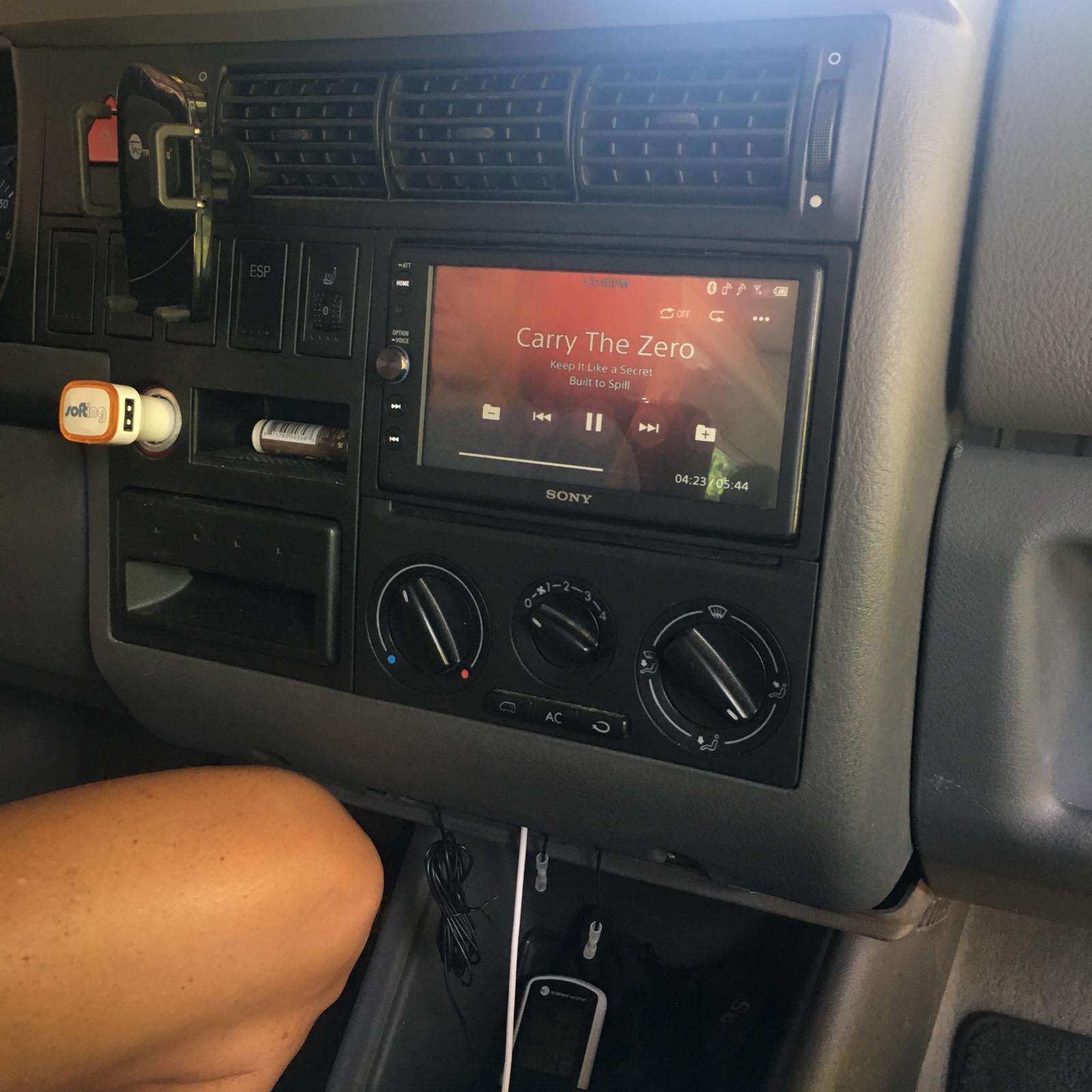

Put it all together:

Nice work, and nice post! Thanks for sharing the step-by-step. Smile
I also appreciate your sharing model-specific stereo components -- have been thinking about some similar kinds of upgrades, at some point down the road. Thank you!

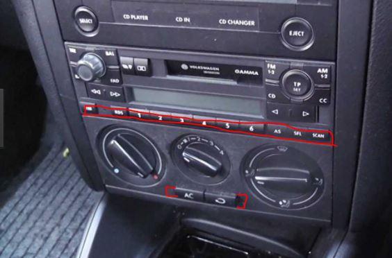

That Sony looks good -- the plastic around it is sort of matte and not glossy. How does it perform at night? I have problems with the glow of these screens distracting me when night driving.
Is there a trim plate you can find for the climate controls? The MK4 Golf/Jetta is very similar, might need a bit of cutting for the lower buttons - but it might give you a cleaner line beneath the stereo.

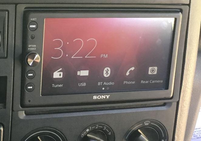

I've only used this once (day and night) so I have some learning to do but I can say the interface is intuitive, the unit responds well, and there are settings for brightness including auto dimming and an adjustable dim level.
I found on first use in AUTO DIM mode it was too bright at night so I used the settings to turn dimming ON which worked well at night but was then too dim during the day. So, I can say the the screen can perform well in the day and the night but have not yet got the settings to automatically control it well. I can see that it dims when I turn the headlights on as well but... I need more time to figure out the settings. It is also quick easy to turn OFF the display, and then it turns back ON when you touch the screen or a button.
The trim I used is matte and matches well, I just happened to have it in a box of leftovers so there was zero thought or effort on selection. I cant imaging anyone looking this close but here's a close up for interest sake:

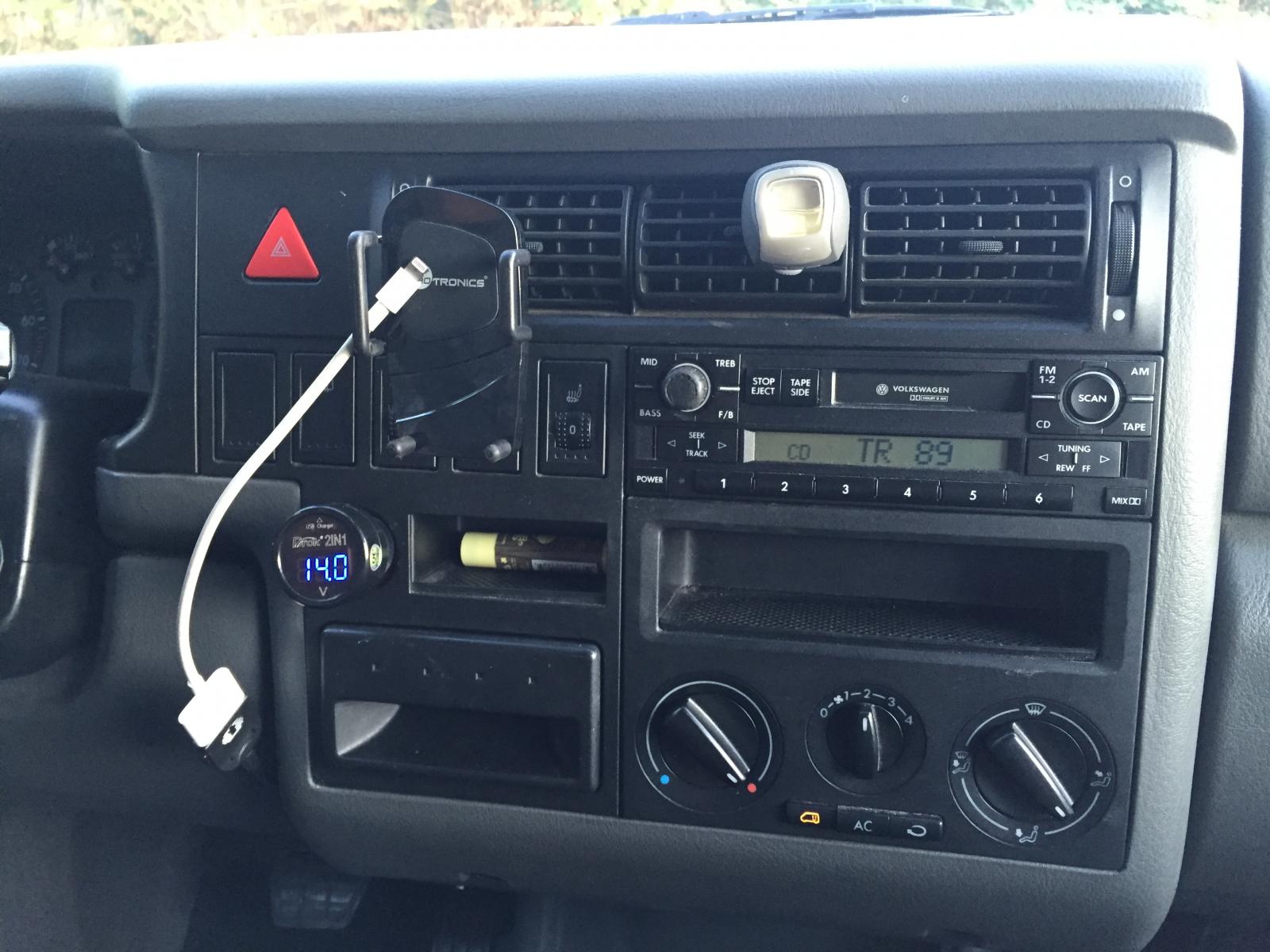

For comparison, here's what I had before (I think the sony is an improvement):
Regarding the area below the unit using the original trim, the results exceed my expectations considering how hack this installation was and none of the parts being designed for it although as the first to document installing this sony in the EV MV Weekender, I expect someone else might come up with additional tips and tricks. And, there is no visible gap with mine, you see the edge of the rubber matt but you don't actually see through or into the dash. I suspect that any guest in my van would never even notice this "aspect". And I think the alternate trim piece that I linked to on amazon is a few millimeters taller which might reduce this effect as well. It looks like the MK4 trim would be too short leaving a considerable gap, and cleanly cutting out the holes for the buttons could present a challenge (comparison areas show below in red).
MK4 HVAC:

Your installation looks a lot better than mine. I used a generic trim ring that I had to grind down to fit, so the gaps are wavy and not professional at all. I also trimmed the lower panel down lower than yours, so when I do eventually buy a better trim ring, I'll need more material down there. Mine sits out a little more, which I assume is because I used a single DIN bracket to center the HU in place.
So far we're loving the features and functionality, though Siri seems to be a little hard of hearing and I often have to shout at her in order for her to wake up. We were heading back from Whidbey last week and needed to fuel up on Fidalgo, so I asked her for the nearest gas station, and she guided me there completely by voice commands as well as a map on the screen. I can't seem to get Pandora to load up for some reason. I really would like to find a traffic congestion app like Inrix that will work in Carplay. My wife had to use her phone to guide us away from the worst of Friday afternoon Seattle area traffic, but having that info on the big screen would've been more helpful.
I turned the single din cage around; this way I could insert the HU further into the dash and the cage still helped hold it centered in the opening
