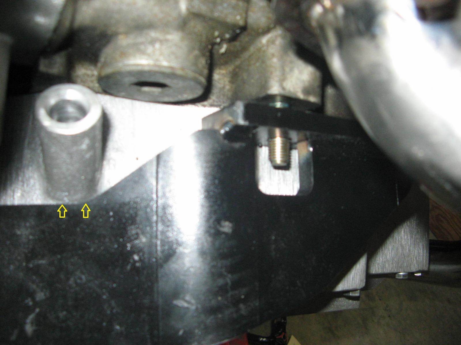

If you use the Smallcar bellhousing, to drain the gear oil properly you have to grind a 1/2 inch spillway.
Otherwise it retains the dirtiest part of the old oil --- to contaminate your fresh gear oil. This gets more important because a big engine + old trans makes more metal in your gear oil, so you have to change it more often. But for your old oil to contaminate your fresh new oil is a flaw - for sure.
Here's a pic showing it with the RJES bellhousing.
It's really easy to grind that spillway and solve that flaw. Smallcar could do before shipping it out, but it's been ~8 years now and they don't feel it's necessary I guess. Like another guy mentions, when you put in a bellhousing you have new gear oil and nobody thinks of changing oil. They just wanna see how that new engine drives. But this little flaw adds doom and gloom to a very expensive part of your van (the trans). And then you have to find someone who's competent to rebuild it, and there are't all that many rebuilders. For most of the country, you'll have to ship it somewhere to get it done such that it will last.
Also with the Smallcar bellhousing the clutch action is a little more "abrupt". The feather/slip portion of the pedal action is shorter and occurs high up near the top of the pedal travel. Some folks have solved this by modifying the Vanagon clutch pedal. I will do that to mine someday. Here's some discussion on it https://www.thesamba.com/vw/forum/viewtopic.php?p=8285282#8285282
Otherwise it retains the dirtiest part of the old oil --- to contaminate your fresh gear oil. This gets more important because a big + old trans makes more metal in your gear oil, so you have to change it more often. But for your old oil to contaminate your fresh new oil is a flaw - for sure.
It's really easy to grind that spillway and solve that flaw. Smallcar could do before shipping it out, but it's been ~8 years now and they don't feel it's necessary I guess. Like another guy mentions, when you put in a bellhousing you have new gear oil and nobody thinks of changing oil. They just wanna see how that new drives. But this little flaw adds doom and gloom to a very expensive part of your van (the trans). And then you have to find someone who's competent to rebuild it, and there are't all that many rebuilders. For most of the country, you'll have to ship it somewhere to get it done such that it will last.
Also with the Smallcar bellhousing the clutch action is a little more "abrupt". The feather/slip portion of the pedal action is shorter and occurs high up near the top of the pedal travel. Some folks have solved this by modifying the clutch pedal. I will do that to mine someday. Here's some discussion on it https://www./vw/forum/viewtopic.php?p=8285282#8285282

I enjoy fabricating, so the somewhat lower quality control of the SmallCar parts did not really bother me. To try to answer most of your questions and to impart what I have learned over 6 years, here are my comments:
1. My conversion is an SVX engine, so using an adapter plate was not acceptable to me, given the greater leverage that the longer flat-6 causes on adaptor plates.
2. As SODO mentions above, do grind the transaxle drain area. I fiddle with a rag and wire rods to clean out gunk at gear oil change time because I did not do this. Crying or Very sad
3. Buy your clutch release slave/bearing unit from SmallCar. Note the part number and next time, go to the dealer or elsewhere. They do get the highest quality unit out of a spectrum of parts makers with, ahem, "variable" quality.
4. Be VERY careful not to over-extend the clutch slave. The SmallCar instructions do a frankly crappy job of explaining this and of explaining the need for the plastic ring (about 1/2" thick, and about 3/4" diameter) that comes in their "kit". It is meant to be installed on the clutch master cylinder actuator rod to limit the stroke of the clutch pedal. It's a bad solution to a real problem. Over-extending the clutch travel causes two SERIOUS problems: a. The slave cylinder is damaged by over-extending travel beyond the designed stroke. It will not fail, however, until the most exceedingly inconvenient time. b. It damages the pressure plate as its diaphragm spring is not designed to bend to the point that the SC clutch setup will permit. So there goes another $300, if you do not heed this warning.
5. In my case, I determined exactly where, in the travel of the clutch pedal, the point of release occurred. I then added about 1/4" and installed a piece of metal that stops the clutch pedal from traveling any further. This is also not the best solution, since the clutch pedal travel is very limited and for strangers driving my rig, the clutch feels like an on/off switch. Of course, I am used to it now.
6. The best solution is one that re-locates the hole in the clutch pedal to which the clevis is attached. This results in the clutch pedal moving further for the same amount of movement of the piston in the clutch master cylinder. There was a fellow modifying clutch pedals on an exchange basis, but I think he stopped doing this. There is a thread that shows how to do this mod.
7. SmallCar uses a custom clutch disk and a custom pressure plate. With enough research, you might find exactly where they sourced both and find a better price. But I strongly suggest that you skip that small savings exercise and bite the clutch bullet. I knew that their disk was a custom unit, so I bought 2, keeping one in my in-vehicle parts bin. This is cheap insurance against a ruined vacation. I also keep a spare clutch slave in the van.
8. The first iteration of SC stainless headers were crap. Mine cracked like Sodo's did. But I just MIG welded the cracks from time to time. This past spring, I finally replaced the old header with their new design unit, made from a better grade of stainless steel and in a thicker gauge. So far, so good. I have not yet heard of anyone whose new-generation SC header has failed.
9. There is no magic in SC rubber engine mounts. Van Cafe, Bus Depot or GoWesty units will be fine.
10. The passenger-side motor-mount "bar" in the SC mount will need to be notched to clear the dipstick spigot on the SC cast aluminum oil pan. See the pic below:
11. I like the fact that I use a stock Subaru flywheel, and stock Subaru starter. Don't buy a re-built starter - - it will fail. Go to a wrecker yard and buy a used factory-original unit. It will last.
12. Don't forget to use the correct-length and grade flywheels bolts - - SC sells them. The automatic trans flex-plate bolts are not long enough.
13. SC sells most Subaru parts at less than the "bricks and mortar" dealer price, but slightly more than online dealer sellers.
14. SC does not sell the Subaru parts needed to fill in the gap between the lower part of the engine and trans. Here is the part number:
