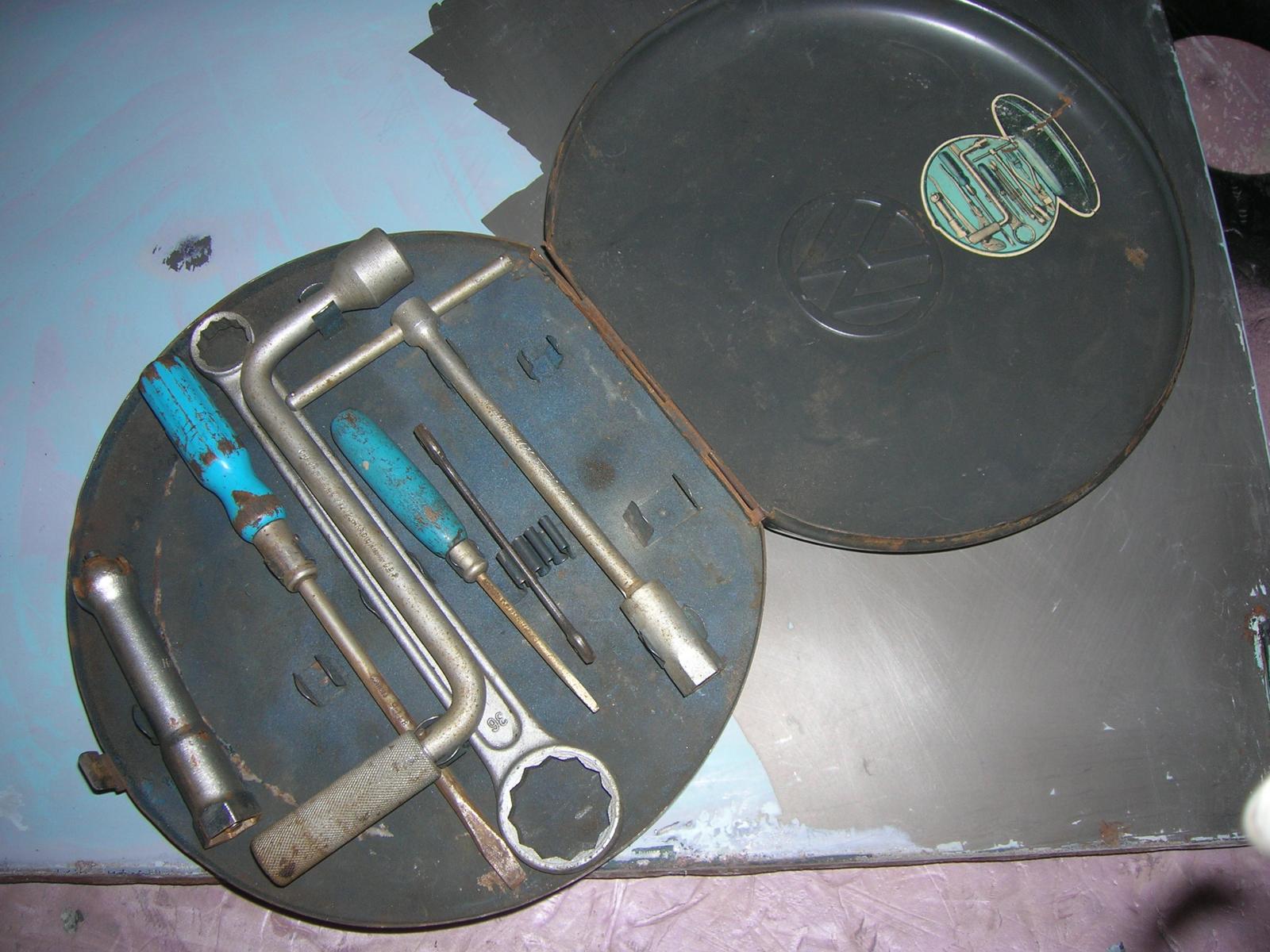

PostPosted: Tue Nov 07, 2017 3:55 am    Post subject: Re: Mid 50's tool kit - correct wrenches Reply with quote
Here it is;
Dan

PostPosted: Tue Nov 14, 2017 11:10 am    Post subject: Re: Mid 50's tool kit - correct wrenches Reply with quote
Since you have flock (not felt)... it's 56-59 style.
I think you'd want the rectangular depression in the wrenches.
... and "a" with plain underline... not "a" with "L" underline (which is earlier).
