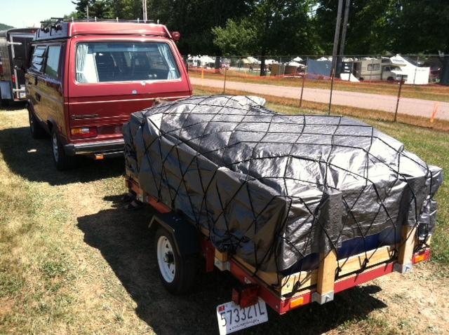

I tow this every summer for 250 miles each way to go camping. More than 1000 lbs with our yurt and supplies. No elec brakes. Very conservative on down grades due to no elec brakes.
