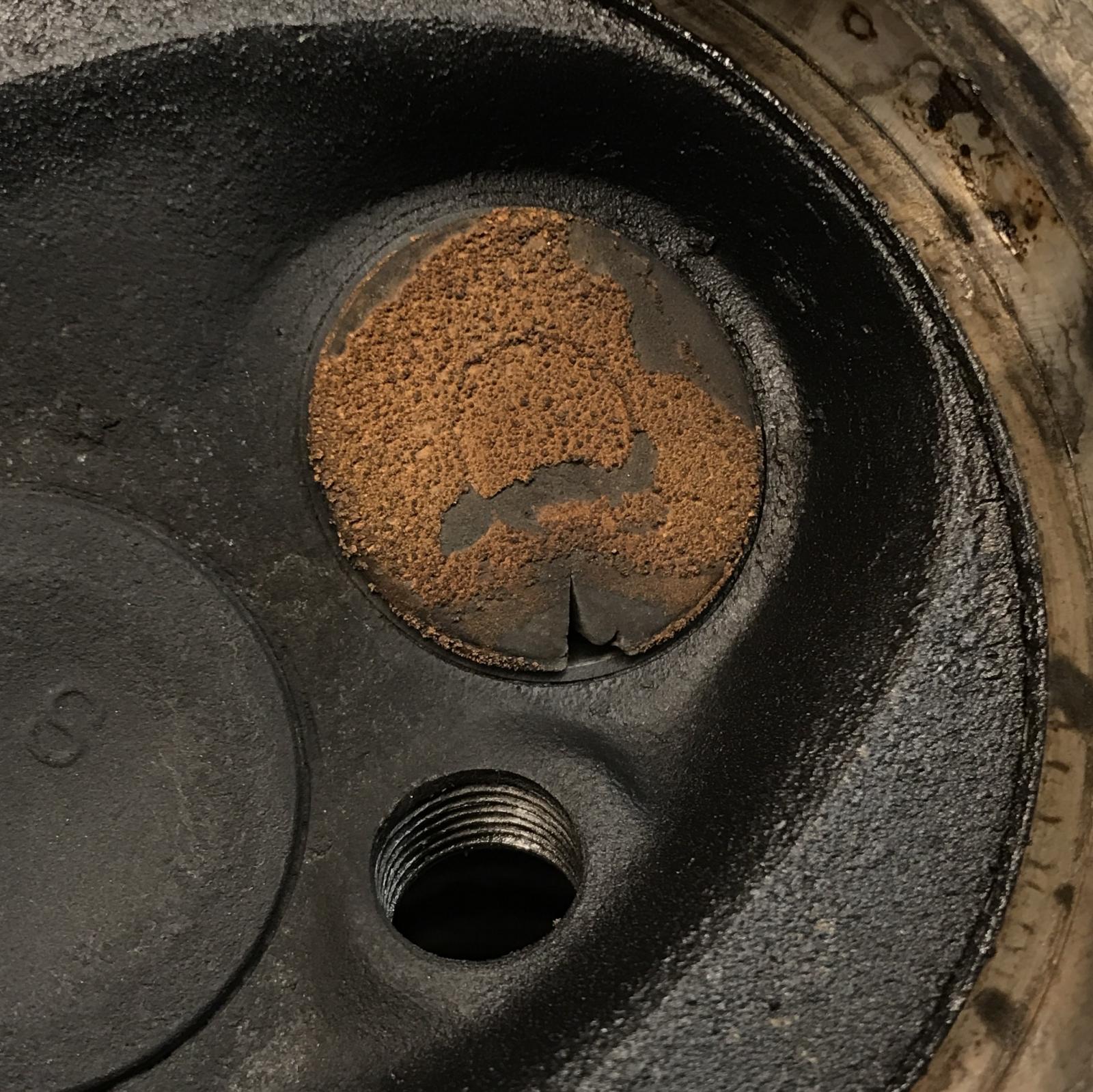

compression and leak down tests reveal an exhaust valve leak on #4. so i'm guessing either stuck - which would be nice - or burnt and not sealing due to overheating.

PostPosted: Sun Oct 15, 2017 12:31 pm    Post subject: Re: dual carb issues, Solex 32 PDSIT 2/3 Reply with quote
well, got the engine out and heads off, this explains the total lack of compression in nr4 :
