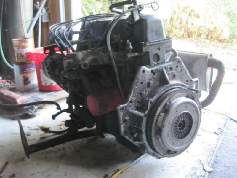

PostPosted: Wed Mar 06, 2013 12:59 am    Post subject: Reply with quote
Here is the adapter plate and accessories. This uses the stock type IV flywheel, clutch and pressure plate. The disc in the top right of the first picture shows a plate with a needle bearing in it (needs to be replaced). The flywheel bolts to it. It bolts to the smaller diameter disc, which bolts to the new engine.
