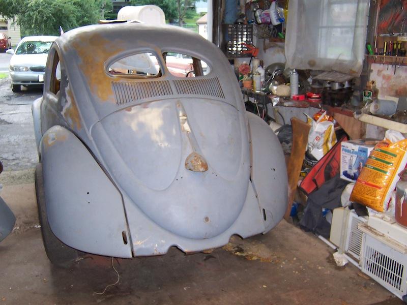

Hello I acquired this car and the plate in the front is not rusted really but the area with the chassis number stamped in is very hard to read the VIN tag. Has anyone got any tricks for bringing out the stamped-in numbers?
Update:
Gentlemen!! I give you 1-0422383!! Originally L90 Sand, now disco gold and primer!
Thanks very much to all who helped! The numbers were clean and crisp on the back of the plate and I can even reuse the old rivets! Very Happy

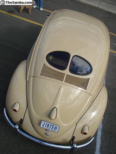

AlanInMass54 wrote:
Yessir it is! I sent off to VW for the birth certificate yesterday. If it were any other original color than beige I'd be happy though, I hate that color.
Dude,
You need an attitude adjustment/reorientation.
http://www.thesamba.com/vw/forum/viewtopic.php?t=504264&highlight=beige
check out the second photo in the thread of the ragtop. I think the late splits/early ovals with the reversed two toned (dark inner) rims look sweet.
Go ahead tell me this isn't one beautiful beige split. But to each his/her own - maybe you'll get lucky and the BC will come back with some other colot.
