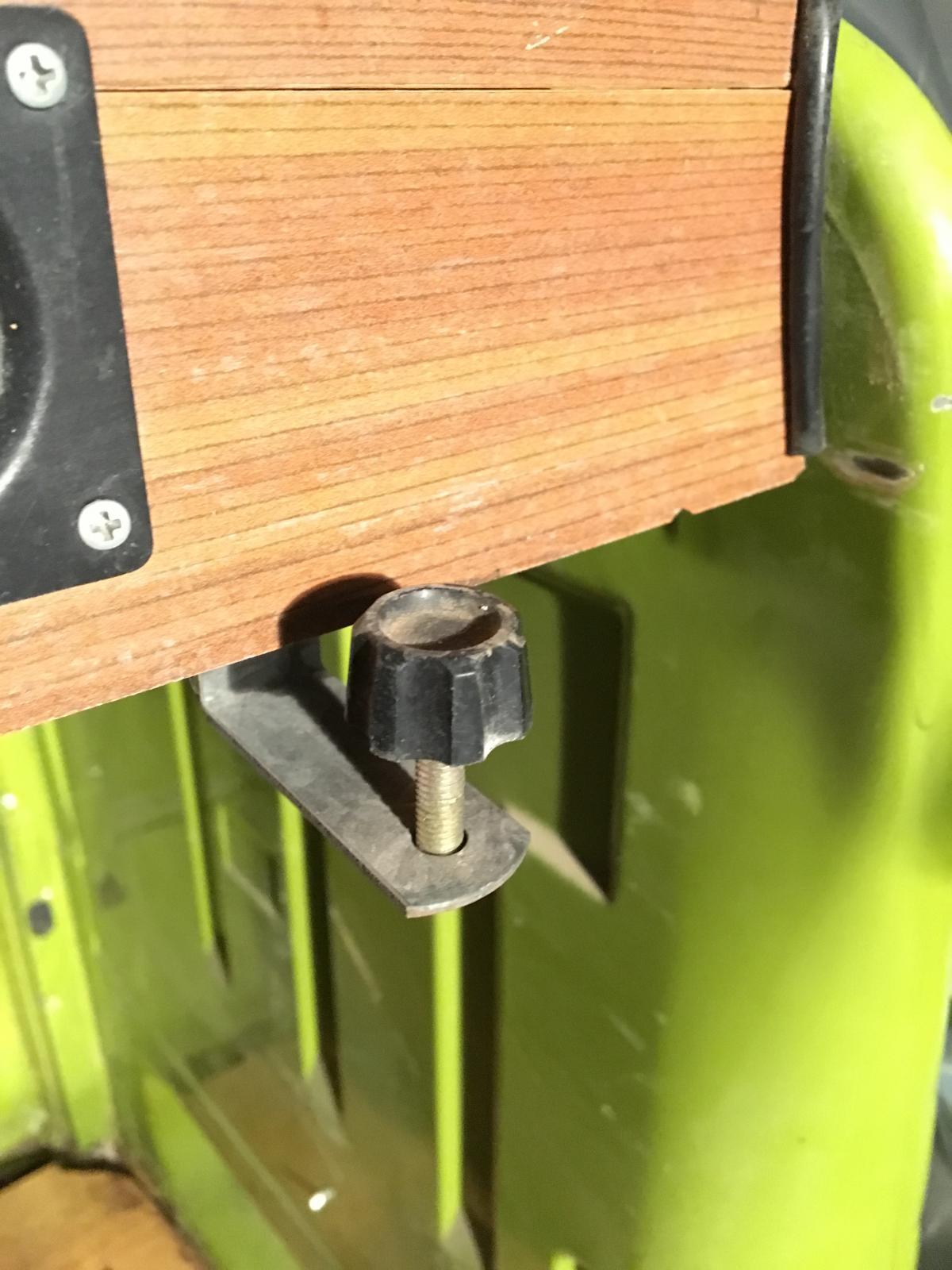

In regards to the Transaxle clean up, I thought it fitting to get the starter and solenoid cleaned up and inspected. It looks solid and usable, albeit a little crusty, but I decide it really doesn't need paint or anything and get it put back onto the trans so I can keep track of it and its hardware better.
I'm thinking a change up from the rear of the bus projects to the interior, which I seem to find more enjoyable. I've said it before, I will pay some dues doing a tougher service then break it up with an easier one. I had some success with some of my Westy Berlin interior refresh in the bed, wardrobe and headbanger. I'm glad I was able to make some ground there and what I learned will surly help me in the two pieces to come. The refrigerator and kitchen block are looming and they look complicated. They need a lot of attention and I could take a stab at them by simply working the drawers and doors of the kitchen block and take it on in little bites.
This helped a lot, as I got an understanding of what the plywood is made of. Looks like layers of wood with a very thin veneer of a more attractive wood. The laminate was reattached in the usual manner, either getting the edges glued back down or removing and re-gluing the entire sheet.
Some of the edges of the wood are chipped off and I take the time to get them stabilized and filled in. I use my paint trick here again but with the proper colors. I think this will pass a quick inspection.
Its not often I can get my kids involved at this point and I was overjoyed that my daughter wanted to help seal them. We opened the doors and left that room it stunk up the place for an hour or so.
Encouraged by that little jump forward, I decided to get some pictures and a grip on whats holding down the equipment on the bus. I would think the refrigerator and stove are a Deluxe thing but I don't know what to call it. There is nothing else on the bus that indicates a Deluxe status, so maybe just a package upgrade over an ice box and sink. Looking at it all, I'm thinking the ice box and sink might be preferable as all my gear looks like it will need the thorough workover.
Check it out! More dirt, but I can't really accept this area being so bad and decide its early enough in the night to get some tools out. I get in there and unscrew the hinges to the refrigerator lids and unplug the control module. I gotta say, I always get nervous unscrewing anything on this bus worried I'll wreck it. Lots of pictures are taken and help a lot when things go back on. The kitchen block is really hooked to the bus and I realize I can unbolt the refrigerator and pull it straight up and out. From my lap I gently set it down off me on the cargo floor. This is when it happened........

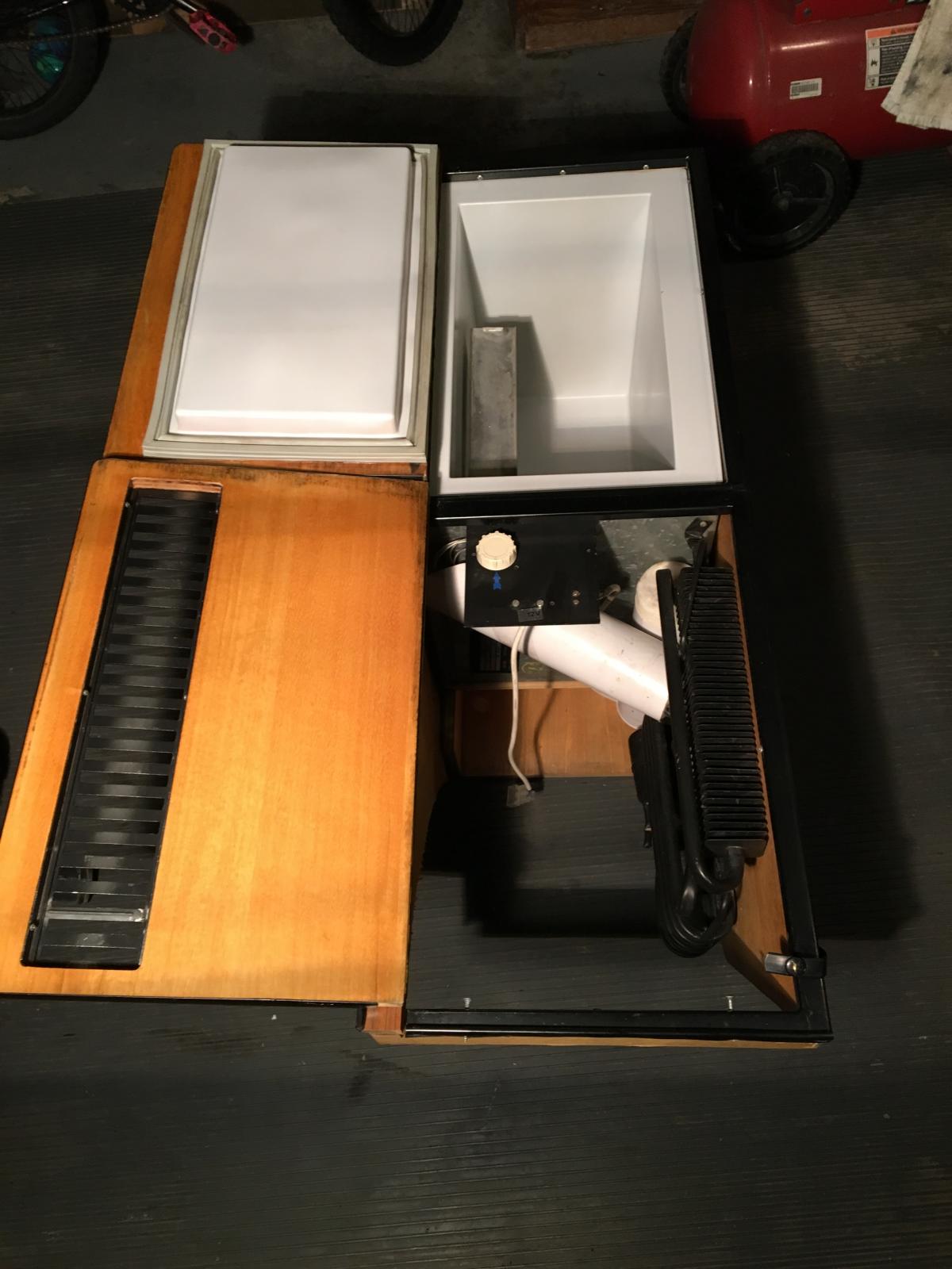

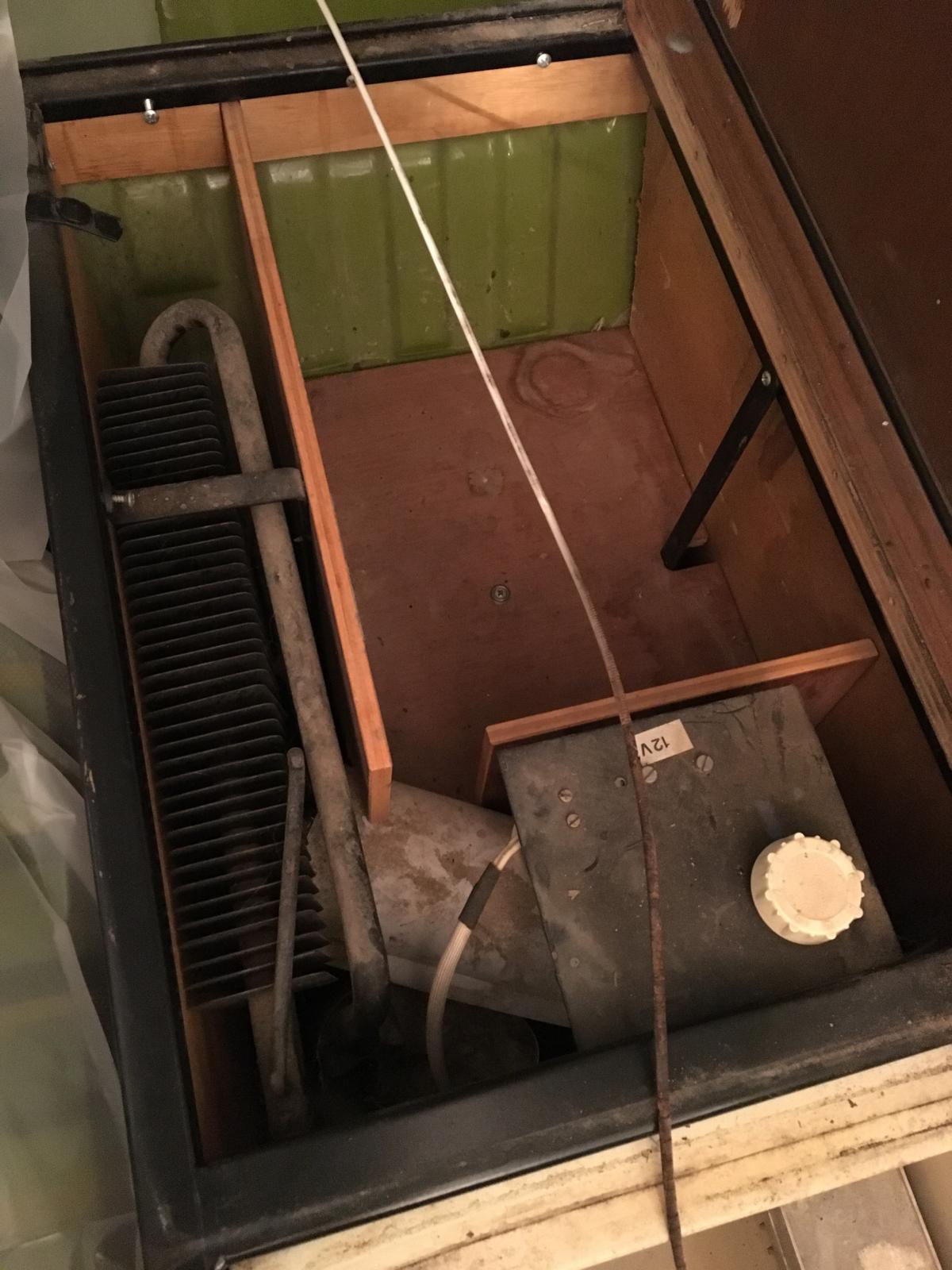

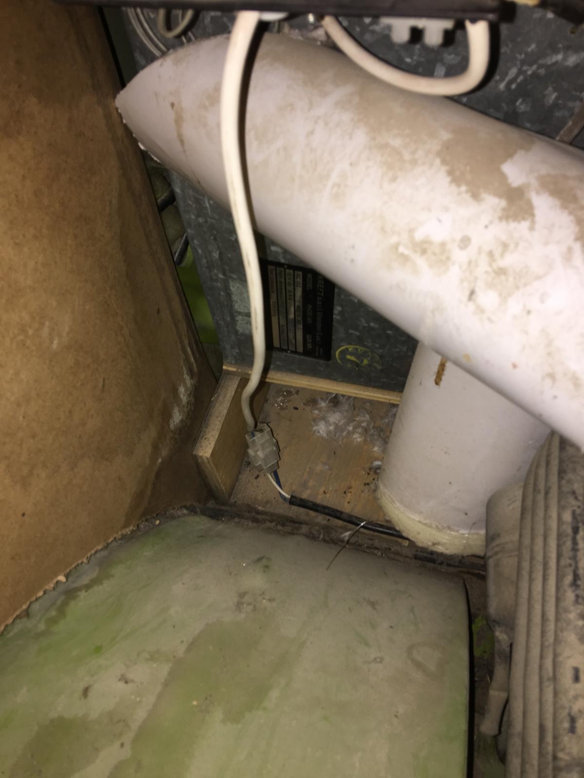

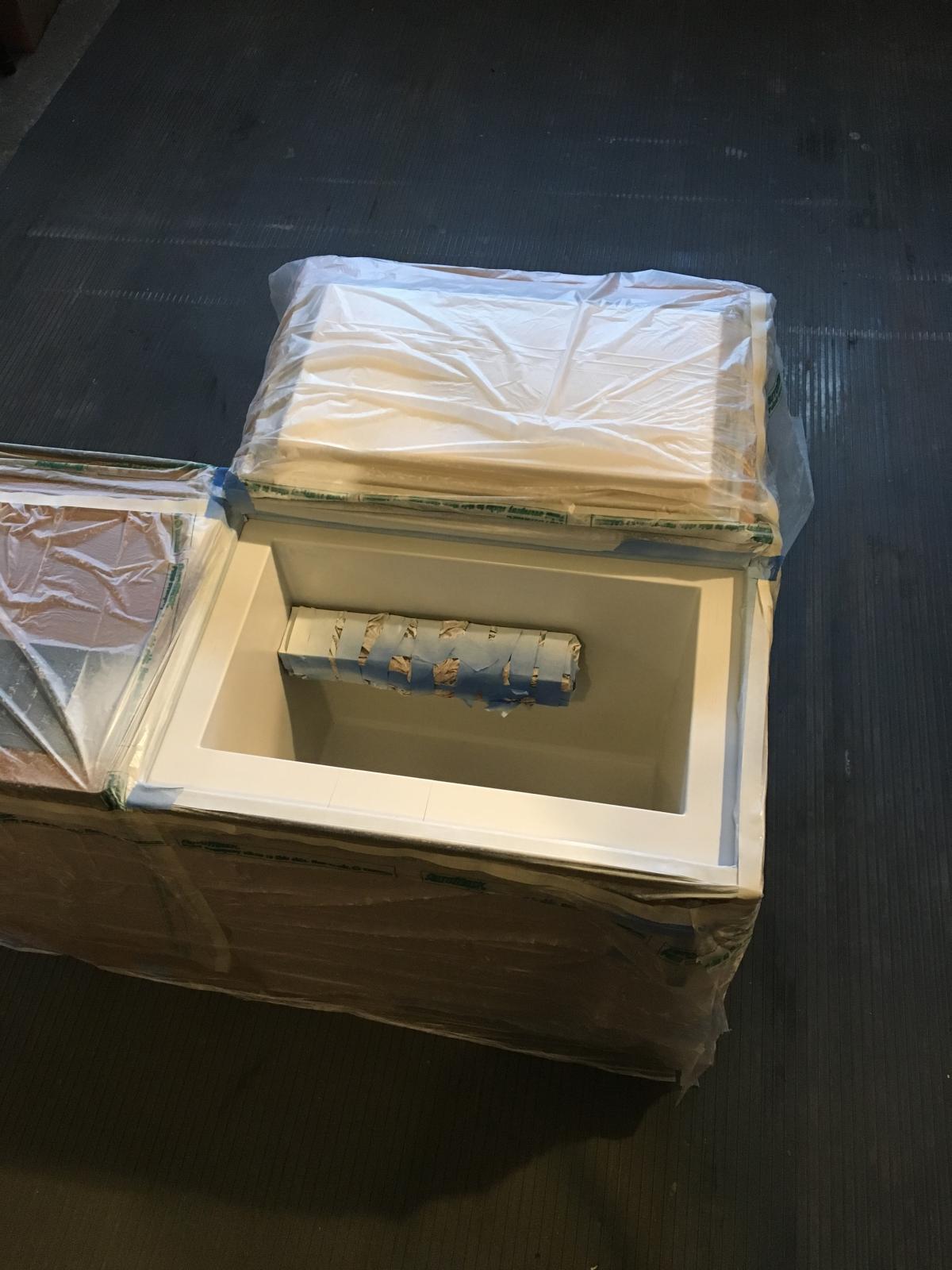

I just can't wait to get this piece cleaned up and familiar with its construction and it's operation. Its been a mouse hotel and I vacuum it out and wash with light bleach water first. Disassembly real helps get into the crevices.
Its cleaning up pretty well.
I send a few pictures to my close friend Troy who is a master Heating and Cooling/Plumber if he can tell me anything about the unit. His response was that it's run on heat and ammonia. There should be a heater that will vaporize the ammonia into a gas that is cold and when it warms up it will return as a liquid to be circulated again. I mentioned that I read on here that the tubes can crystalize and need to be recharged or flipped over to get it to start working. His thoughts were that unless there was a leak someplace there no way the ammonia would crystalize. He also mentioned that anytime ammonia is used the plumbing is usually overbuilt so a leak won't likely happen and if it sounds liquid when I flip it, its likely to work unless my heater is faulty. He said to make a lead that goes to the plug and hook it to my car battery and test it.
Heater welded to lowest part of tubing.

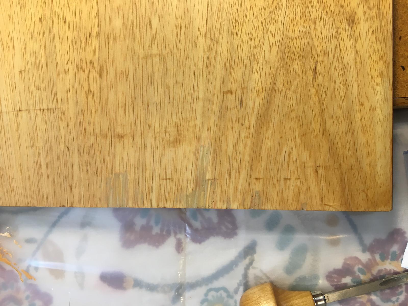

Moving along, it looks like there is going to be some reattaching of the laminate. The piece on the face is large and mostly attached so the plan is to focus on just the sprung edges.
Not too bad. Just takes some time and patience waiting for the glue to dry. I jump on one of the lids. The one to the fridge box. Some crusty glue from a former attempt to reattach but that gets chipped and sanded. I like to use real original laminate whenever possible, even if it has a small blemish or crack. Thankfully, by now I've learned the iron trick for removal. This one just made since to reattach the entire piece to get all the old glue out from underneath.
The insulated lid isn't looking very appetizing. There is mold all over the seal, but not knowing where to get a new one, I carefully remove it's staples and clean it in the sink with some light Comit and its looking decent. The aged out plastic lid has really yellowed and I'm not sure what to do there, but I leave that for now.
This control module gets set aside and and saved for later, it's going to need fresh uninterrupted attention at some point down the line.
This original heater insulation looks savable and it wipes down. I trim off the burnt part.
By now I have my lead ready to test the unit. I get my starting battery in the house next to it and plug in the wire lead. The heater gets hot instantly and the dial seems to adjust the load. After about 20 min the metal and fins inside the icebox are markedly coolr. I can't believe my luck and Troy is stoked too, because he would have been the one servicing or adding a new heater if it needed it.
More to go on the refrigerator lids and whatnot, but its looking like a refreshed unit is within my sights so I keep poking around on my kitchen block. Some of the things attaching it to the bus don't want to budge. I take some time reading up but its a lot easier to get around now that its sitting there all by itself.

Hi!
Just a word as you're working on the refridgerator.
You may consider to install a voltage cut-off switch, which will cut the connection to the battery below a certain voltage.
Otherwise if the fridge is powered by the battery only it would probably drain the battery to death, if you forget to switch it off in time.

Looking at my refrigerator storage compartment lid. Its got some notable damage. First, it looks to have a white film apparently sun damage and a vent rib has been cut out where a cigarette lighter was mounted by a PO. At first I thought about keeping the adapter as it would be nice to have, but decided it looked like a hack and decided to repair as best I could.
Funny thing here is I found this chip of laminate underneath a gap of laminate on the fridge side when I removed that piece. Saving it, I realized it went to this sides corner.
I used some turtle way on the laminate with my finger and it polished out the sun damage on the laminate nicely.

With the Refrigerator piece still in my life I had to press on and drag it over the finish line.
I had already painted it before I saw what notchboy shared, but now I would have liked to have tried it here. Oh well. I've got some yellowed plastic ahead to go. It still didn't turn out bad. This guy Al I work with at ABS (Auto Body Supply) said there are all kinds of plastic paints in spray cans ready to go and that the paint dries flexible. He said that if the piece was old all the better as its likely done gassing out. I think 1977 counts as old here. Just that I needed to wash the piece with water and Comet and that would give it the perfect tooth.
I remembered to put down some tape so I would know where it registered when putting it back on so it would close right.
The insulated plastic cover came off the lid with a little tedious wiggling of needle nose players. The staples penetrate both the lid and the gasket, so with that out I can get it even cleaner.
I have Comet at the shop and a large sink to wash it in so I decided to wash it there as my garage was freezing cold and I didn't want to fire up the heater just to spray this piece. The paint goes on really thin. Its transparent and allows you to build up as slowly as you want. I get it done without getting yelled at by the guys as we have some strong exhaust fans in the clean room.
The problem is that when I get it back home and put it on its pretty white compared to the inside of the main liner.
I get that clean and tape it all off and get some paint into that too. Just a little thin dusting here. Just enough for it to match the lid.
I guess its pretty much done for now. It really only needed to be wiped down, tested, a vent repair, a little laminating and a light paint job, then reassembled. Easier than I thought it would be when I first got started. The shelves that go inside need some attention, but I left that out for now as they will go in last after I bolt the unit into the bus.
With my new wall panels in hand, I'm thinking if those were in I could get my fridge, headbanger and wardrobe off the floor and back in the bus. I'd like to have the wardrobe in to see where I should align the long panel that fits between it and the drivers seat. But first the kitchen bloc has to come out.
There are several threads on here on how to remove this from the bus, so I won't post or outline what I took pictures of getting it un attached. I did take plenty of photos though so would be able to use as a ref when installing. Most noteworthy though was the discovery of my spare tire cover bolt. It was down behind the driver seat bulkhead under the floor of the kitchen block. Safe all those years. I'm pleasantly surprised as I see BD sells one for $15.00 and isn't quite the exact molding. Call me crazy, but I like this kind of thing being right and I'm happy to have the original piece here.
So out it comes. My folks live sort of close, a few miles from me so my Dad stops over to help maneuver the hulk out of the bus with me. Pretty cool to see the original insulation under it all and not looking that bad.
That was a bit of doing, so its just gonna sit on a table for a night or two.
