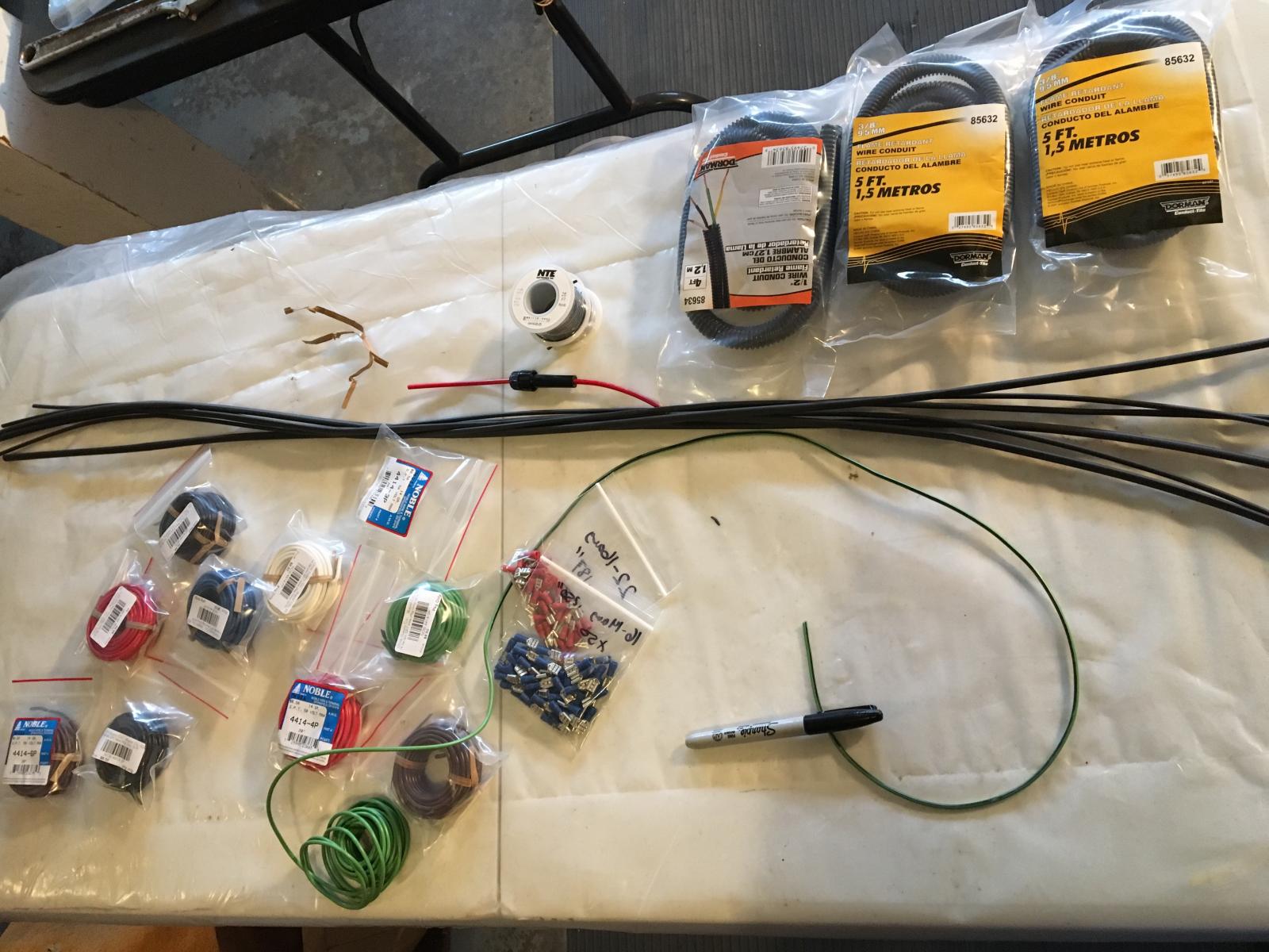

The tail light lenses were rather rotted from age and all powdery on the edges so I ordered new ones, and soon after that ordered the housing as well as the wire cover plates and picked up new bulbs at the local parts store. Getting it out isn't hard and I transfer one wire at a time figuring it is the easiest way to get it right.
But this won't do. These wires are pretty beat up. There was a trailer lighting harness that had some kind of press fit clips that jumped onto the wires and left holes in the insulation. I don't like that and figure I should get the wiring back there replaced and cleaned up. This is where the Bently manual really helped. It took me some hours and a few different reading sessions to start comprehending how to follow the diagrams, but this ended up being a great project to get up to speed on. My bus's wiring harness is intact just to about the passenger side light and the diagram shows it to run across the engine bay and dead end at the drivers side light as well as making a brief fork at the plate light and reverse indicator wire. Cool, I can handle this.
With the light out I see I missed some coverage on the battery tray and I treat what I missed and get it scuffed and painted.
There is an electric specific shop in town and I get a load of supplies to add to the stock I already have. Wire in several colors, gauges and lots of heat shrink. I want to get this wire bomb proof as I don't feel like getting pulled over for a missing tail light bulb and seeing how dirty an engine bay can get, I want it to have the best chance at survival as possible.
I told Brian I soldered all the connections and he laughed, said there isn't one soldered wiring connection on the whole bus. Said he's not a fan because he sees guys run too much solder in the connections and melt up stuff bad, but thought it OK with me because he knows I mastered soldering as a Tattooer. You see, I've been tattooing from a time when pins came in loose packs of 1000 and you had to solder your own groups together with silver bearing solder and flux, so the solder wouldn't melt in the steam sterilizer. Who knows how many hours I've sat soldering, I did them all for a 4 man shop for 4 years straight before. Flux core solder is a breeze. I also wired my bike with soldered connections, but I wired the bike too tight and when I had a break I couldn't pull wire from anywhere to fix it without unclipping a bunch free from the frame. I won't make that mistake here and put nice curves of flowing wire that can breath a bit.
Reading the wiring diagram made me want to get the wire to match. If it's covered in wire sheathing I wanted to know what is what down stream. I made all the wires match with the corresponding colors as best I could with markers and several finger nail polishes.
I get all my leads figured out and run to the passenger side and side marker.
About this time I remember getting sick. I had a cold with a pretty bad runny nose and cough, two things you can't hide tattooing, so I stayed home a few days. I was so bored I couldn't help myself and went out and worked in the bay to finish up the wiring. I suppose I should have just sat and rested but I figured I couldn't hurt anyone alone in my garage.
It got messy and then it all wrapped up and was done. All the ground connections get sanded too. I left a long coil of wire for the reverse indicator and they all test out. Cool. That wouldn't have been as easy with the engine in place.

The one downside with soldering is that it makes the wiring at the joint more fragile and subject to vibration failure. As soldering is a chemical process where one metal dissolves in another, the process of soldering a wire makes the wire thinner. Combine that with the tendency of solder to wick up stranded wire and, because the soldered part of the wire is stiff, you create a weak spot at the point where the solder ends and where the wire has less physical support. Vibration from vehicle operation can cause the wire to fatigue and break at that weak spot.
Now it's not like all of your soldered connections will quickly fail. Just keep an eye on them, and try to restrain them from flexing as much as possible.
Right on, it may play out to be a mistake, Iíll keep an eye on it.
Thatís what I like about this project and checking in here, I learn stuff every day. Thanks.

I went with the Bus Depot ďGermanĒ set. Fit fine to the bus.
The only thing I remember was I needed to split one spade with a thin cut off wheel and use two smaller connectors to get a wire to the side marker.

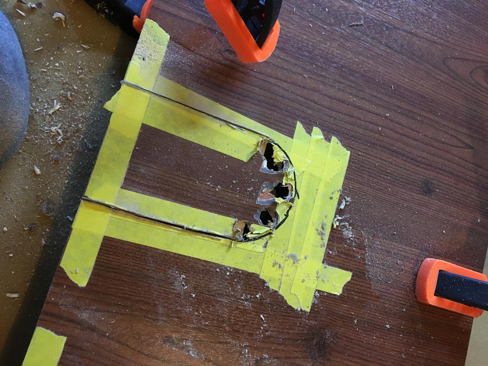

Back to my favorite part, the cabin interior. At this point it seems a little silly to be stoked to have the panel set and not get a few of them fitted. It's easy for me to pick up the phone or place an order online quick for parts and have them stack up and not lift a finger to install one. I like to have parts and supply on hand, but don't like the feeling of having a big a pile knowing its takes time to install each one.
I want to get the long wall panel set but think having the wardrobe in would be important to decide where the final set is as one end will be touching it. Before the wardrobe goes in I want to set the small hatch strip that goes behind it just in case it somehow influences how the wardrobe settles.
My parents gave me a present of a quality heat gun. I mentioned once it wasn't a tool I'd likely buy my frugal self, but knew I would break it out a ton if I had one. Putting on the thin wall strip was the first thing I got to use it on.
The panels are basically a reproduction laminate on a 3-5 mm plywood and pretty stiff. The edges are white/blondish and stand out so I get some stain on the edges to take off some of the whitish focal point. I realize I need to sand the edge free of glue to get the stain to soak in evenly. It's a small added step but now is the time to do it if your gonna. There are no screw holes predrilled but I have an old take off as a pattern to transfer the holes from. I don't want to crack the piece installing and I'm thinking leaving a wet rag on the back would help soften the area that gets drawn in. After about 20-30 mins of that I get Cat's attention to help hold the heat on the piece and with a little slow, even pressure the strip panel settles right in.
For those that haven't worked with these repros, they are a nearly indistinguishable wood pattern from the OG pieces, right down to the very tiniest textures, But there are absolutely zero holes or internal features drilled. This adds some difficulty if you don't have patterns to work with, thankful I do, but the new long wall piece is in two parts and my original is one longer panel. I'm not going to let this frustrate me.
I started with the rear piece and then brought in my wardrobe. This made the one end known and I was able to slip the two pieces into the top galvanized lip and decide what to do with the little bit of play I had at the drivers side bulk head.

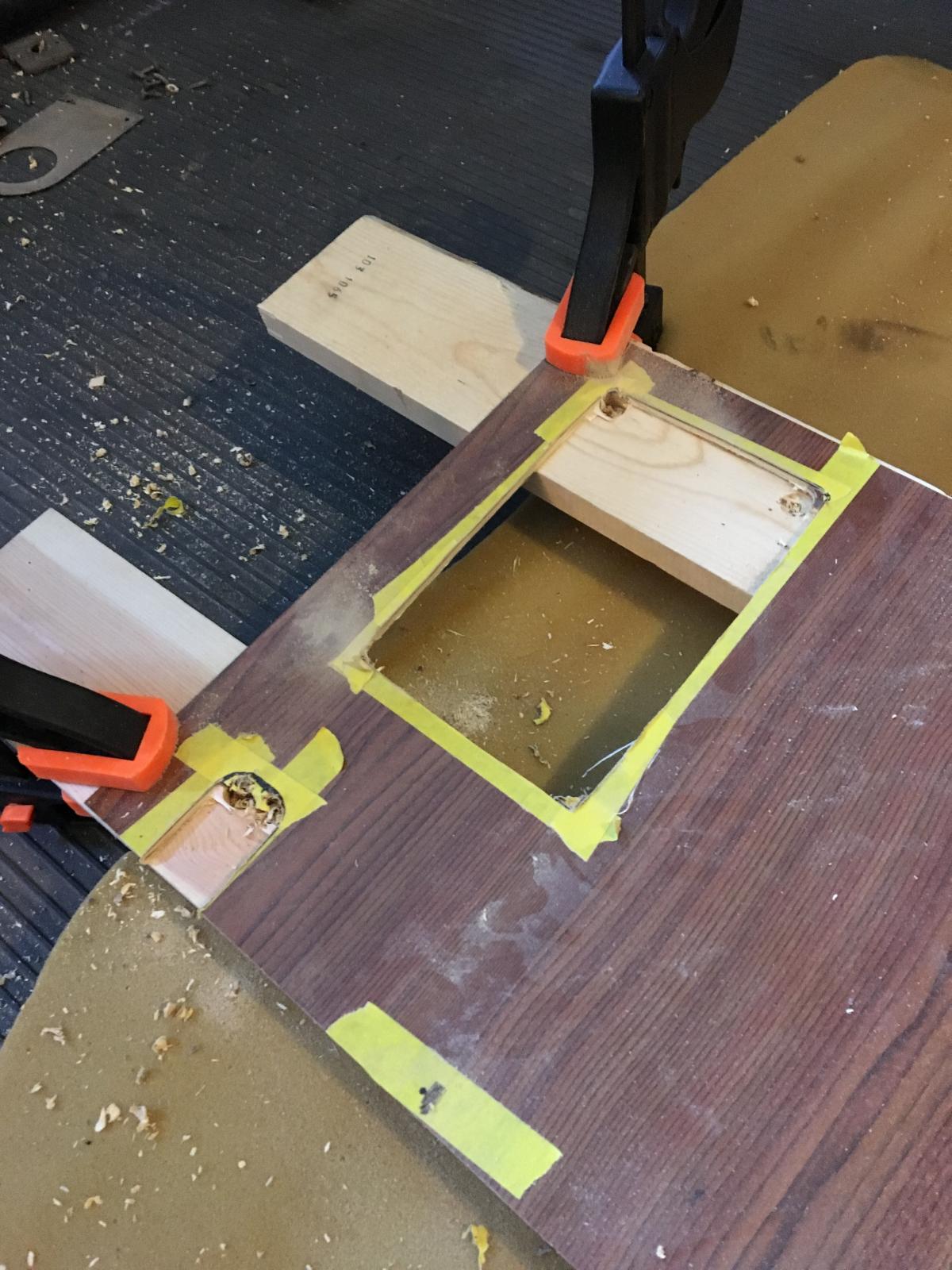

Once I felt confident I had it in the best possible place, I marked them in places and brought them inside to lay on my older OG panel to find where to cut and drill holes. These next few pictures really show how bad my old OG piece looked and what the PO did with the stain painted over the silkscreened wood grain pattern.
I get them all clamped together, and get a solid look at where to trace out the holes for the control module and the sink vent. I discuss it with my lil bud Clover and we decide were gonna delete the ashtray by the window. We won't be smoking in the bus and think it will clean up the area some and it can always be added.
Back out in the garage to drill some holes and run a jigsaw in and around the marked off areas. A final clean up with some files by hand. I get a little crack around the control module and have to put on a repair of my new panel,,,,Ha! nothing like getting new parts in the mail and drilling holes in them so they fit, sounds about right, but I'm grateful to have this material to get me started. I'm sure they're blank so they fit all models or you can decide what stays or goes.
Still, I didn't feel comfortable drilling the screw holes this way. They're such a small target and many to get right as they play off each other. I don't know what else to do, so I run the screws in the holes in the body and slip the panels in the top rail over them. I gently pull them away and get a dab of nail polish in the heads and press the panels back down to get a print. This tells me exactly where I need to drill. I've never had good results tape measuring this kind of thing and always need a practical solution. The holes get drilled and counter sunk. The panels get set and the screws align perfectly.
Just for a trial mock up I get the control panel back in and bring the refrigerator into the equation. Now were getting somewhere. I was chatting with Kev on the phone and said I just set the long wall panels and it took me over 6 hours and he said oh yeah, I believe it, people just don't get how long these things take. Definitely worth it to me to invest the time in my bus. It's a big visual jump and feels like were getting somewhere.

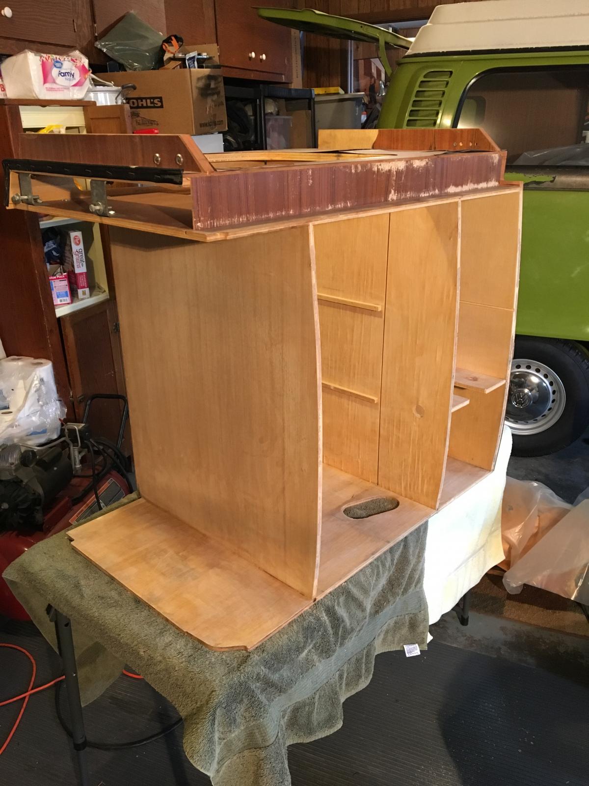

My folks had been out of town a while and they came over for a visit. We had a lot to catch up on and of corse we got on the topic of Buses. I mentioned that I was enjoying posting on my thread on the Samba. My Dad has been reading it and my Mom was asking "Is it was like a Diary of your bus or something?" I said sure, I guess you can call it that. My entry for today starts with a look at the core of the Kitchen Block....
We had taken it out of the bus and it has just been sitting on this 4 foot table in the middle of the garage with a shaft of light focusing on it trying to get my attention. I sort got tired of looking at it so pulled up a chair and started taking pictures of it.
My initial assessment was that it was pretty stained and dirty, with a sink and stove unit, water tank, shelves and woodwork, and some lamination. If I broke this down into manageable parts it wouldn't be tough to tackle bit by bit.
The bottoms had some real dark rings from leaky cans of who knows what.
I strip all the hardware down and pull the sink and stove then organize the hardware. Easiest thing first....
The water tank seems to really be stuck. I know I shouldn't force anything but I can't resist giving it just a little more poundage but it still won't budge. I check in on the search tool here and it sounds like a common problem. Someone outlines where to pry and I get the filler neck to loosen and come free without breaking. Sweet! I look at the fracked laminate around the neck and shrug.
Problem is that there seems to be what appears to be an ancient melted red candle fused to the side of the water container. Definitely wax, and whatever dye it possessed transferred completely into the water tank plastic quite completely. I picture some wisely stored candle tucked into the cabinet for a rainy day and then forgotten to be fried behind the long wall for countless peak summer afternoons. At least I can get the wax off the bottle, but it looks like it ran into the wood at the bottom of the block. Hmmmm
A water and light bleach wipedown reveals that rich burgundy OG stain hiding under an inch of dust. That raises my spirits.
So far so good, once this puppy get all wiped down it gets another whole assessment. I would like to tackle the inner wood issues and reseal that before I get into any lamination issues. The side of the spare tire compartment shows signs that it actually housed a tire at one time although mine is now on the nose. I'm not sure what I'll end up with, I think for now the tire is fine on the nose and that the space for it in the kitchen block will be better served as camping supply storage.
I round up all my sanding supply and give it a steady careful pass by hand with 220 or something lighter and it starts to dust off.
Pretty nice! A good practice area as it is really tucked away at an angle that won't show at all really.
Emboldened by that response, I go ahead and jump on the worse spots. Its just so weird though, it's not acting like that last side wall. It appears that the candle wax has made its way into the wood here along with whatever leaked from the cans. I'll bet it may have been petroleum products for auto maintenance liquids that leaked. Whatever it is, its clogging my sand paper. I get a little more aggressive paper, but I'm getting nervous I'll burn through some of the paper thin veneer and make it look worse.
I just call it quits for the day. I think that's a solid first effort and I'm now getting a real good picture in my head at how its constructed and what my piece is going to need. I resign to the possibility that the bottoms might not clean up perfectly and I may have a red water tank. I can always get a liner in the bottom or a new veneer, I'm just brain storming, but sleeping on it too.
There is noteworthy water damage to the ply in places that also give me pause. These won't sand out and make me really question ever exposing this piece to water again. We'll see, thankfully it's not worse.

It was good to step away for a bit and just accept there is going to be a few oil rings on the bottoms of the block. Its been said before here that some stains that look tough at first just slip away easily and others you think are gonna be easy are the tough ones. Well, that seems to be the case for me. I accept that and can live with it. Will likely be covered in supply at some point when I'm using the bus.
I get the wood as sanded and smooth as I can and hit it with an light grit at the end one last time. Wipe it down with water then when dry with a tack cloth.
I get some light wood stain reapplied then the next day get some clear varnish on it. Makes some of the stains show up again even worse, but there is no turning back, I'm not gonna start letting it bug me all over and twist my mind forever. I said I let that go already right? Its just maddening when you pour so much effort into something and it just sits back and laughs. This bus is teaching me a lot, I guess acceptance is one of the lessons, again.
So lots of pictures here, but I like showing as many as possible. Much more fun and informative than anything I can write.
Overall, its looking pretty nice. The wood is drying into a real nice shade, pretty close to a match to an OG piece I haven't touched. I set a shelf upside down inside to see what its looking like.
The flip sides are another story of crud. Luckily, the filth seems to be less heartily penetrated than the ones on the bottom of the block and clean up rather nicely.
One quiet evening and all the hardware gets detailed. Its a strategy of mine to just take on little steps and hope it minimizes the seaming enormity of the task. The drawers, doors and lid have been refinished. Now the inside of the block is refreshed as well as the two shelves. The hardware is sitting there ready now, so thats getting somewhere. Still to go its the sink/stove piece, water tank and pump, through body connection hardware, gas lines and the daunting laminate.
