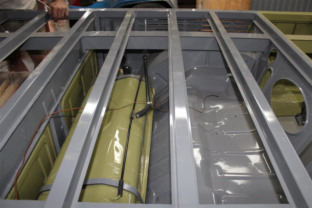

PostPosted: Sat Mar 20, 2021 4:18 pm    Post subject: Re: Is it possible to retrofit a firewall to a 1968? Reply with quote
Angus II wrote:
Hello,
Finished?
And, someone didn't paint the tank hold down straps? Alright...
You mean like this?

babysnakes wrote:
Angus II wrote:
Hello,
Finished?
You mean like this?

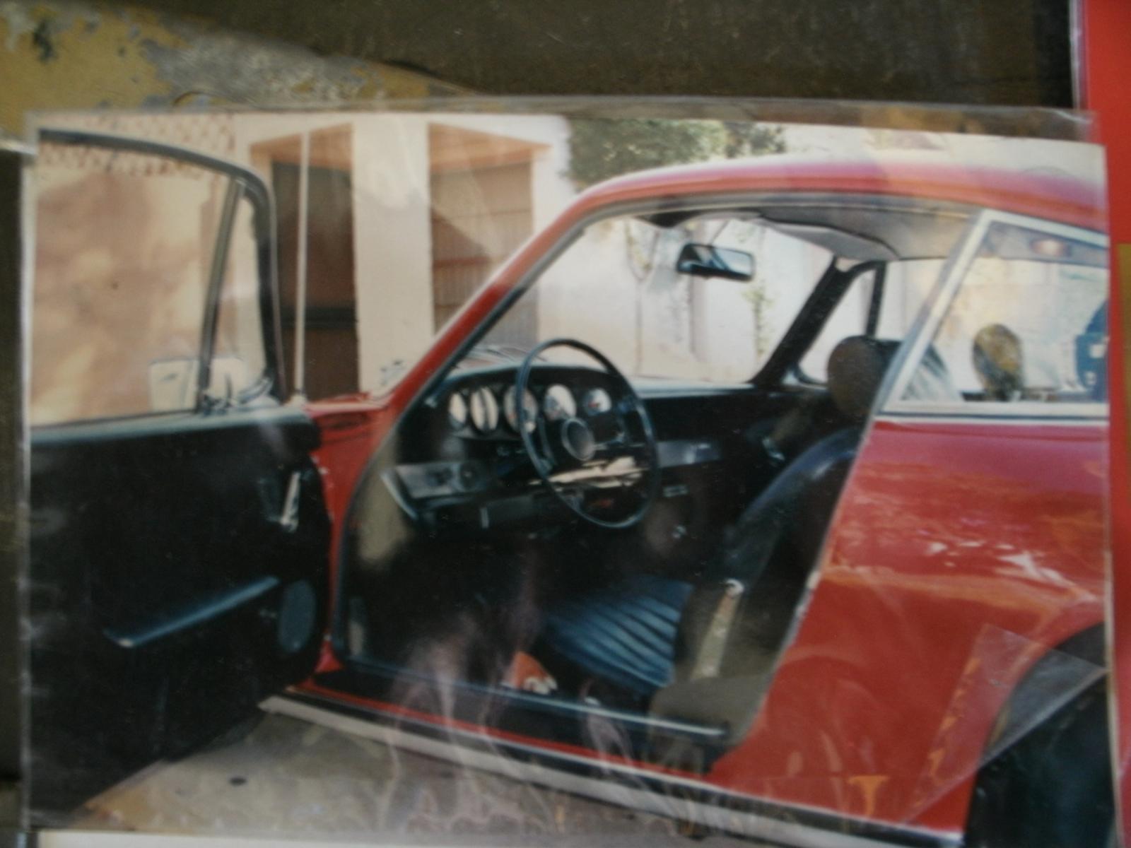

Hello,
Well now, I do like your idea of finished and level of craftsmanship, babysnakes.
It's the details, that counts. Yet, a little out of context for this level of work...
Sorry, someone is butt hurt.
But, you're the one that said "I just finished this...". And, posted the before pictures, not me. I don't have a crystal ball or some tara cards, my friend. I'm no mind reader.
That would be like me posting a picture like this, and saying " I just finished this 68 911T"...
And, expect you to know it looked like this after I "really" finished it...
Now, That's finished and ready for sale, my level of craftsmanship and flip in the day... Oh, and here is a picture of the street view(overflow). Notice, the 71 DC & Kombi in the background. I'm not new to this German air-cooled game. Just, slow on the new valuation of them...
