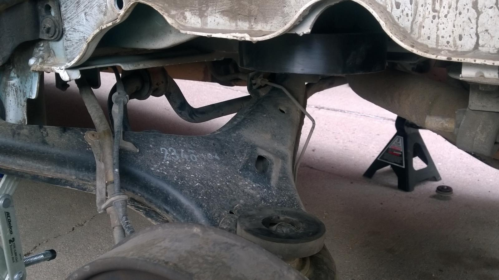

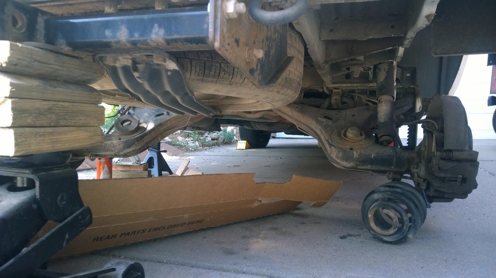

Yeah, well, on a 2003 EVC with rear sway bar the coil came out easily with both rear shocks removed. But getting the coil reinstalled with a 1.25" spacer puck is problematic.
The pic is how it is right now, the factory top seat for the coil is on the swingarm, the 1.25" lift puck is where it should be for a proper install, mounted above the factory top seat. Trouble is, there's no way I can figure the coil can be reinstalled with the lift puck without dropping the rear sway bar.

PostPosted: Thu Jul 19, 2018 2:18 pm    Post subject: Re: Remove rear coil springs 2003 Weekender Reply with quote
After removing the two 13mm bolts holding the rear sway bar to the frame seems I'll have to use a breaker bar to get enough droop to reinstall the springs with the spacers.
I'm not comfortable with that, the ABS lines might get stretched, brake lines. I'm thinking a C-type spring compressor. I have a spring compressor like this - https://www.harborfreight.com/automotive-motorcycl...63262.html but that doesn't work, tried it.

PostPosted: Thu Jul 19, 2018 2:34 pm    Post subject: Re: Remove rear coil springs 2003 Weekender Reply with quote
I’ve installed a ton of these and never had to undo a sway bar.
Are both shocks unbolted?
http://www.cavevan.com
Broseph Stalin
Joined: March 28, 2018
Posts: 433
Location: Colorado
Broseph Stalin is offline
PostPosted: Thu Jul 19, 2018 3:34 pm    Post subject: Re: Remove rear coil springs 2003 Weekender Reply with quote
Yes. Here's pics as is:
I can't get the coils reinstalled with the pucks on top. Without pucks, no problem.
