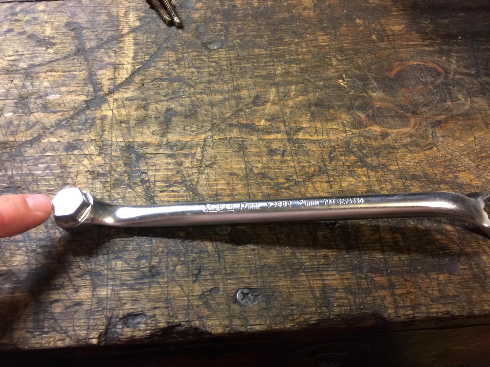

You need a tool to get the 17mm hex (also called "allen") plugs out. The filler plug and the drain are both 17mm. Be sure to dig all the crud out of the socket, so you can get 100% insertion. If you don't get the tool 100% inserted you might strip the hex which causes all kind of problems!
ABN 3/8" Inch Motorcycles Hex Axle Tool - 17mm, 19mm, 22mm, 24mm - Hex Allen Front Wheel Hub Axle Spindle Socket Adapter

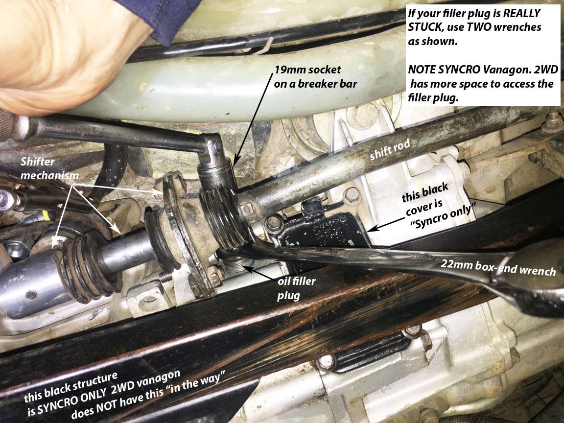

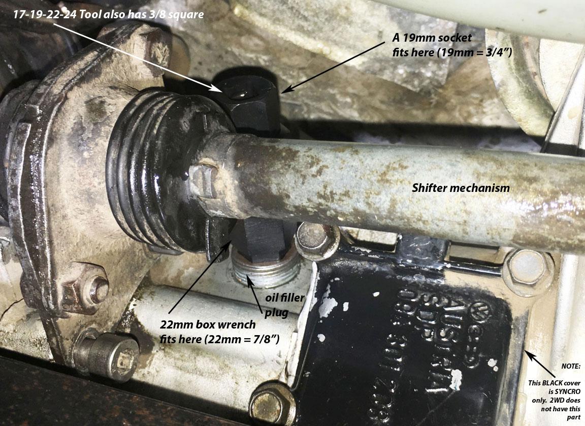

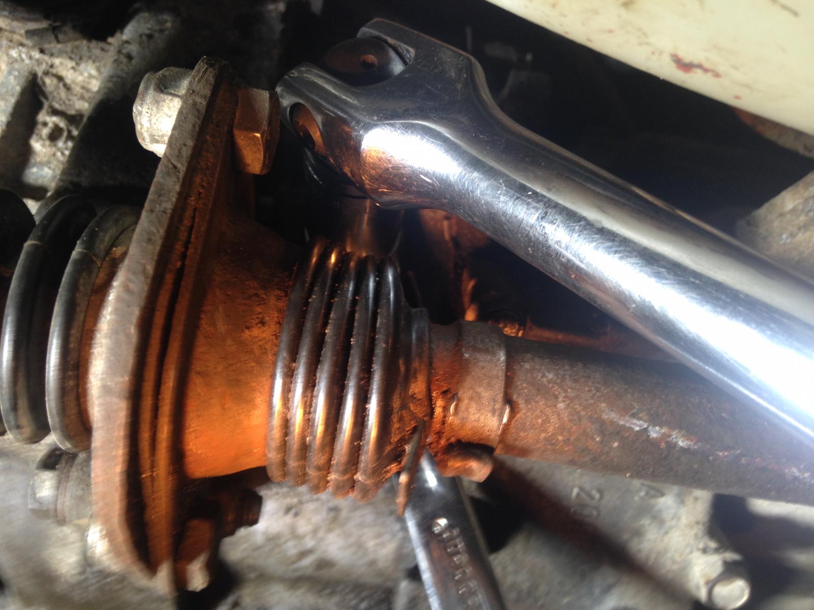

This pic shows the option of TWO wrenches and TWO hands to turn that stuck fill plug (if you have to)
I hope this helps folks to maintain their vans easier. After you get your plug(s) out, tighten them with 14 ft-lbs, and it won't take two hands to loosen it. And don't wait so long either.....maintain your Vanagon.

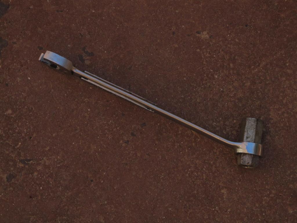

I made this tool about 20 years ago to remove the trans drain plug crowded by the Kennedy exhaust crossover pipe. I probably used it once (my poor tranny.... I should apologize to it, wherever it is...
I passed it on to another Vanagon owner.
Another cool tool found in theSamba images, but it's easy to make this tool with a 17mm coupling nut and a 17 box-end wrench.

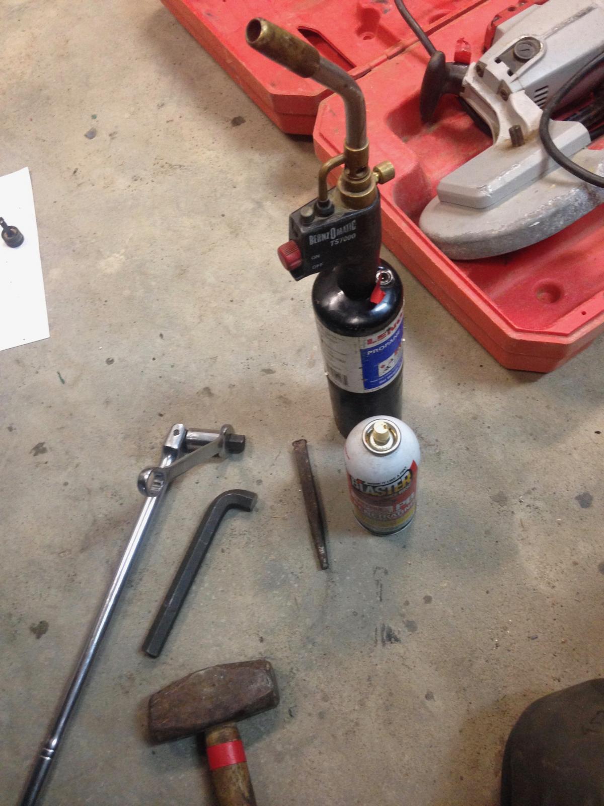

Here is my entry into the transmission tool contest. Just a 3/4 hex long nut that has been ground down on one end to fit the 17mm hex. Easily turned with either a 19mm or 3/4" wrench. Would like to find something similar out of a high alloy steel. This is my travel tool as it takes up the least room of any of the various drain plug tools I own. It of course can be used with a ratchet and socket as well.

The dual approached worked for me. Fought those stupid fill plugs for hours last week. It looked like it had put up a fight before...
Took heat, loud noises, bad words and finally chopping my brand new 17mm allen up to use just as Sodo described above
Found that I could apply lots of tourqe to the 17mm hex stub with a 1/2" drive bar, but because I was not able to get perpendicular it'd slip out when I put some serious heft on it. Using another wrench flush on face did the trick. That and 24" of cheater pipe and a hammer. And heat. And more loud noises
I had chopped the allen up to try to fit under the linkage as another Samaba member had success at doing, unfortunately I couldn't match faces in the amount of available swing. Then the light bulb went off...

Yes. The auto trans differential fill plug is the same 17mm.

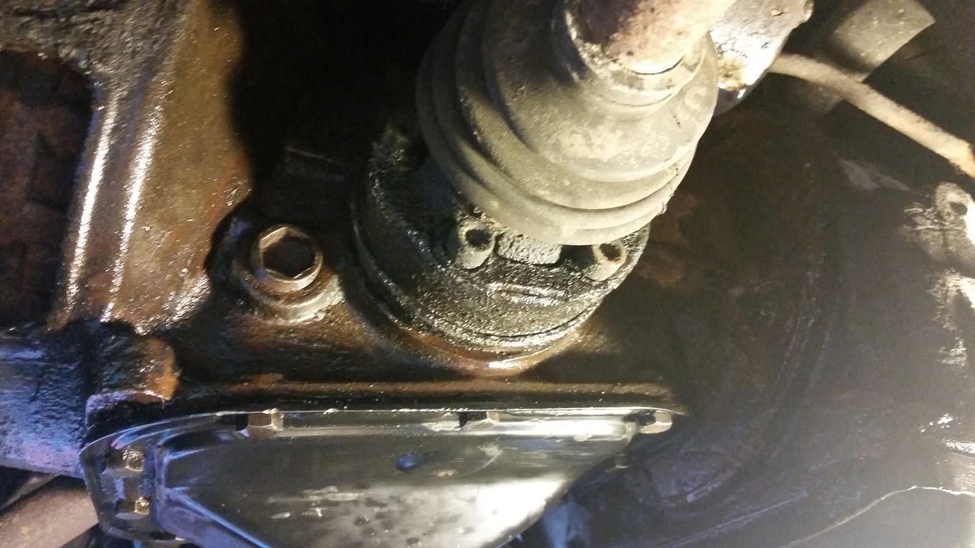

(borrowed pic)
We don't have the luxury of a drain plug, unfortunately.
At home, I use this on both the van and Cabriolet (fortunately, easy to remove on both):
Sodo's tool, or something similar, would be good to keep in my on-board tool box though. Think

So I attempted to loosen fill plug with no luck. I think I will have to weld a bolt to it. However, does anyone have any insight as to whether I can remove the reverse light switch, or perhaps the bolt on top of the trans that hold in the shift shaft and add oil through there?
