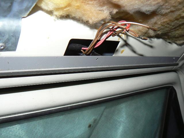

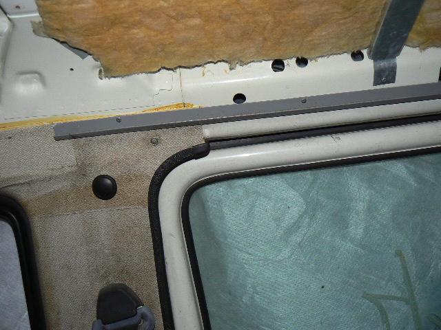

I'm getting back on this project. Can someone post a close up photo of exactly where the J-channel is attached on each side? I'm trying to be as precise as possible.
I used a spot weld cutter to remove the old headliner attachment point. I'll smooth this out and paint and then rivet the J-channels in place.
I'll be buying a 3mil sheet of Baltic birth and cutting it to fit. I've seen enough photos online that I think I can pull this off.

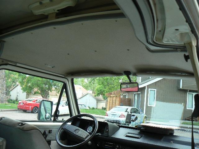

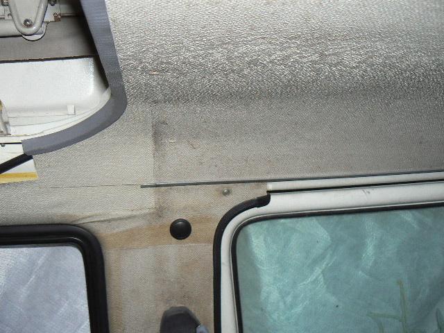

PostPosted: Sun Apr 02, 2017 10:48 am    Post subject: Re: Westy front headliner template Reply with quote
Here are some pics removing it from a donor 91 Westy
And installed in the syncro

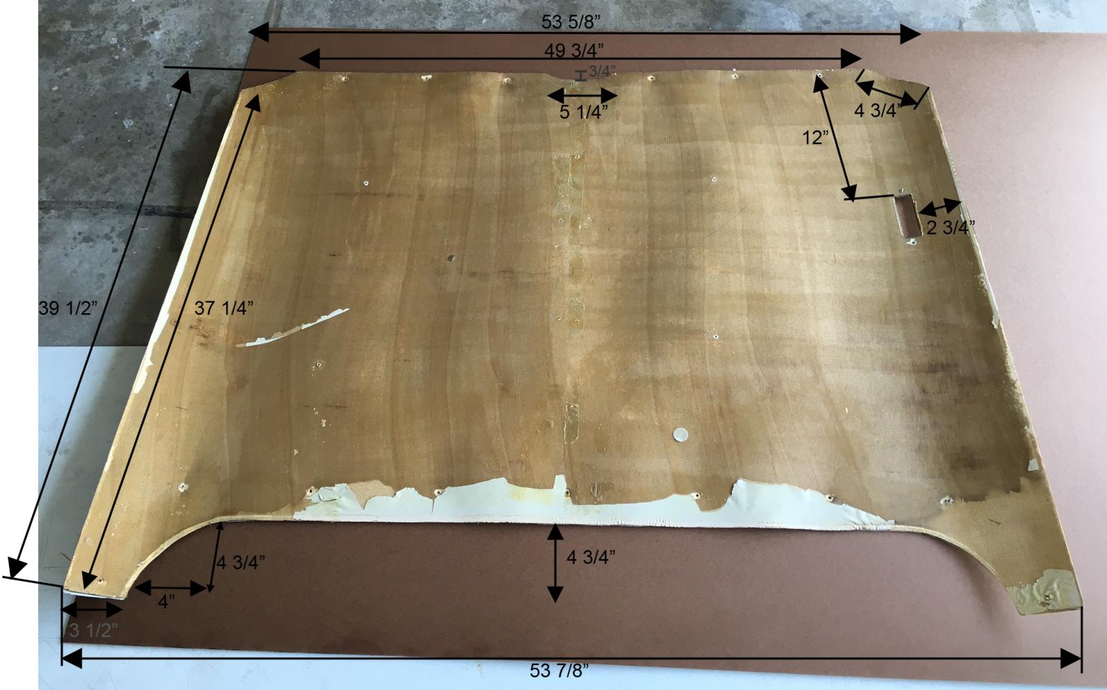

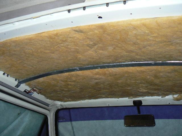

I slowly making progress on the worlds longest headliner project.
I found this photo in the gallery. I'm going to verify some the dimensions but it looks promising.
I've added Dynamat and Dynaliner as shown in the photos below.
I was able to find a sheet of 3mil Baltic birch ply at a specialty shop in Port Townsend WA.
