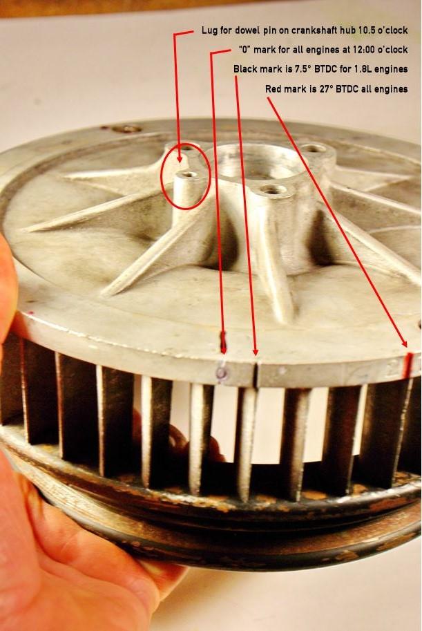

Now.....your timing marks.....
Early 1.8's could have had two marks......a black line.....and a red one to the left of it. That black line on some models was either 5° or 7.5° ....depending on where it is in relation to the fins. The right line further to the right was 27° BTDC. On later 1.8's.....some just had the 27° BTDC red mark and others just had the 7.5° black mark. None of them had "triangles"
I will post a picture shortly to show you how to figure out what each mark is. Ray

Ok....this is to help someone...anyone with a type 4 engine...whether its a 1.7L, 1.8L or 2.0L or a custom displacement.....that is using a stock crankshaft mounted fan.....set up basic timing marks if you do not have a fan with marks (like one from a late bus)...or you are not sure of the correct marks.
Getting oriented first:
With the engine at TDC on #1 cylinder. Almost all 914 1.7L and 2.0L had a "0/TDC" mark. Some 1.8L did not. You really need to know "0" on all engines for a variety of purposes.
When looking through the hole in the fan shroud from above...."0" will appear in that "V" notch in the fan shroud and will line up with the centerline of the two case halves....always.
Looking from the pulley side of the fan when its bolted onto the engine....here is the basic orientation. The "0" will be at 12 o'clock...the lug that connects with the dowel pin on the crankshaft mounting hub will be between 10 and 11 o'clock.
The 7.5° mark will be about 1/2 fin to the right of the "0" mark. The 27° BTDC mark (red mark) is three fins further to the right of the 7.5° mark.
So if you do not have a "0" on your fan...how do you proceed?
Ok...now that you know the locating lug orientation ...between 10 and 11 o'clock when viewing from the pullet side of the fan...you now know where the correct "quadrant" for "0" to appear is. So stand teh fan up that way in front of you.
Looking at the picture above.....from the fat support post on your left...count 6 fins over to the right...and then 1/2 of the space between fins...and the "0" goes right there....at 6.5 fins from the left.
For the 1.8L timing mark at 7.5° BTDC...go 1/2 fin more to the #7 fin...and thats where you make the mark.
For 27° BTDC...count three more fins over to your right to fin #10 and thats where the mark goes.
This will get you to pretty damn good basic timing.....but
there is a math issue:
So about right now you are looking at that 7.5° mark...and dividing 27° by 3.5 spaces...and coming up with 7.7°...right? Confused Wink
Yes.....thats because....in reality...the "0" is not EXACTLY dead on between two fins.
Its actually about 2° closer to the left. Like I said...just counting half spaces will get you to good "basic" timing. So if you want to be exact.....
If you look closely...the "0" is 2° closer to the left...because the factory actually measured that "0" coming from the vertex of the crank/fan centerline.....and it corresponds to a line shot from that vertex...with the inside edge of the fan blade (yellow line). Since the fan blades are canted...you get a 2° difference in placement.
This has caused some small confusion over the years.....as they list 1.8L idle timing at 7.5°....which is close enough...because at a glance the "0" timing mark...if you have one..."seems" to be dead center between fins...but its not.
In reality.....that 1.8L black timing mark for 1.8L.....is at 7.7°....but thats not a big deal really.
Ray

Upon further inspection I do not see a 0. But I do have a notch that is between fin 7 and 8, but is closer to the 7 fin. The black triangle I spoke of earlier is actually where someone painted this notch. My thought is to mark fin 10 with a red marker. There is currently no mark at fin 10. Am I thinking about this correct?
The mark closest to fin #7 is the idle timing mark for a 1.8L. It is probably 7.7° by the inner edge of the fin. Very small differences by 1-2 degrees through the years. That will make no difference.
Yes....putting the red mark on fin #10 is a good idea. That is 27° BTDC.
Why the factory used 27° BTDC.....is an excellent reason. The factory distributor was a combination mechanical and vacuum advance. The vacuim advance kicked in first at a hair over 1000 rpm....and gave about 10° of advance just to allow it to smoothly get off the line until the centrifugal advance kicked in.
The centrifugal advance was set to max out at 27 BTDC....which was perfect for short stroke engine....even better on the high compression 1.7L.
So with vacuum advance hoses disconnected....you run it up to 3500 rpm which is where the torque peak and HP graph crossed with that stroke and compression.
In reality.....when driving.....the vacuum would get high again and the vacuum advance would generally....partially.... kick in again near 3200-3500 rpm and give about another 5-8° advance....so total advance at 3500-3700 rpm was right 32°-35°.
Some people can see all the way to 40° total combined advance. On a 914 or 411/412.....with the high compression (8.2:1).....and spirited driving.....this was too much. So there was a vacuum advance can available that had an adjusting screw that could limit advance so you would not get into pinging range on hard acceleration.
If you are running a full mechanical distributor....just set it at 32° at 3500 rpm as starting place. If you are running the stock 1.8 distributor with vacuum advance.....set it at 800-900 rpm idle at the black mark near fin #7....then check it to see that it does not go more than a half fin past that red mark on fin #10. That is 32°......note that in my pictures....I installed a mark there so I could check this. Ray
