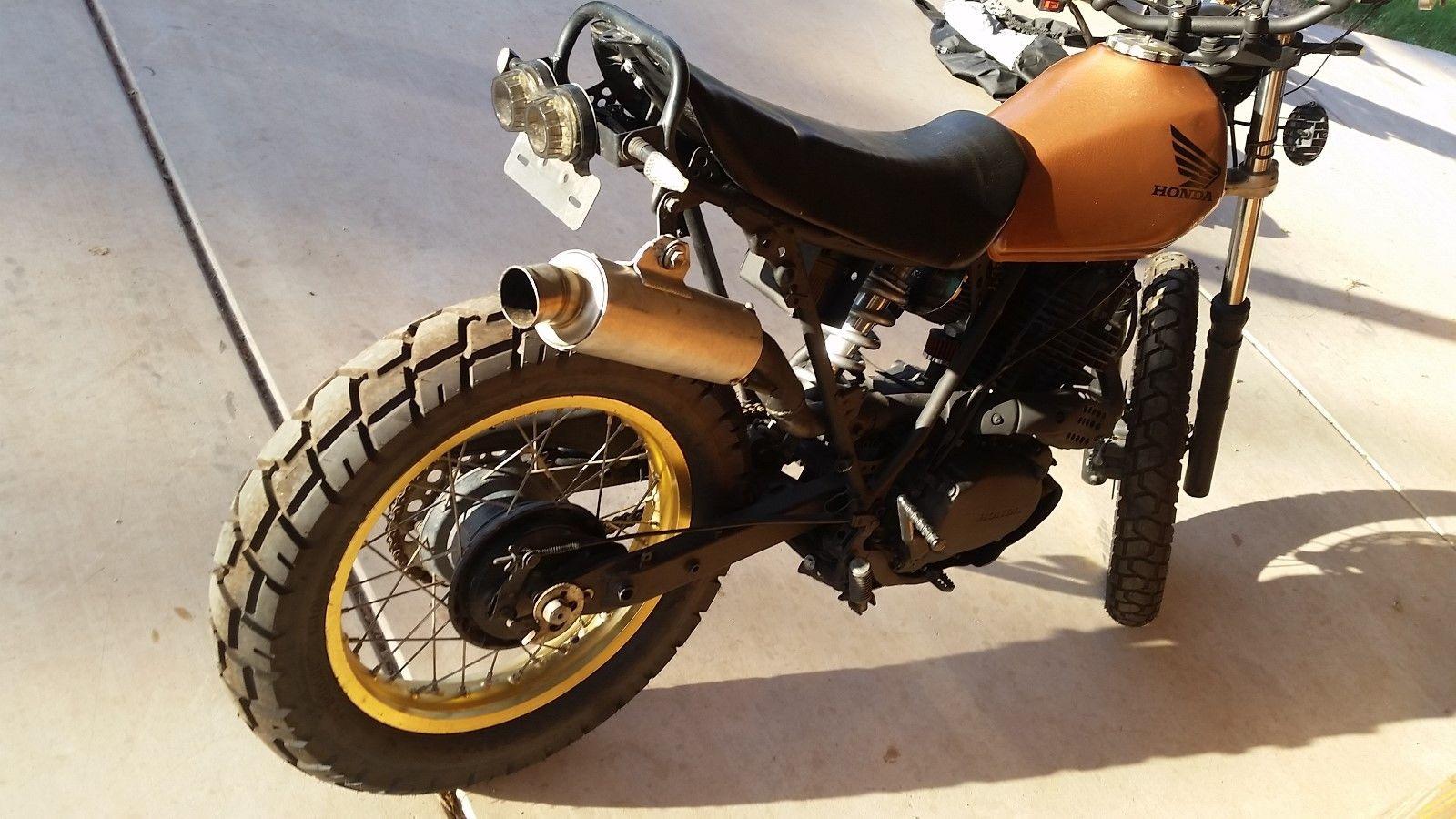

Here's a pic
It's a stripped, hot rodded XL500R (not XR - misspoke)

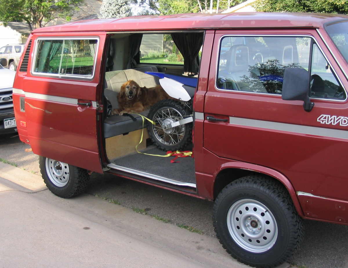

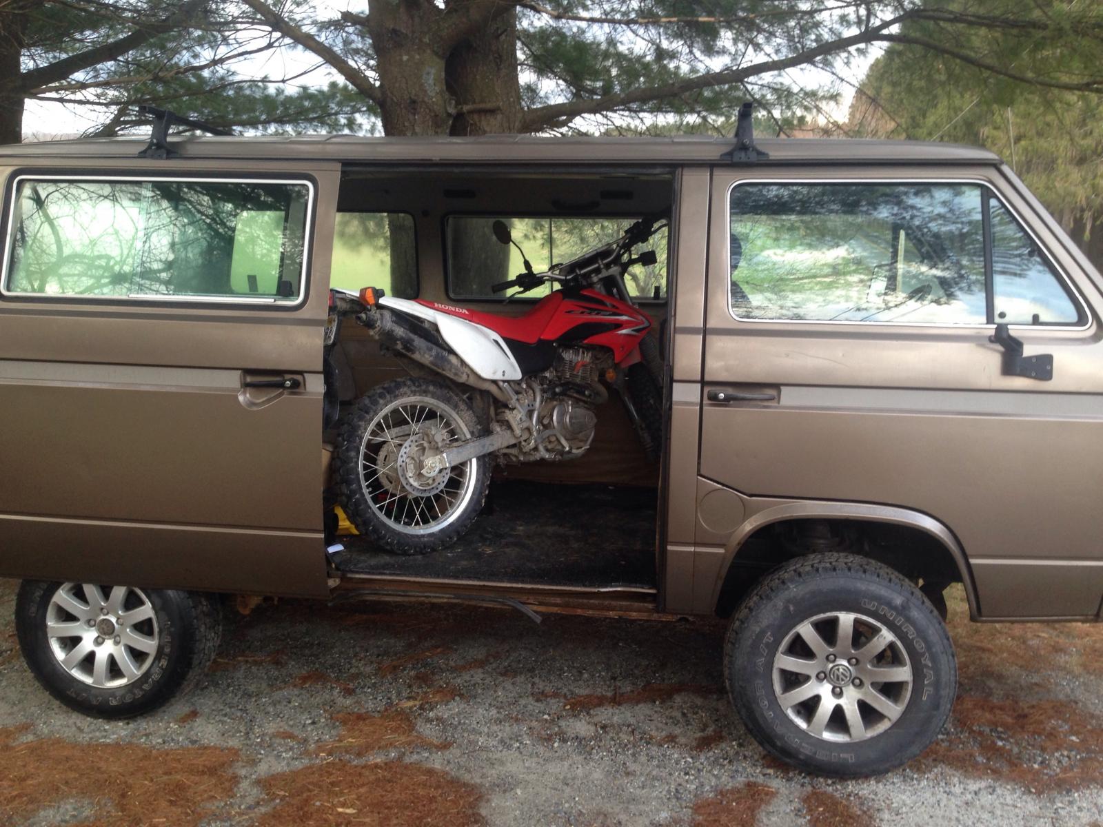

Google search:

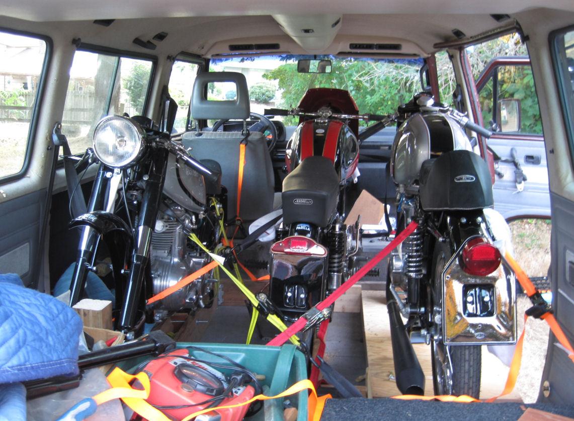

Run it between the front seats. Make sure you have something between the rear tire and the rear seat to avoid a black mark on the upholstery. You might want to make a small ramp from scrap wood to get over the 2" rise running it between the seats. Make sure it's not too far forward that you can't shift into 2nd. Have all the tie-downs all set up and ready to go to avoid the contortions you'll be making trying to hold the bike up and tying it down.
I pushed the bike hauling limits in '15 hauling 3 bikes to Denver. Everything came out.
