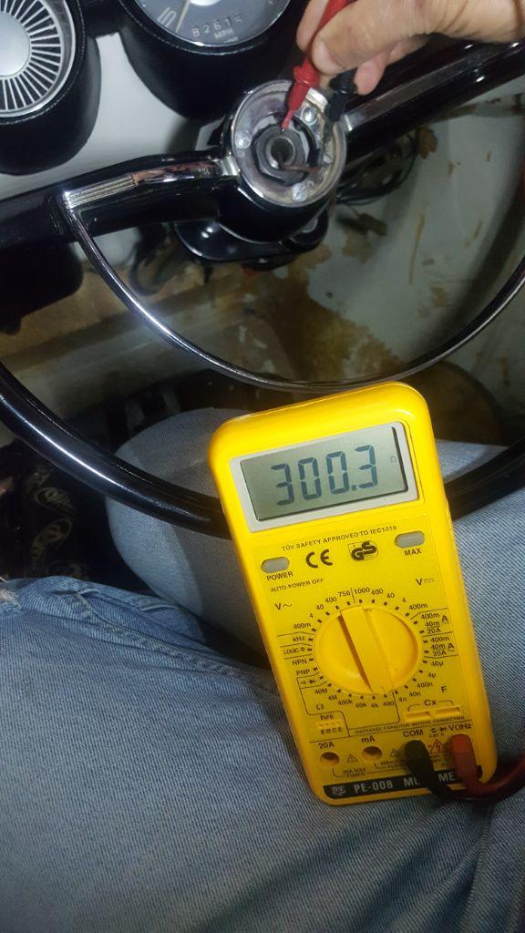

PostPosted: Tue Aug 14, 2018 1:51 am    Post subject: Re: steering coupler disc Reply with quote
here is a pic of the coupler
here it is showing resistance between the metal posts
and here is a pic from the SGF website showing the construction of the coupler.
i believe the fibre inside the disk must be the problem as if i put the meter into the rubber it shows no reading.
the bughaus coupler in the link is aslo made by SGF so i assume its conductive...........

PostPosted: Tue Aug 14, 2018 7:53 am    Post subject: Re: steering coupler disc Reply with quote
That appears to be the correct coupler. It's the same one I have. Mine is most definitely not conductive. I have not attempted to measure resistance through it though. It's not conductive in the sense that it does not cause the horn to sound nor does it drain the battery.
But you are showing a resistance of 23,000 ohms. I'm not sure that can be considered "conductive" in a 6 or 12v system.
I'm not convinced this is the cause of your battery drain. An easy way to check would be to remove the fuse for the horn circuit and then test the draw at the battery with an ammeter. If you still have a draw, then the coupler ain't it.
I know this is gonna sound stupid but are you sure you're installing the nuts and bolts/washers and electrical jump-over tab correctly? I feel like there's something else going on here.

PostPosted: Tue Aug 14, 2018 5:30 pm    Post subject: Re: steering coupler disc Reply with quote
heres the pics from my flat battery post
and with the coupler out of the car but having bolts tightened up to show resistance...
this coupler is fine for cars that have the strap across the coupler as that makes the column earth anyway.....

PostPosted: Wed Aug 15, 2018 8:12 am    Post subject: Re: steering coupler disc Reply with quote
There are some electdically conductive rubbers. They typically do not have the tensile strength required for a part like this. Too much carbon.
Another issue that is actually fairly common...are conductive mold releases used in the molding process.
23,000 ohms is not particularly conductive...but can be conductive enough to slowly drain your battery.
Did you wash the coupler before installing? Do that to remove any possible conductive mold release on the surface.
On the other hand....it looks like a damn good design. I looked on their site. All this company makes is torsion couplers. They are not just a Chinese repop company. I would find it hard to believe that they actually made this kind of design mistake.....but not knowing that the coupling does more than just transfer load....they might.
Also....looking at the cutaway diagrams on their site.....it looks like the metal flange parts are also double sided metal grommets. They will when squeezed contact the metal tube/ferules inside.
https://www.sgf.de/en/sgf-sueddeutsche-gelenkscheibenfabrik-english/service1/interesting.html
Also....you show testing between two poles with your volt meter. Test again....diagonally. its possible if they are using some metal or carbon fibers.....that you havd to be careful how its installed. Ray

PostPosted: Thu Aug 16, 2018 1:49 am    Post subject: Re: steering coupler disc Reply with quote
thanks everyone for your replies........
my working so far is as follows
1. current draw of 87mA takes about 3 weeks to flatten the battery to the point where the car wont start and as it not my daily driver it needs to be fixed. this 87mA equates to approx 300 ohms as can be seen from the steering column to the outer. column itself is isolated from the body with the rubbers but didnt take a pic of that.
2. i could just wire the horn so it only worked with the ignition on but thats the easy way out. ( guess thats why VW did it on later models )
3. with the coupler out of the car testing resistance from each of the metal posts i get 23K ohms which may not be a problem
4. when the coupler has the bolts in it and tightened up the resistance is 1.25K ohms but the more you tighten the bolts the lower the resistance becomes. if i left them at 1.25K ohms the battery would be flat in a couple of days and the steering would be wobbly.
5. conclusion...the fibres between the posts must be conductive because if i stick the probes into the coupler rubber bit i get no resistance reading.
as i tighten the bolts the fibres are compressed together and become more conductive......
does this make any sense to anyone ...........

I just found some notes here and there on-line.....about the "Tenpu" fiber inside of these. It is a carbon fiber composite......so its quite possible that the fiber itself is conductive.
It "should" in most cases....depending on position of the fiber bumdles and the steel bushings when molding......be insulated from the stedl bushings if the rubber during molding squeezes in properly.
I think its what I was getting at in my last post. There is a cuttaway in one of the drawings on their site. The steel part that surrounds the metal tube that the bolts you through.....are technically steel flanged grommets.....meaning they have an inner and outer flange. As you tighten the nuts.....it can squeeze the grommets together....squeezing the fibers looped around the post....closer together and making contact between carbon fibers....inner metal tubes....and steel grommets.
Understand.....you "could" if they are loose.....remove the steel tubes and replace them with simple glass filled Delrin tubes. You do not have to tighten the bolts until they squeeze the rubber donut. This is why they use nuts with cotter pins.....so that you do not have yo tighten jt down until the nuts reach a torque level. You tighten it up enough to remove all slack...then put in the cotter pins to prevent them backing off.
Ray

This is very interesting. Since I'm using the same coupler and since my horn circuit is also hot all the time, I am curious to check for any parasitic draw on my battery.
My car doesn't usually sit for 3 weeks at a time except for maybe in the dead of winter when they've bombarded the roads with salt. But I usually keep it on a battery tender if it is going to sit for a long time so I haven't had any issues of the battery draining low enough to keep the car from starting. But now you've got me curious.
Yes, this IS very interesting. I don't have my horn hooked up, but the parasitic drain thru the coupler is interesting. On my own car, I have to disconnect the power to the radio/CD player, or the battery will be dead in 2 weeks from maintaining the presets and clock function of the radio.
