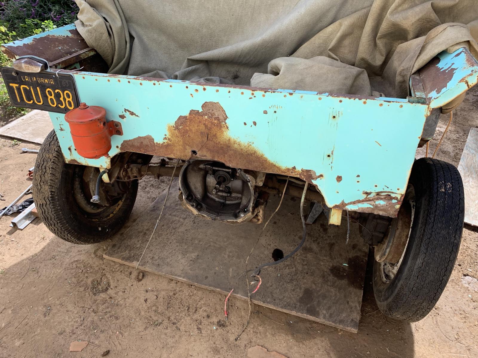

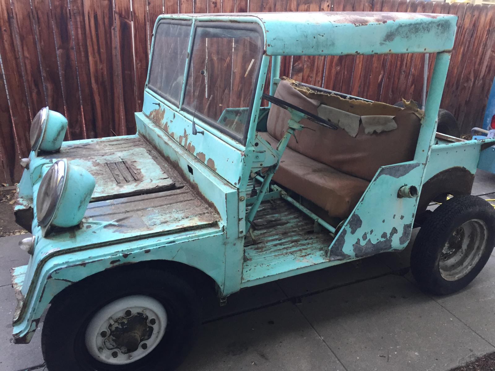

Here is a wild one... from a cut 1953 single cab pick up?
If you can point out anything of interest feel free to.

trying to figure this out, which wiper motor should I use. I assumed it used a barndoor wiper motor but looking at the mounting surface it doesn't seem so. I hope to make it road worthy and having functional wipers are one of the requirements to pass the DMV inspection. I'd assume using some sort of SWF wiper motor, however, I don't have any laying around.

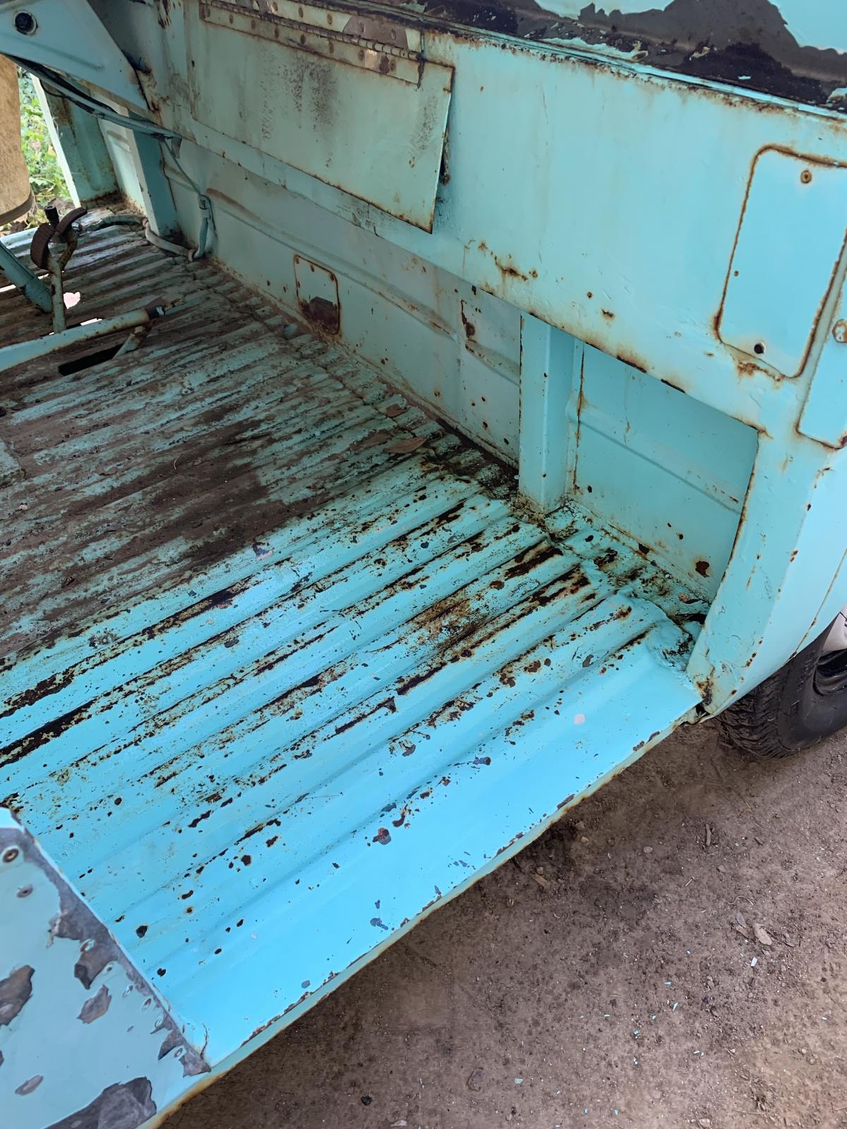

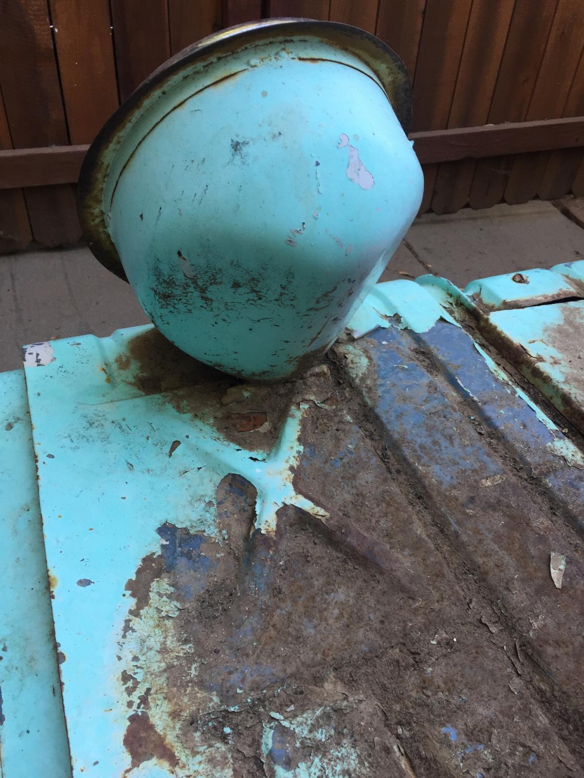

Update so far:

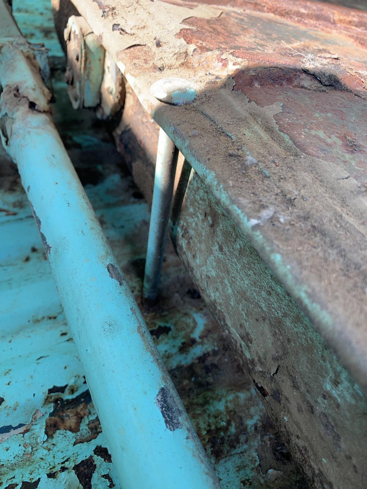

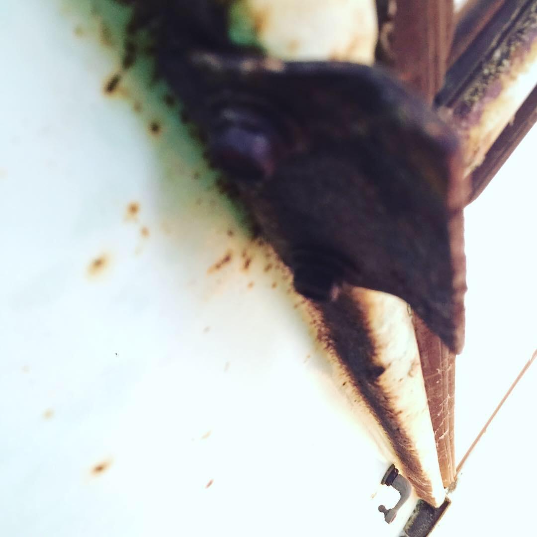

Just started cleaning it up, and giving it much deserved bath in a couple of decades, mentally preparing to start working on the mechanicals.
Some of the paint was flaking off, and it appears at one point it was painted pink below the turquoise color. Of course, dove blue from the factory was still present as well.

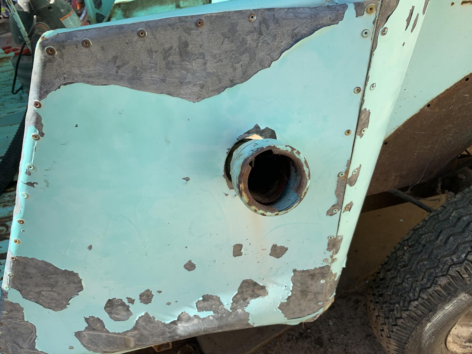

Driver side (not washed)
Passenger side, after a good wash down

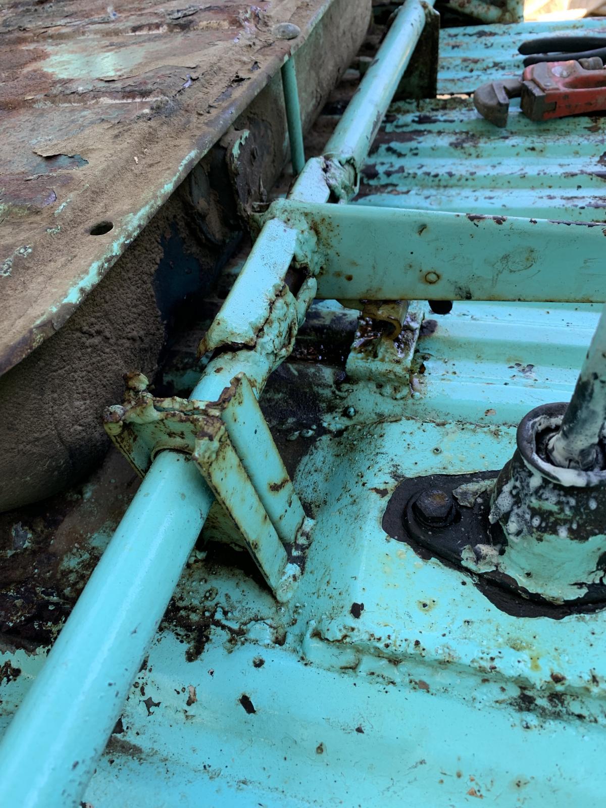

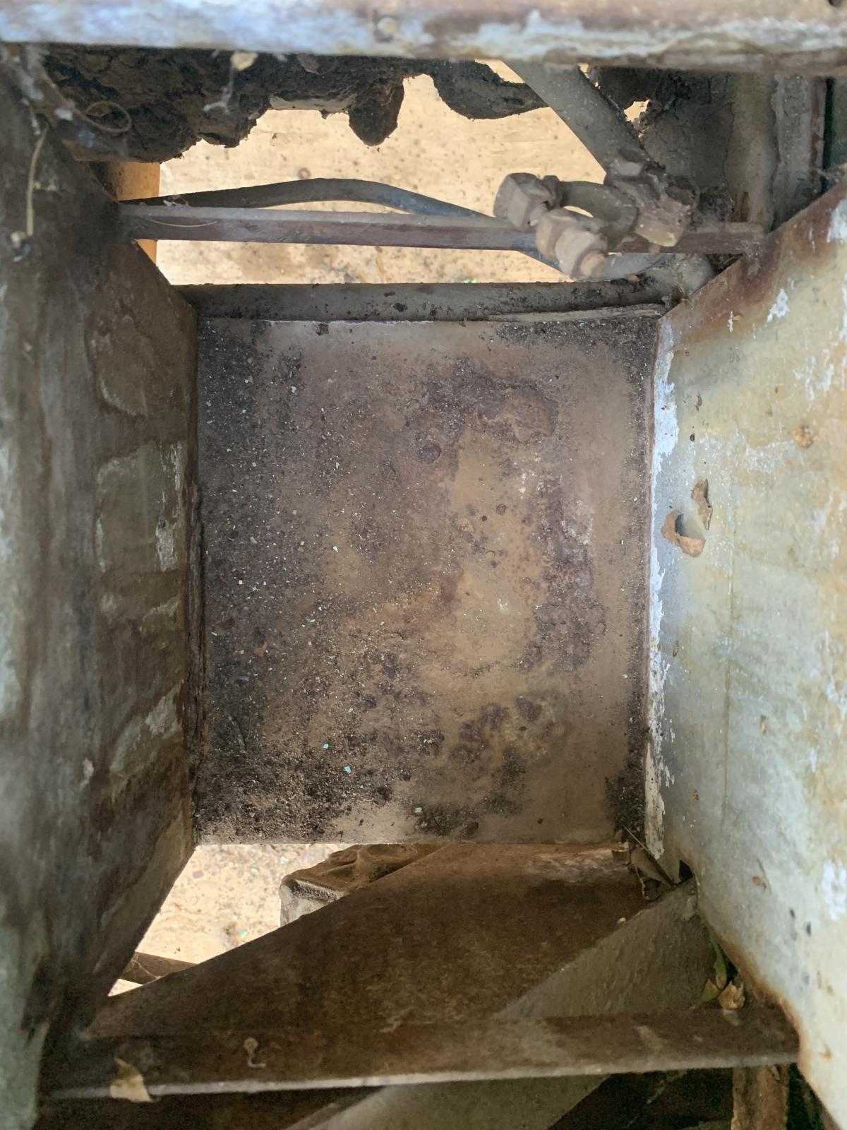

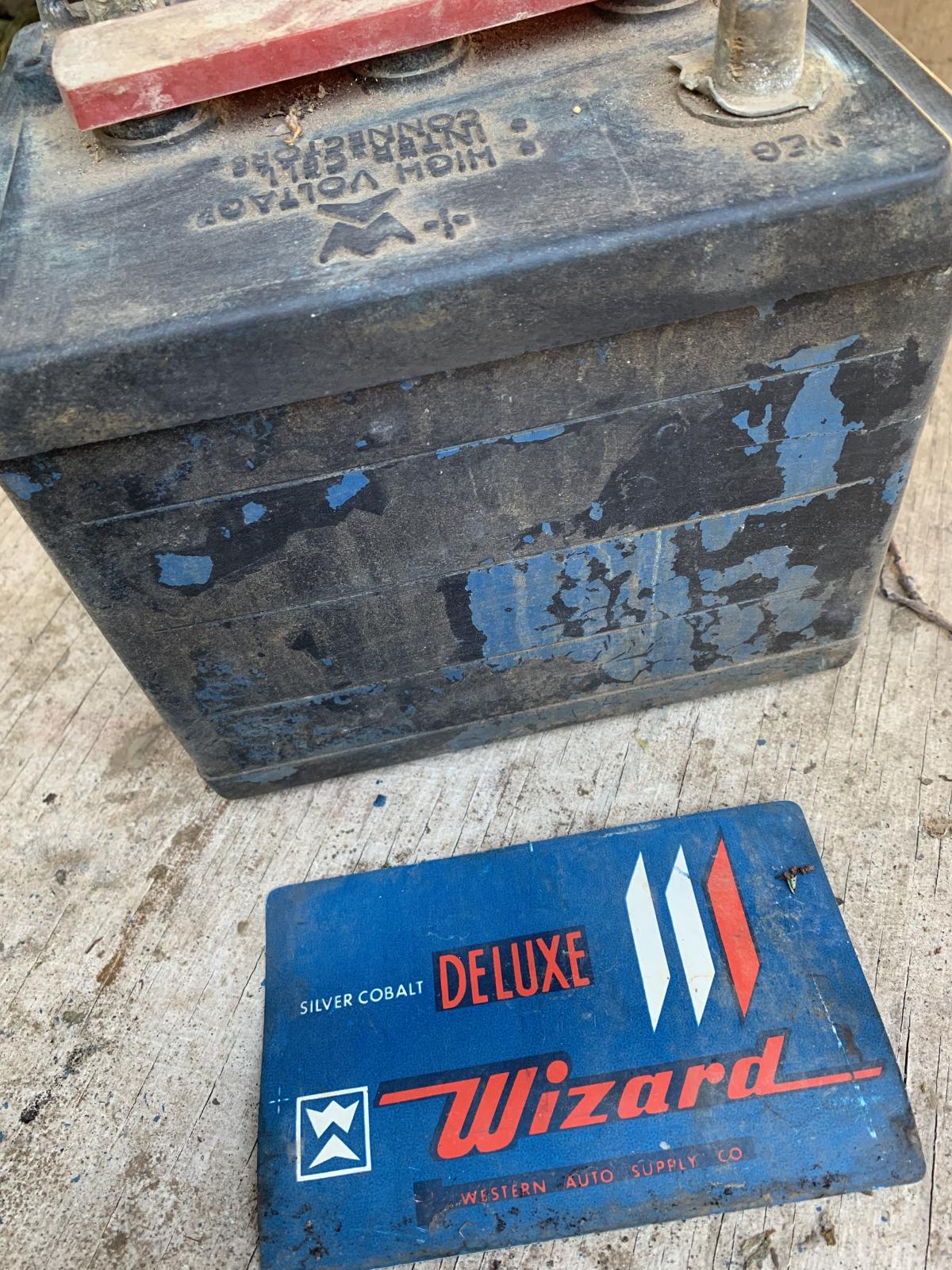

Removed the seat, to figure out the fuel tank situation. It doesn't seem to be VW related, anyone know the make? I am not sure if I will use the same tank or put in a replacement. Time will tell. Here are some photos of the gas tank

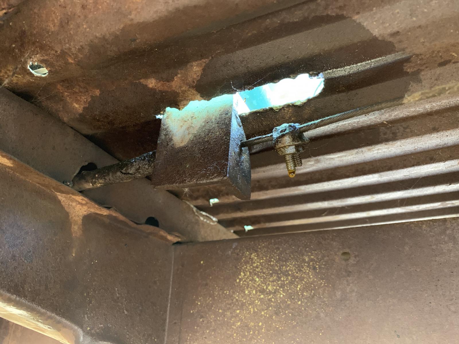

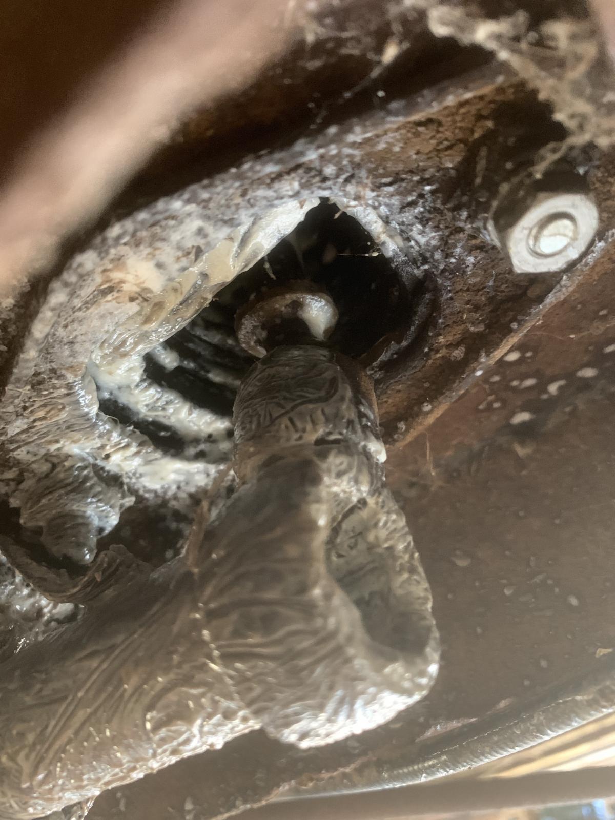

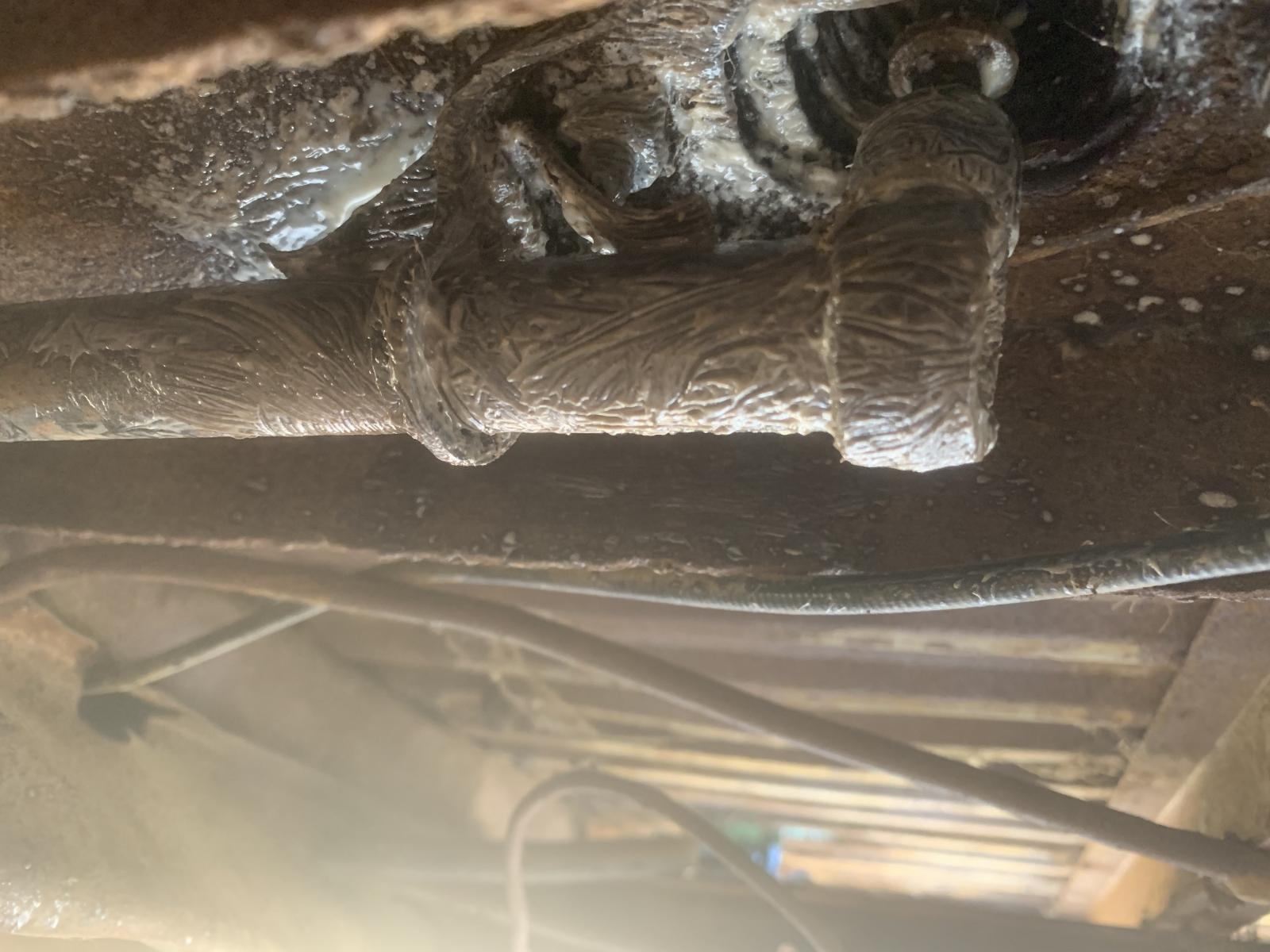

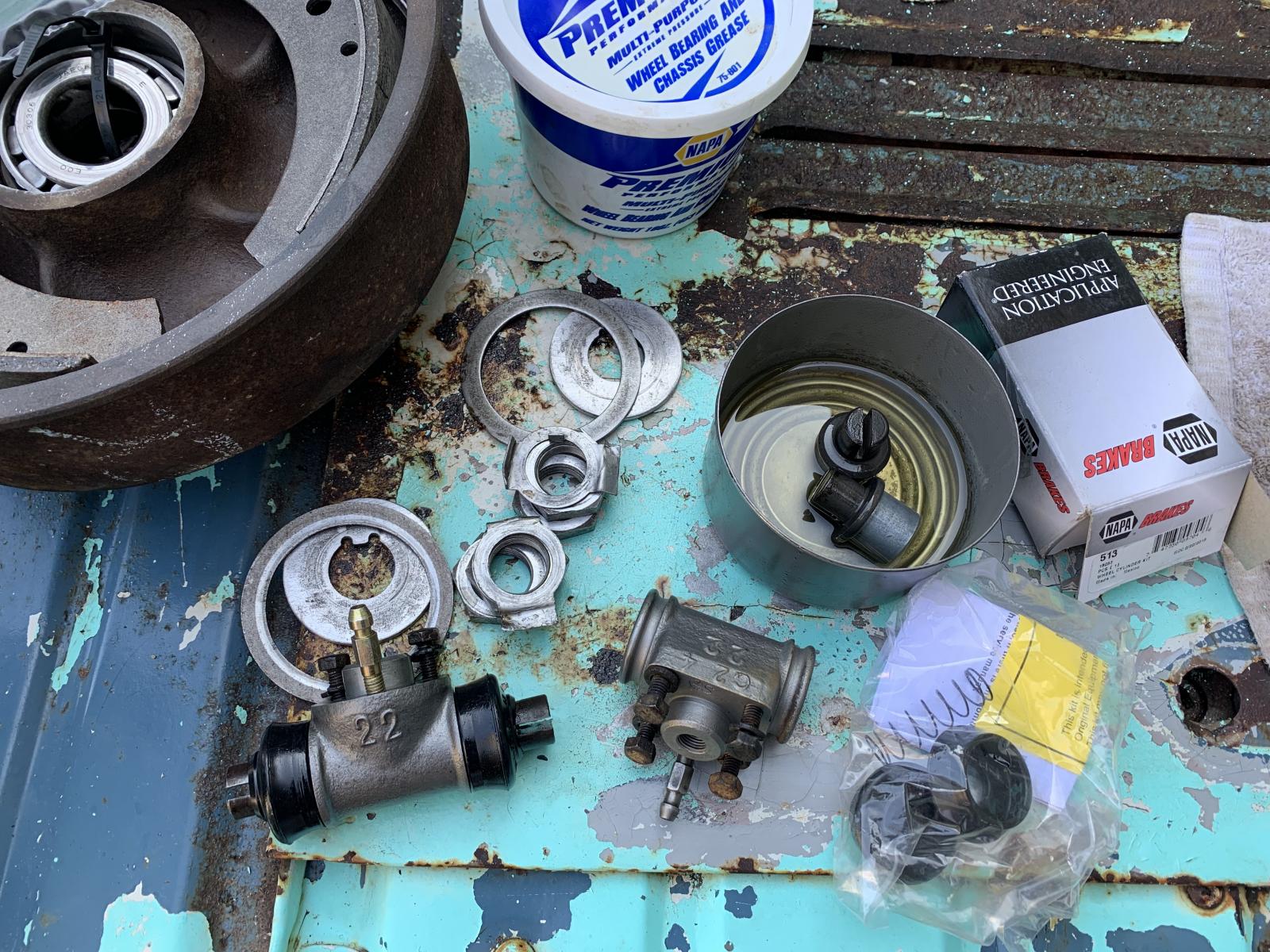

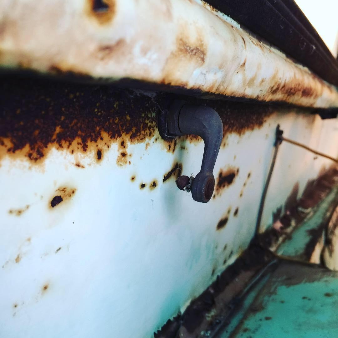

Moving on to the shifter/linkage, it seems someone used everything from a barndoor except for the base (plate?). Greased them up and they moved freely.
Then onto the E-brake system, it's a weird mish-mash of bus items utilizing some homemade tube steel with cargo floor/ frame bits including the e brake handle off a bus (maybe BD?)

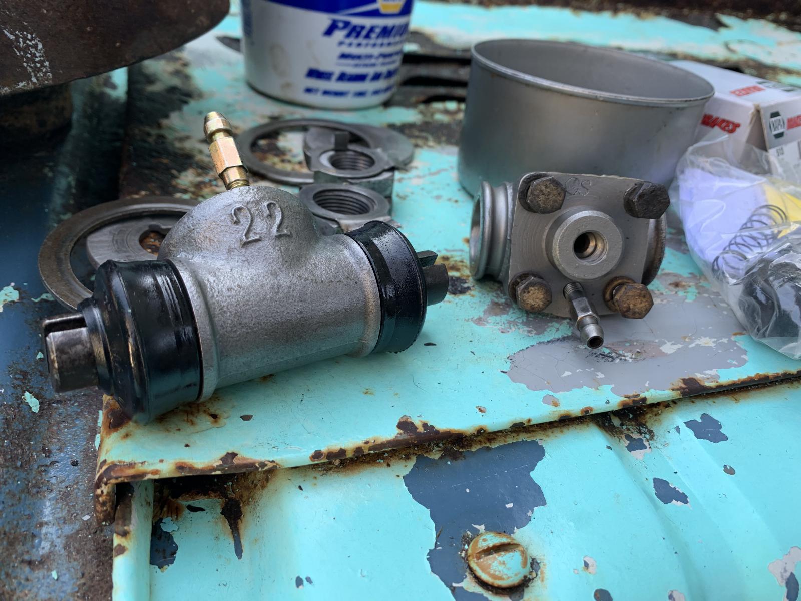

Brake master cylinder :

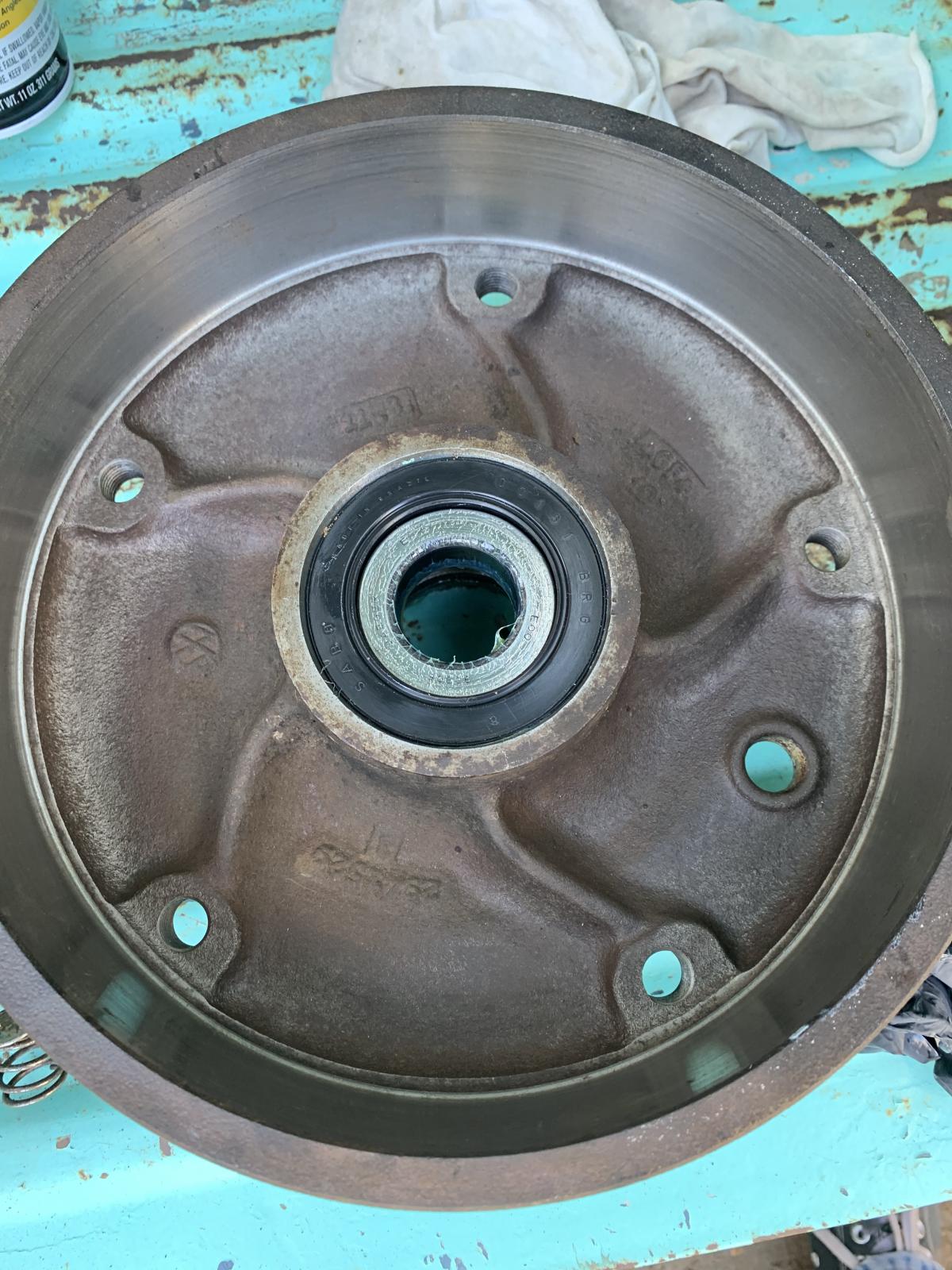

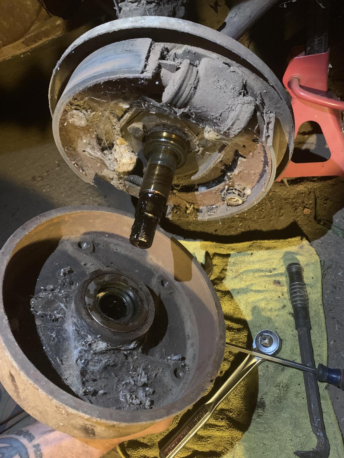

Then it was time to remove the frozen 36hp. I dont think it is salvageable but I will set it aside and see what I can do about it. I gathered some old school items that I plan to use on the buggy. Still will be 36hp, with cyclone headers/muffler, 019 blue screamer dizzy and maybe some high lift rockers later down the road.

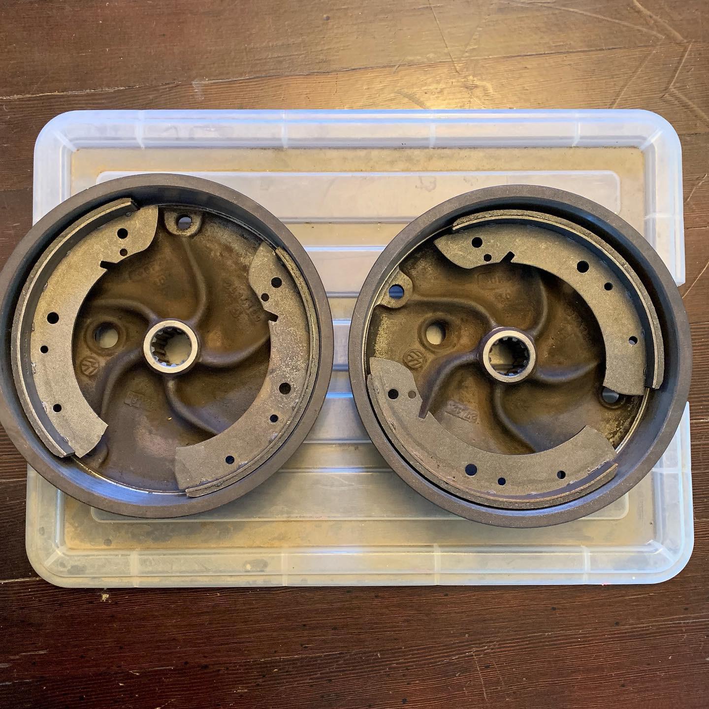

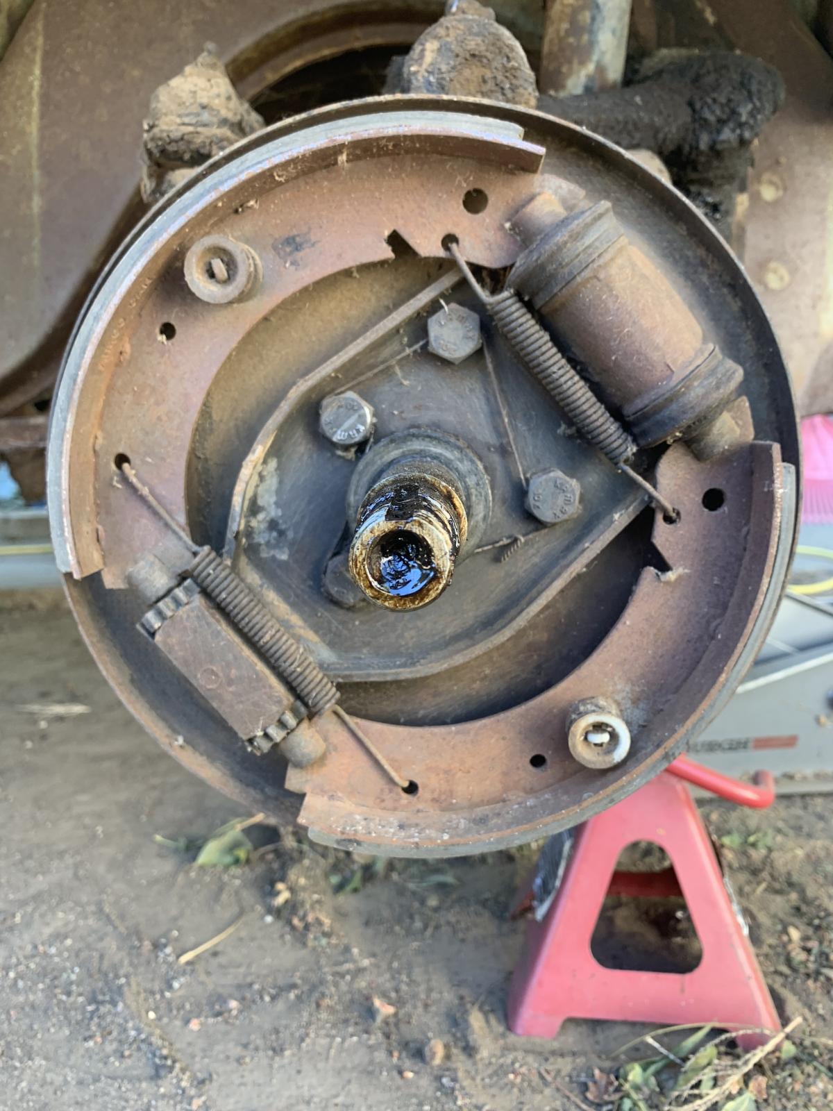

Also I found out the passenger side rear drum had bad spline and was wobbly, and I was lucky enough to find a good replacement drum locally. I will probably need to rebuild the wheel cylinders. Does anyone know about relining the brake shoes or a replacement? I'm based in So Cal.
That's all for now, as I am focusing on getting all mechanicals sorted out.

I was vaguely fascinated and horrified when I saw that for sale. I'm glad someone's putting it back on the road.
FWIW, if it has bd brakes, the rears are the same as fronts on oval window bugs.
The front are bd only. Rebuild kits were the same as 68 bug IIRC. Brake hoses are same as bug in front, split bus in back. Just look up the p/n
I'm impressed it still has the M spring in the shifter.
And bd wiper pivots. Can you fit a 55-64 wiper motor?
Appreciate the brake parts sources. That is really helpful, relieves me a bit. I haven't moved up to the front brake department yet but they all are definitely bd drum to drum.
I'd have to agree I was surprised to see the M spring there. There are many little details which I keep finding every time I check it out.
55-64 wiper motor, I'd need to borrow a spare and see if it will mount, or fab a bracket. That's the plan

"gatorwyatt wrote:
This is a fun fact. After different cross matching part numbers the front shoes for barndoor brakes are the same as Porsche 944 for the late 70's to early 80's rear. One hole needs to be drilled for a spring but other than that they fit.
vdouglu wrote:
Even more fun facts ... they are the same as Super Beetle and Thing rears.... Wink with the need to drill out the same hole. I've bought them for $10 a set and worked great on my bus... Cool"

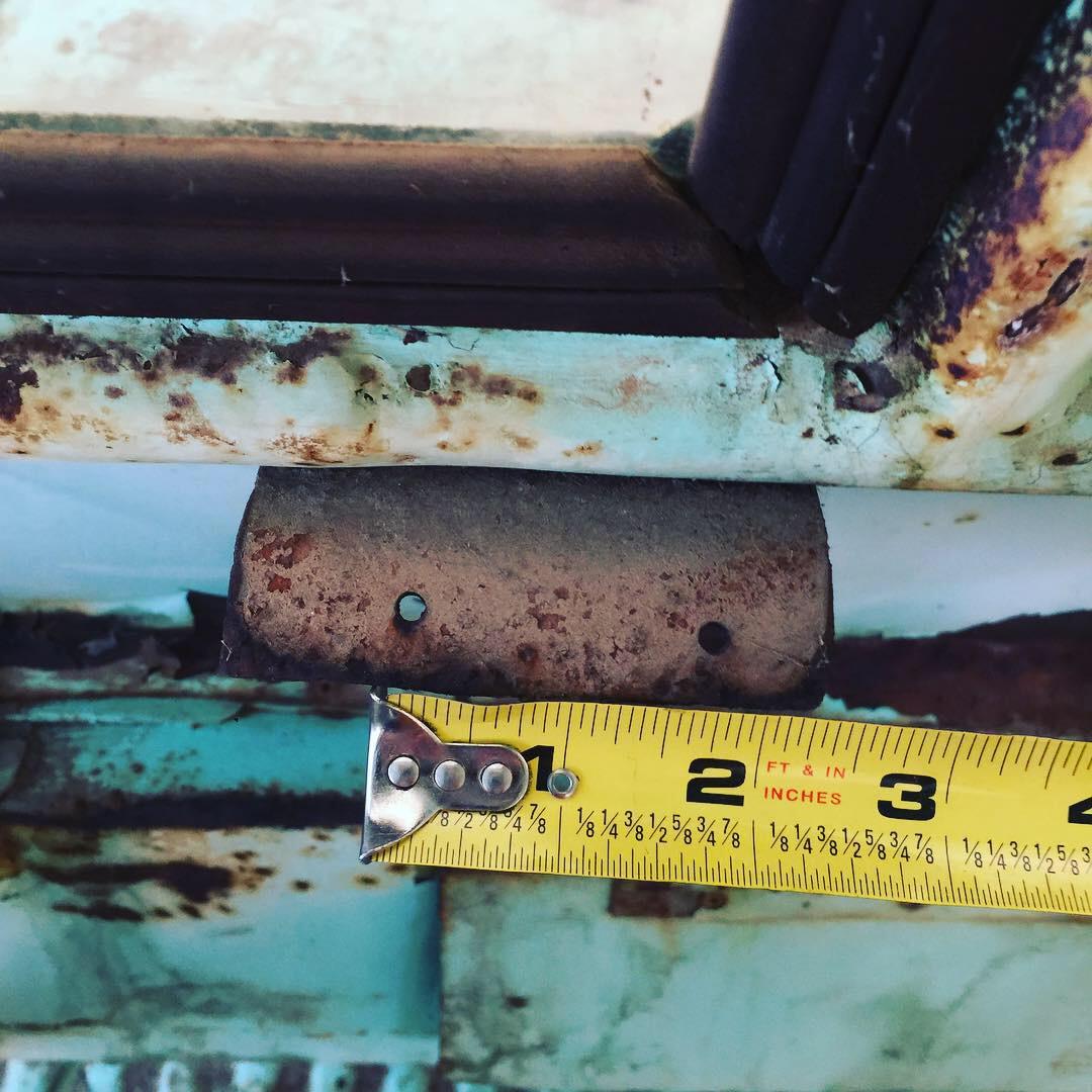

question: what do you use for padding under the seats? Wolfsburg west supplies replacement for 55-60 but my seat is earlier.
What do you guys use instead? As for my case, seat pads are nonexistent and I plan to recover the seats soon.
would the 55-60 work with some modification or are the sizes different? Thanks

Clara wrote:
AWESOME!
I'm getting ready to order brake parts. The rebuild kit for wheel cylinders is the same as the 1968 bug, as in front and rear sets? I will double-check w the p/n's if i can find them.

Update:
I got in touch with George Schmidt from the Butcher Shop to get some feedback and support to get this project moving along. It is nicer when he's only a stone's throw from my house. One day he came by and looked over the buggy. He recalled that in 1993 when Russ got this buggy from a tire shop in Acton, he called George to come and check it out which he did.
It was nice to learn a few things about the buggy while he was there. We discussed a plan of attack since I had a deadline in mind.
"We better get started with the brakes and the 36hp ASAP," he said.
After he left, I decided to go ahead and tear it apart. Almost.
Here is the result:
Prepping for motor and brake removal:
Removed Battery & cleaned out the recessed battery box. Interesting...
Front Brake looked good.
Rear:
Now on the stands, while we refurbish the wheel cylinders, replace the master cylinder, reline & arc the shoes, turn the drums, etc. It looks like just a good cleaning and repacking of bearings, replace some seals I think the brake part should be good to go so far.
Meanwhile, the 36hp will go to George, where he will try to bench start the "smoker" 36hp and see what it needs.

The smoker 36hp ended up NOT being a smoker. George bench started it and stated it sounded good, with no knocking or smoking.
Looks like this '55 36er is a go.
With that, that he called me to pick the refurbished wheel cylinders, relined shoes, which were arc'd to the turned drums.
The game plan is to finish up the brake department and focus on wiring up the buggy as the existing ones are too brittle to use. The 36hp has been picked up and torn down to the long block pending the Gasket kit and seals from Wolfsburg West.

I post most of the stuff on Instagram, for those who want to, go ahead follow the progress there @barneybarndoorbuggy
I've made progress on assembling the rebuilt brakes, and due to my busy schedule, I was only able to do the front end. I look forward to getting all the brakes out of the way, as I'm anxious to finish up the 36hp and test the transaxle out but of course brakes gotta work first.
