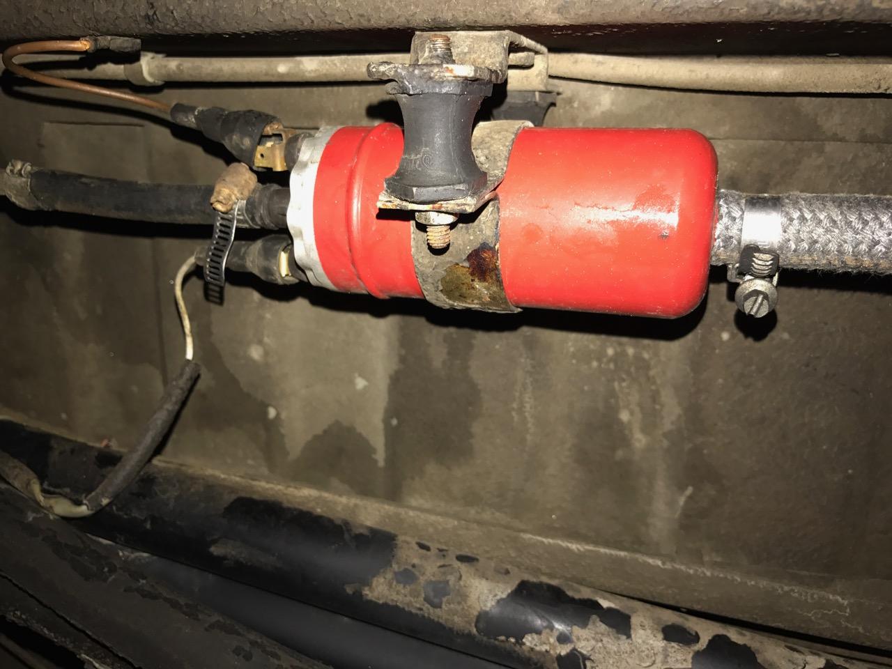

I believe the 84 westy i just bought has this pump, it looks just like it anyway. The pump works fine but mine is SUPER NOISY! Has anyone else had this issue with this pump? I am upgrading to the late model steel fuel filter and removing the plastic square pre-filter.

In my experience, the square plastic filter will cause a lot more pump noise when it wants to be changed. Possibly your 'upgrade' will prove to be quieter.

ok, thanks, that's what I'm hoping too! Will let you guys know if this solves it.

A few months ago, there was a detailed thread for using the P-37 pump. I installed one today and the van will not start. I have two questions:
1.) Is the pump outlet on the same end as the electrical terminals?
2.) The P-37 had + and - signs at the terminals. I wired the minus to ground. Is that what you did.

Im contending with my fuel pump as we type. Just today I replaced the filter and cleaned the pump. Was still noisy until I blew air back into the tank. THen the entire system went silent.. Awesome. Like a dream come true.
The damn thing ran fine 35 years ago. Im pretty sure the debris in the tanks is responsible for a good deal of the noisy pumps we hear about.
yup - to ground. if you do it backwards your van wont start.
outlet is the smaller end. usually says out.
