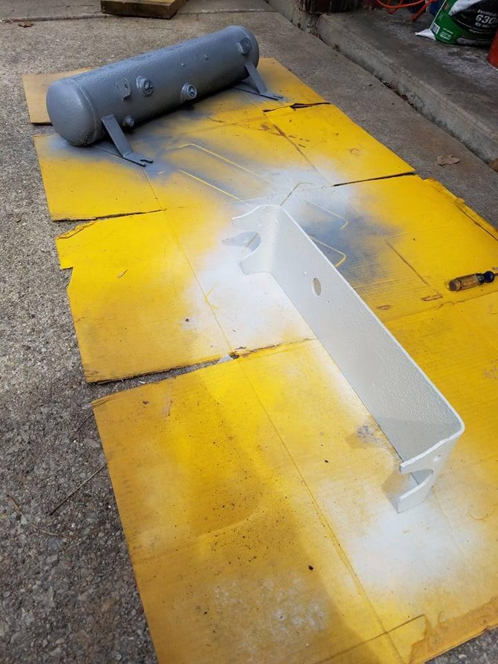

I've seen a bunch of propane tank valve or replacement posts here and on a couple of FB pages. Figured I'd update this post with a how to.
All in with parts, paint, primer, rust converter and wire brush attachments for the drill, I think this project was about $60 and a weekend. Maybe a total of 4-5 hrs of labor. Most of that is in the wire brushing and sanding.
If you're only replacing the problematic auto fill system without paint or regulator this is literally a $20 project that can be done on the van.
Will this paint job look pretty like a powder coated one for 10 years? No...but I didn't really care about that. I care about having a mechanically sound, non leaking tank refurb for a reasonable DIY cost.
Bleeder Valve:
https://centuryfuelproducts.com/3165cp
Fill Valve:
https://centuryfuelproducts.com/rego-7647sc-filler-valve

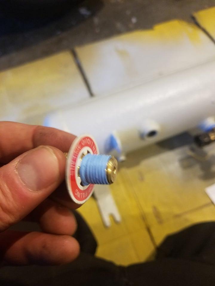

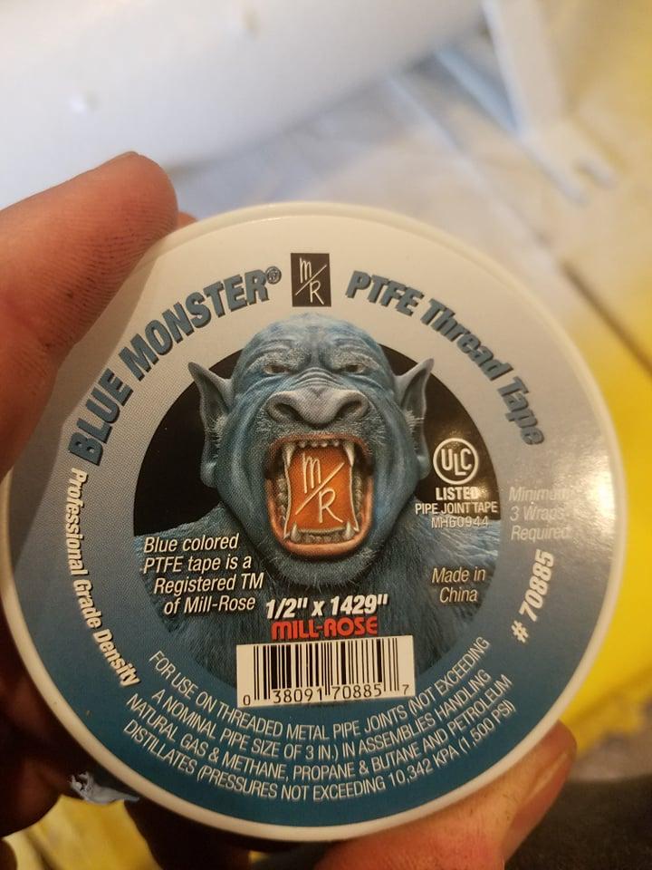

Make sure you use liquid fuel rates PTFE Thread tape. You can get it at any hardware store or here:
https://www.amazon.com/Mill-Rose-70885-Monster-Sealant-1429-Inches/dp/B009YA09D0
If you need a new regulator, you can get them from several Vanagon / Westfalia specific vendors. I recommend BusDepot.com over GoWesty
https://www.busdepot.com/253070604
Refurbish is a pretty easy job once you get past the potential explosion factor. Laughing

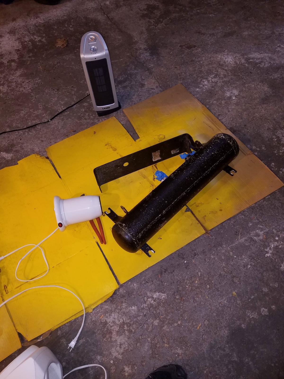

Remove then empty your tank by what ever means you feel is safe. I've heard others just letting their stove burners run till empty. I removed mine and hooked it up to a propane garage heater I have and let it burn while I did a couple other projects.

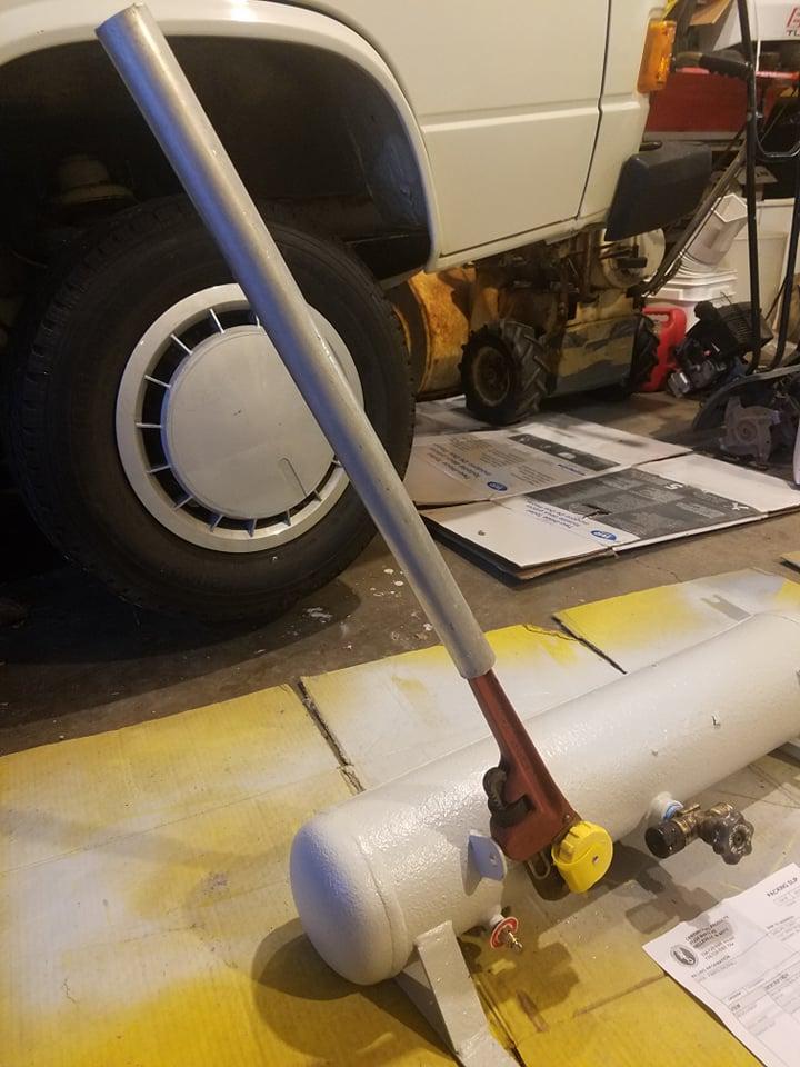

Disassemble and let it breath overnight. It took a breaker bar and then some to get the valves out. (See example pic below.)
Plug the valve holes and sand, grind, wire brush it till your happy. I didn't remove 100% of the rust. Wash with isopropyl alcohol to get rid of dust etc.
Then I used a brush on rust converter product and coated the tank with about 3 applications. Let dry overnight.
Used a self etching spray on primer next. 3-4 coats. Let dry overnight again. (Grey in the pic below.)
Then used a standard farm implement spray on paint. (White in the pic below.)
After that I blew out the tank with compressed air just in case I got any particles in there. Put on the old regulator with new tape. I lightly cleaned up the regulator too as it's mostly made of brass.
Installed the new fill and purge valves with tape sealer and tightened them down. I don't have torque specs so don't ask. They're tight...real tight. Like pipe wrench tight.
