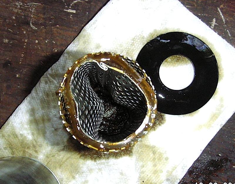

MsTaboo wrote:
So if the filter is not passing the oil it's just being bypassed by the relief valve right?
Engine oil filters have a relief valve because the flow is the first concern at high RPM and the cleanliness comes second. So if you never change the filter and it plugs up, the bypass buys you more engine time. Its killing your engine very slowly by contamination vs killing it instantly by spinning a bearing.
If some oil is going thru the relief valve, the balance is still getting filtered (at some time it becomes 100% bypass). Bypass doesn’t open until high rpm flow overwhelms the filter capacity, thus a high resistant filter still cleans oil at lower rpms for a period.
The Canton 8micron filter has no relief valve. The guy didn’t want to say its OK for gear oil cuz he doesn’t know. I haven’t tested it, to be honest I’m relying on Samba member PCForno.
The one thing I don’t like about the Canton 8micron is the flow is from inside to outside. Consequently you can’t inspect it easily. You have to cut it open.
I think I recall that member PCForno was stuffing his gear oil thru it backwards “outside to in”. Maybe he will chime in???

If there is an 8 micron filter after the pump, wouldn't the 240 micron one be redundant? I guess it'd catch big stuff and keep the other one clean? Just seems like we'd be adding a lot of piping and connections where leaks could happen.
The kind of chunks I've seen could easily ruin an oil pump. A pre-filter is a must for my system.
Perhaps inside to outside flow is a good thing when there's no by-pass valve ..

Ok that’s a “bypass” Shocked
But I doubt 18 psi (??) of an electric pump can deform the metal caged Canton filter. This oiling system is supplemental, not critical; like on an engine that will spin a bearing if the engine oil stops at high RPM.
If transaxle oil stops, the worst that happens is you revert to splash oiling, which can work OK....for a while .... often a long while ... like 150k miles, 225k and more (with a WBX). Wink

Sodo wrote:

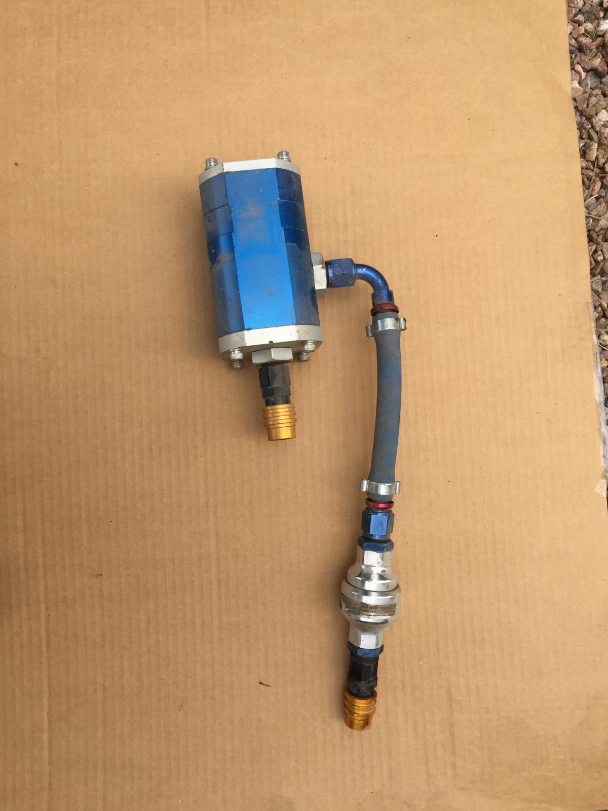

I run mine from the inside of the filter to the outside. iirc, this is the recommended direction of flow from the manufacturer. The filter medium is certainly not too restrictive - I get a good rate of flow - haven’t measured it in GPM - but it’s pretty fast through the filter.
In the attached picture below, the oil goes from filter to the Magnom filter, then to the cooler, then gets squirted on 4th gear/MS bearing interface (the infamous divet on the intermediate housing)

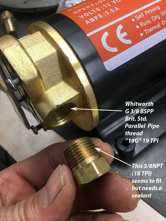

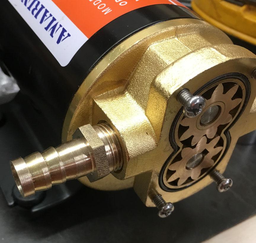

Well I don’t know if I have all the part numbers and what not, but I have an adaptor from the transaxle drain, going to 8AN compatible tubing, to the eBay version of the weddle pump (turbowerks pump - the large one) - to the filter setup you see (canton 8 micron with a Magnom mini - they have quick release AN fittings so you can take them off and inspect them) to a large-ish Derale oil cooler, back to the transaxle where I’ve drilled a port above the fill hole, aimed at MS bearing.
The tubing and AN fittings as well as the adaptors to screw into the drain hole and back into the transaxle are all available at Pegasus auto racing.
I don’t know the thread sizes off hand - there’s been a bunch of threads detailing pretty much all the info to make one of these setups, including where I’ve done the return tubing. - I’m not trying to be evasive, I just don’t have a handy list of all the parts, but they’re easy enough to start piecing together once you’ve got the general idea -

Amazon has a similar two stage filter for 65. 25-118 Billet Aluminum CM Oil Filter 6" In-Line Super Twin Stage 9" Long. It’s bigger.
https://www.cantonracingproducts.com/canton-25-118...9-in-long/
Same 8 microns plus stainless screen. Would this go before the pump? Or is it best practices to put a filter after the pump?

I can’t think of a real benefit to use that 2-stage.

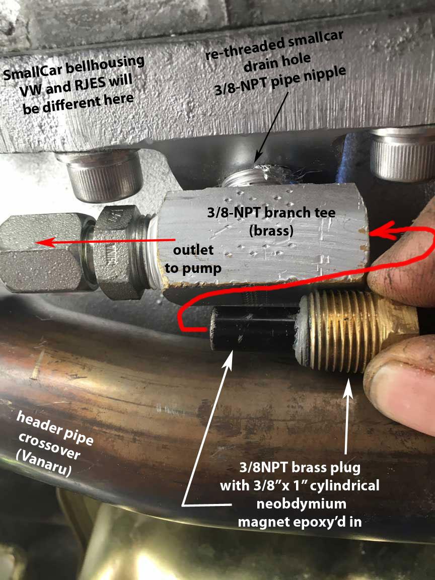

Im using a big neodymium magnet at my drain, which will catch bigger particles out of the oil, hopefully protecting the pump. A bug screen can go before the pump, being less likely to cause cavitation on the suction side.
But a filter with high back pressure like 8 microns needs go after the pump, on the pressure side, where the pressure (~18psi) pushes the oil thru. I doubt you could suck gear oil through an 8 micron filter anyway. I bet it would never start pumping. But someone can try it Wink
Keep in mind your oil is going to be generally “clean” from now on. The pump is not working in sludge because the system has been incrementally removing the crud.
Most of the steel crud is already sequestered in your filter. The only crud coming through the pump is the seldom steel particle coming off a gear or whatever, that you will catch & hold cuz you don’t want it circulating the trans 10,000 times (& making more crud-babies out there).

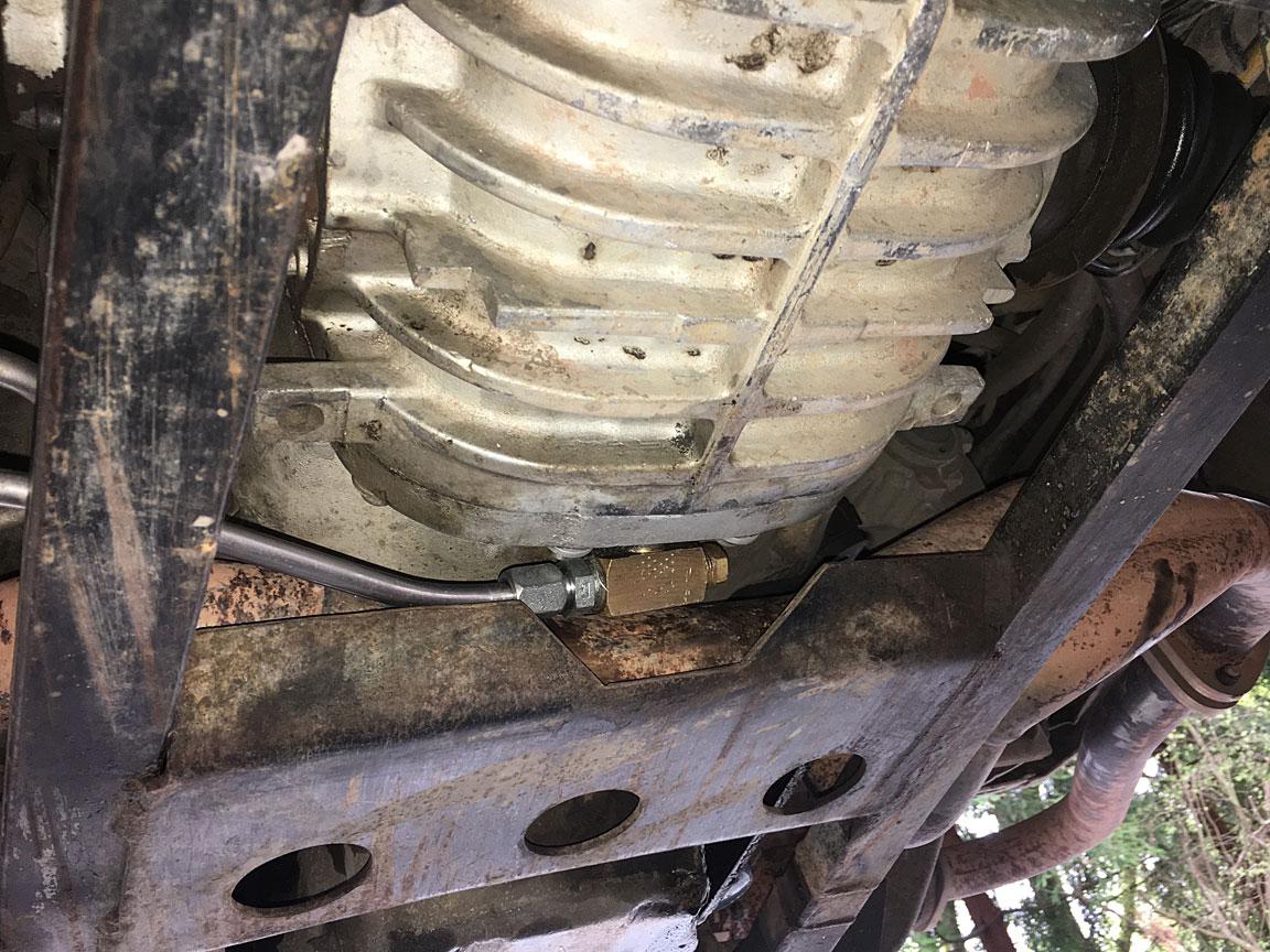

Pictures of the modified skid plate frame for drain fitting clearance on a syncro would be helpful. I saw a single pic in Sodo's gallery. It would be nice to be able to drain without having to drop the ladder/skid tray each time.

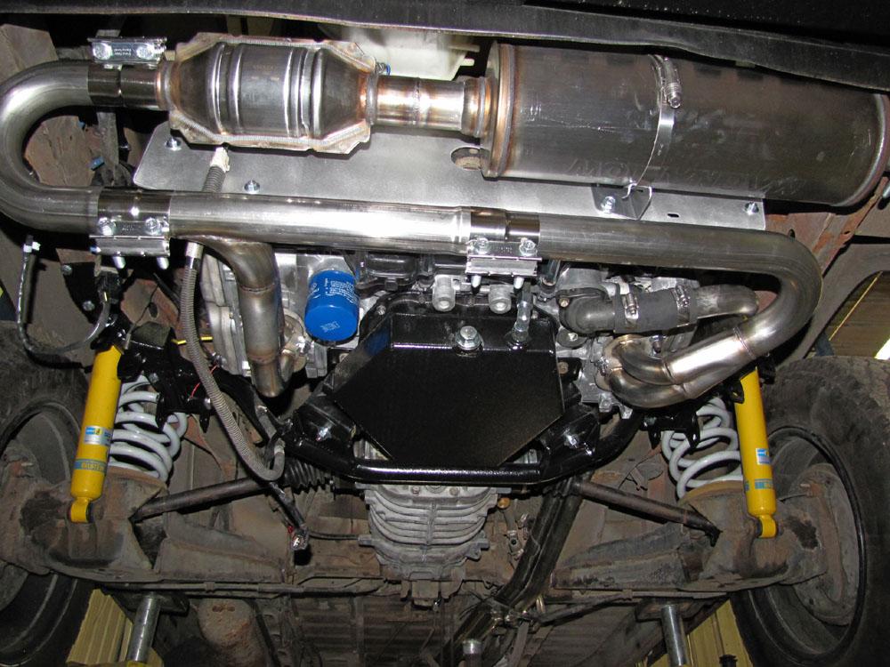

Our EJ22 was installed a while back (2 owners before us) with a KEP setup. We learned a few things from this setup (this will relate to transmissions, I swear):
- The engine carrier was supposedly designed to hold the engine a couple inches higher to compensate for the Subaru's low hanging oil pan. We have the Small Car Performance pan so it's not too much of an issue.
- The KEP setup has its own heat shield and engine mounted muffler bracket. However ours never came with these and the shop we had used to rebuild our engine had welded the new muffler to a self-made bracket attached to the engine. That weld cracked the exhaust shell of course... The exhaust was already loud in the first place, now it's even louder.
- The KEP exhaust manifold goes from the exhaust ports to the back of the engine (front of the van), passes right in front of the transmission drain plug and comes back around the engine. This makes reaching the transmission drain plug a royal PIA and probably heats up that transmission oil more than it needs to.
That last point was a motivation for us to upgrade that system, now that we have a jewel of a transaxle. Therefore we ordered the RMW exhaust manifold system from Van-Cafe, which is all routed toward the back of the van.
KEP style (image from www.buslab.com):
RMW style (image from human_compass I believe):
And since our muffler was loud and is now cracked, we figured we might as well get their stealth muffler. However, this won't fit quite right with the KEP engine carrier, which holds the engine a couple inches higher than stock (which also jams our air filter onto the engine bay lid). The engine carrier would need to have shims to lower the assembly. So we might as well order the RMW EJ22 engine carrier too while we're at it. And of course everything else that goes with it: heat shield, exhaust manifold gasket, exhaust brackets and 2" tailpipe kit.

Here's what my drain tee looks like. I re-tapped the Smallcar bellhousing from M14x1.5 to 3/8NPT. Screwed in a "close nipple" and then screwed on the brass block tee. Which has a magnetic plug in one side, and the oil outlet on the other side.
Oil to my pump goes past this honkin' 3/8" diameter neodymium magnet.
No chunks will get to the pump, but plenty of small stuff passes right by in the stream of oil.
PS An FYI for Smallcar folks, Smallcar bellhousings started out 3/8 NPT, then M14 x1.5 and currently M18x1.5.

For draining do you just remove the 3/8 plug and drain from there? It looks like you have trimmed enough room to do that with the skid plate still in place. Smart. Dropping that big boy down is a pain.
Steve
Steve's 87 Syncro project
Sodo
Joined: July 06, 2007
Posts: 8507
Location: Western WA
Sodo is offline
PostPosted: Tue Apr 16, 2019 3:21 pm    Post subject: Re: Syncro rattle grinding whine noise. Bad VC, transaxle, diff? Reply with quote
Yes it would drain but I’ve never done it. I’ve removed the plug just to look at the magnet several times. I turn the pump on then unscrew the plug and it sucks air in the drain hole. Air gurgles in and only a tiny bit of oil comes out.
To change the oil I pump it out with the 12v Weddle pump. Don’t need to drop the bad boy for that. Wink

Someone needs to test these $63 pumps on Amazon:
Heavy Duty Rear Mount Oil Gear Pump 12V DC 3.2 GPM Scavenge
https://www.amazon.com/dp/B01H1OAUIY
I would NOT be surprised if the Weddle pump is the same one (with a "cooling fins" wrap). The Weddle pump doesn't get hot so maybe the cooling fins are just bling. Get 8AN fittings for it.
OK I got one. Currently looking it over and here are some notes.
Brass gears. Looks good.
The fittings are kinda junk. It has Whitworth BSPP (parallel) threads. They are 19 threads per inch.
A US version 3/8NPT is 18 threads per inch. Strange thing is,,, the 3/8NPT fits better than the fittings supplied which bottom out, loose and wobbly. Whereas the 3/8NPT screws in aout 2/3 deep and then tightens against the NPT taper. So with some Permatex Ultra-Gray 3/8NPT fittings are good. I'd get 3/8NPT-8AN fittings.
Performance. This thing pumps more than the Weddle pump. That's a decent stream of water shooting 4 feet horizontal, and 35 inches vertical. Which is NOT necessary, the weddle pump is 2 GPM and exchanges the entire transaxle capacity twice per minute. This one might change it 3.7x per minute, which wouldn't hurt, but it's not necessary.
You can imagine it would wet down some gears!
But it will be pushing heavy gear oil thru a filter, so it won't pump as much as with water.
They specify duty cycle rating of "30 minutes". I can't even guess what that "30 minutes means" with regards to the suitability. What I would do is run it continuously at the pressure and viscosity of the environment it will be used. Which is pushing warm gear oil thru an 8 micron filter. If the motor gets hot after 30 minutes, then the 30-minute rating should be heeded I suppose. If it doesn't get hot, in this specific environment, then I wouldn't worry about it.
Its quite a bit louder than the Weddle.
Anyway at $60 you could buy a spare in case it craps out.

PostPosted: Fri Apr 26, 2019 4:13 am    Post subject: Re: Syncro rattle grinding whine noise. Bad VC, transaxle, diff? Reply with quote
I’m pretty sure the duty cycle rating is saying 30 minutes at full tilt. Then it needs to rest. I expect pump temp will be quite high pumping transmission fluid. Average temp 175 F to 210 F would not be uncommon. The cheaper pumps are designed to cycle on and off via a temp switch and relay.
In racing I have found by the time the temp switch turns the pump on, it’s too late to get temp under control. Pump and cooler need to be working prior to passing desired temp point. I’m using my ECU to run the pump now.
Yeah it's nebulous trying to attach a "30 minute duty cycle" to a dynamic system of multiple dimensions. So if you run it at full-tilt for 29 minutes, does it have a lifetime of forever? ---<Silly question especially for a $60 pump, but illustrates the point. I suspect the "30 minute" is totally arbitrary, a different way of stating that "this $60 pump is not rated for continuous duty" for those who would beat them up in the reviews.
A transaxle does not really have a desired operating temp. For example an engine which should be kept at ~185°F. Using a programmable temp switch ($16) you can simply choose a low temperature that starts the pump sooner. I first chose 150°F because Lubrication Engineers guy told me 150°F was "ideal for the oil". I then reduced to 142°F simply because at 150° it rarely turned on, and (as my system is with a single loop) filtration was too seldom. There are lots of variables. I'm in the PNW it could be different in southern California.
Another way is to run it on a timer, to filter, (--->bypassing the cooler) for one minute every ten. I bought the MOCAL thermostat-diverter that routes oil thru the cooler ONLY if it exceeds 150°F but I have not plumbed it yet. I believe member Jalan has done this.
BTW.... I think members will be interested how you are using your ECU to run the pump. Wink
