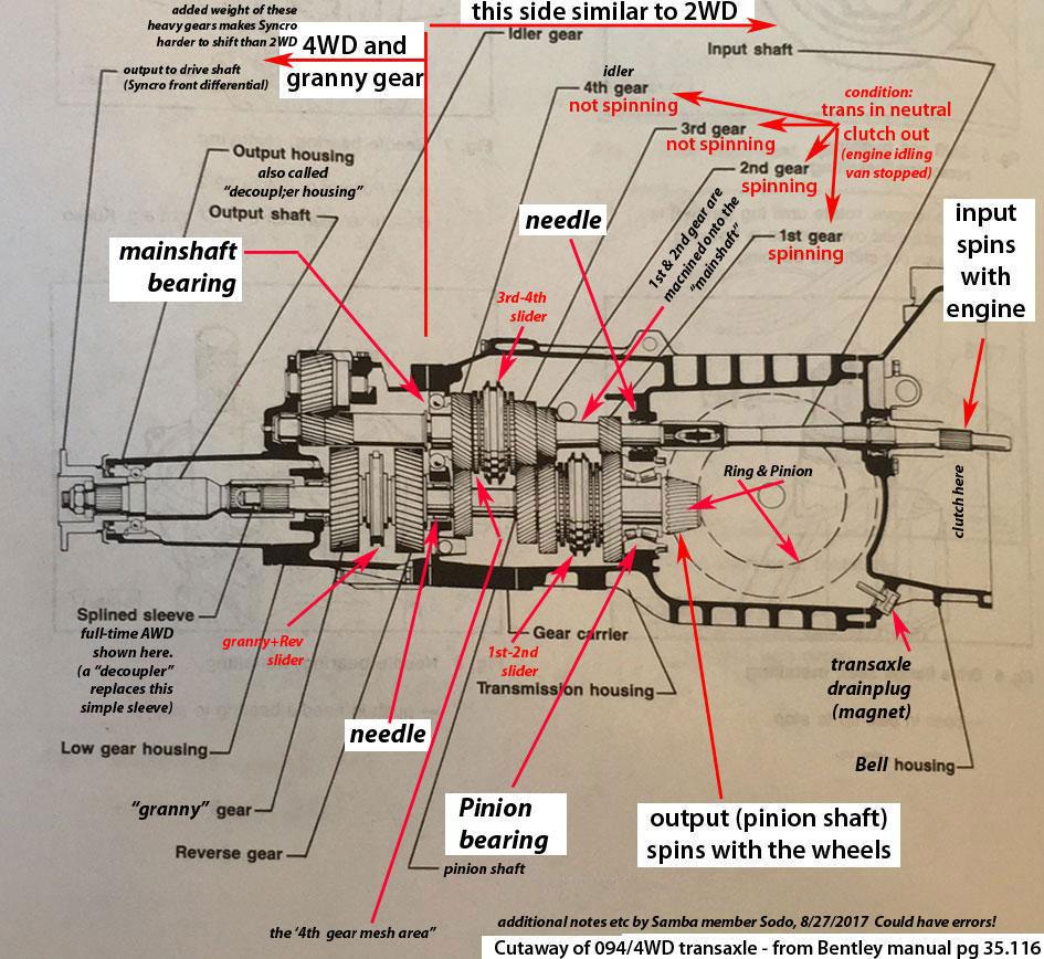

Apologies to Waldi for the headache medications this may require, but,,,, And for typing a book to read on your iphone....
What I would install BEFORE the first road test... Add 8 micron filtering to that expensive transaxle BEFORE it makes its first rotation.
You only have one opportunity to prevent all those new bearings from the “steel break-in trash” that will circulate thousands of times (denting the wonderful new bearings). You have the “extremely rare” opportunity to remove and capture this inevitable trash from the lubricant (almost) the moment it departs your new gears/R&P/shafts etc. BEFORE the same chunk goes thru your pinion bearing 1,000 times.
This ZERO Miles opportunity to break-in that transaxle for longest lifespan is one-time. “Soccer mom” didn’t have that opportunity and didn’t care when that van was new. But the trans was new and OEM clean PLUS she didn’t have the same problems you have (antiquity, $11,000 bill, NLA parts and (130/90=) +44% HP). Plus she didn’t have Sodo on her case Wink cuz back then,,,, Sodo was destroying transaxles without a care in the world (worried more about WBX headgaskets).
Think of your new pinion bearing (7 inch-lbs resistance set by mfr) like it is your child.
Here’s a diagram with the “pinion bearing” labeled. Its similar to a front wheel bearing except much bigger, and there’s no nut to set the preload. Preload is set by the bearing manufacturer to be mashed together by the pinion nut, set at "7 inch-lbs rotating resistance when new". After break-in it probably spins “free” in its normal state.
But during break-in, there is zero clearance (actually “negative”) thus any metal particles (even 1 micron) in your lubricant going through that beautiful new bearing puts dents in the races and rollers. Bigger particles = bigger dents. Note that if a perticle is "visible" like a sparkle in the sun, it's bigger than 5 microns. Anyway, break in trash is substantially bigger than 5 microns. Like 50 microns, 100 microns, so they make big dents. And those make more sparklies (which make even more small dents). Best to capture them at first opportunity.
As good as GTA is, they cannot compare to the cleanliness of an OEM assembler with a "clean-room" using 100% new parts never been soiled. And there's new trash from break-in of new parts too. Anyway, just wanted to make sure you understood the “opportunity that sits in front of you” (Your transaxle case plumbed for circulation/filtering).
You probably know I’ve built an elaborate electronic temperature-controlled cooling system which was big project and loads of fun too. But a conclusion (of some of us) that has emerged from all this is that a hot trans gets hot because of “additive problems”. Worn out bearings, big tires, too much HP, too heavy, too fast, 5.43 & 6.17, WHERE.....drumroll....metal in the lubricant (sparkles) increase friction thus heat, and each steel particle generates MORE steel particles. More contamination all the time, the longer you run that contaminated oil. (with big tires/engine/weight/lead foot etc).
Where one prime contributor - lubricant condition - stands out as a solvable problem. Or can be mitigated by "maintenance".
Get the sh** OUT of your lubricant.
Whereas the other problems, too heavy/fast/HP etc remain unsolvable. Wink
There's also the mainshaft bearing that takes the force of 4th gear. It is nice to preserve the mainshaft bearing because it sits high above the oil level and most of the miles are in 4th gear, at high speed, near the top of the engine's torque output curve.
Anyway I’d get a pump and a Canton Racing 8micron filter filtering your lubricant before the first drive and run continuously the first 1000 miles - or more miles. Controls and/or oil cooling can be added later. Maybe add a temperature guage, it’s possible that you don’t need cooling with 130HP and sensible driving.
Some will say "a transmission is designed for that trash".
This is correct.
So what's gonna wear the transaxle out, after you remove the contamination?
And if you don't let the lubricant degrade, oxidize, turn black?
Oil coolers and lubricant filter systems provide 500,000 to million-mile lifetimes for big trucks. We can do it too.

Another way to look at your situation.
First of all an EJ22 is not out of control (over-engining). Wink
Secondly you opted at significant expense already, to get all new, top quality gears, 100% !
Since you have all new bearings, gears, shafts, R&P your trans "should" break in then “run clean” for a long time. More like a new trans, right? They run a long time. There could be a long period where your trans, being all-new doesn't 'need' it. But it has to help some, to remove every particle quickly.
Your trans is not the same as the “rebuilt” that has a mix of new with some 300k parts. Which one of those old parts will start shedding metal after 20,000 miles, polluting the lubricant, taking down the bearings and starting that chain reaction of increasing pollution? An ongoing filtration system would reduce the bearing damage and "possibly" extend the life of a rebuilt.
Onoard filtration is another “system” to maintain. There is no "Bentley chapter" in your manual telling you or your mechanic how to maintain it. You must be the king of this mod (like an engine conversion).
======= so here's an idea to get over the 'break-in' hump ========
Maybe get the $63 pump, and a filter block and make a “garage dialysis machine” that you just attach in your garage periodically to purify your transaxle lubricant (without draining it). Filter "hot" when you get home from a drive. 5 minutes pumping is about 10x thru the filter. Can do it every day the first few hundred miles. If you choose a type of filter that you can look at, then when you notice the crud subsiding, you do it less, or even quit. The idea being that you get your more longevity at the 'far end' by reducing the break-in damage in the beginning.
Here's the "bathtub curve" from Lubrication Journal that can be analogous to self-generated lubricant pollution in a closed-system lubricated gearbox.
This makes it easier to discuss why filtration is more important in the beginning (new) and towards the end. And you can see how a MFR can build a gearbox for a good solid mid-range even if assaulted by the break-in trash. So if you remove the break-in trash, your midrange is extended. Right?
Its a different level of cleanliness, not on-going. It doesn't remove every “chunk” immediately,,, but you still can call it an “obsessive method”. It has to influence transaxle longevity.
Anyway, you can "probably increase longevity" somewhat for about $100.
And the other way..... $100 buys about six oil changes of FLAPS GL-5. You just keep it up, until no sparklies. Then you're smooth sailing in the middle of the bathtub. At that point you choose your specialty oil.
But of course I'd filter that thing to the gnat's testicle.... Laughing

Sodo wrote:
This makes a lot of sense. Shifting our viewpoint to consider this transmission as an "investment" is key. Whether filtering the break-in period gives use another 100,000 miles of use or just 50 miles, might as well be safe. The point being that, as is obvious, nobody has been able to directly and 100% link failures to a lack for filtering. However it would seem to be common sense (if "common sense" can even be used when talking about syncros) to filter out whatever could potentially damage this NLA and expensive piece of equipment, whether there is tangible proof or not of significant benefits (I believe it's beneficial and certainly can't hurt!).

MsTaboo that's interesting.....
Don't see a lot of transmission filter kits out there.
Note what the Driftmotion fellers say about filtering:
    We offer a special 240 micron filter designed specifically for thicker gear oils. It has a washable stainless steel filter element. A normal 100 micron filter designed for fuel will cause too much back pressure on the pump, and clog up much too quickly, which could overheat and damage the pump
Driftmotion needs to read Machinery Lubrication.
240 micron? 100 micron? Can you say "bug screen"?
Oil film thickness is appx 1/2 to 1 micron thick, for ball bearings. The "Machinery Lubrication" fellers recommend 3 microns for roller bearings and gears. 3 microns is difficult/expensive to attain. They say it's ideal to filter to less than oil film thickness, but that's almost impossible. The 8 micron filter from Canton is about the best I've seen.
But 240 or 100 micron? That's not a filter, mate.
Curious what kind of trouble that Mocal pump has pumping thru the 100 micron filter. I'm running a 10 micron filter, and the Weddle pump doesn't even get warm. If those guys are plugging their filter they should try filtering finer, so their trash doesn't generate even more trash.
"Theoretically"...... once the break-in trash is captured, and deleted, one filter element should last the lifetime of the transmission. Right?
......we don't know this (yet).
'90 Westy EJ25 F&R Peloquin TDBs, 3knobs, pressure-oiled, filtered, cooled gearbox
'87 Tintop w 47k, '12 SmallCar EJ25, cooled filtered gearbox
....KTMs, GasGas, SPOT mtb
