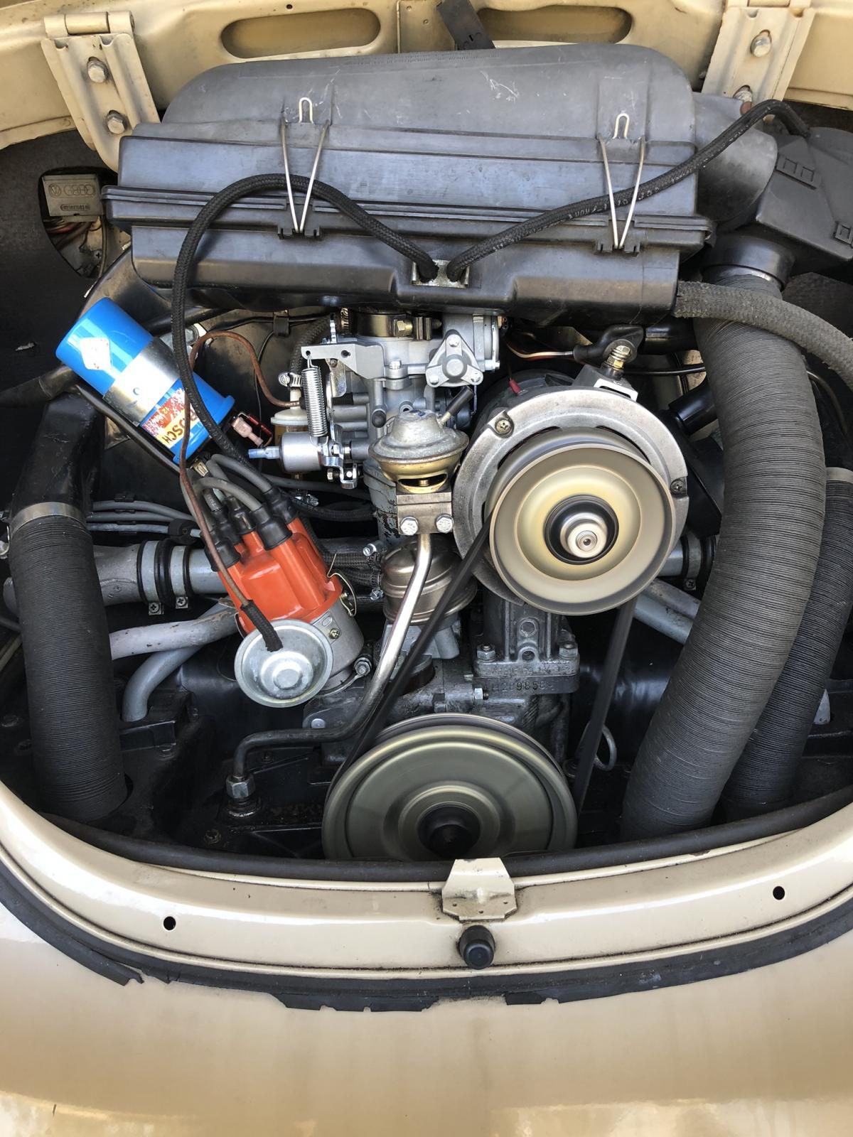

Rick, what brand and size belt are you running. It delves deeper into your pulley, so I’d like to get one like yours.
Also, I suspect that water is somehow getting into your engine, but I can’t figure out how that could be with your oil only being a week old, as well as your having a stock setup.

Where is the oil filler on that?
Are you running a thermostat and the flaps?

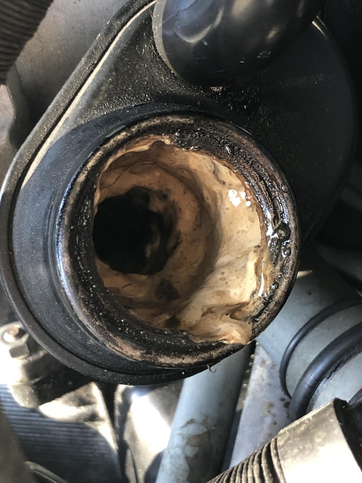

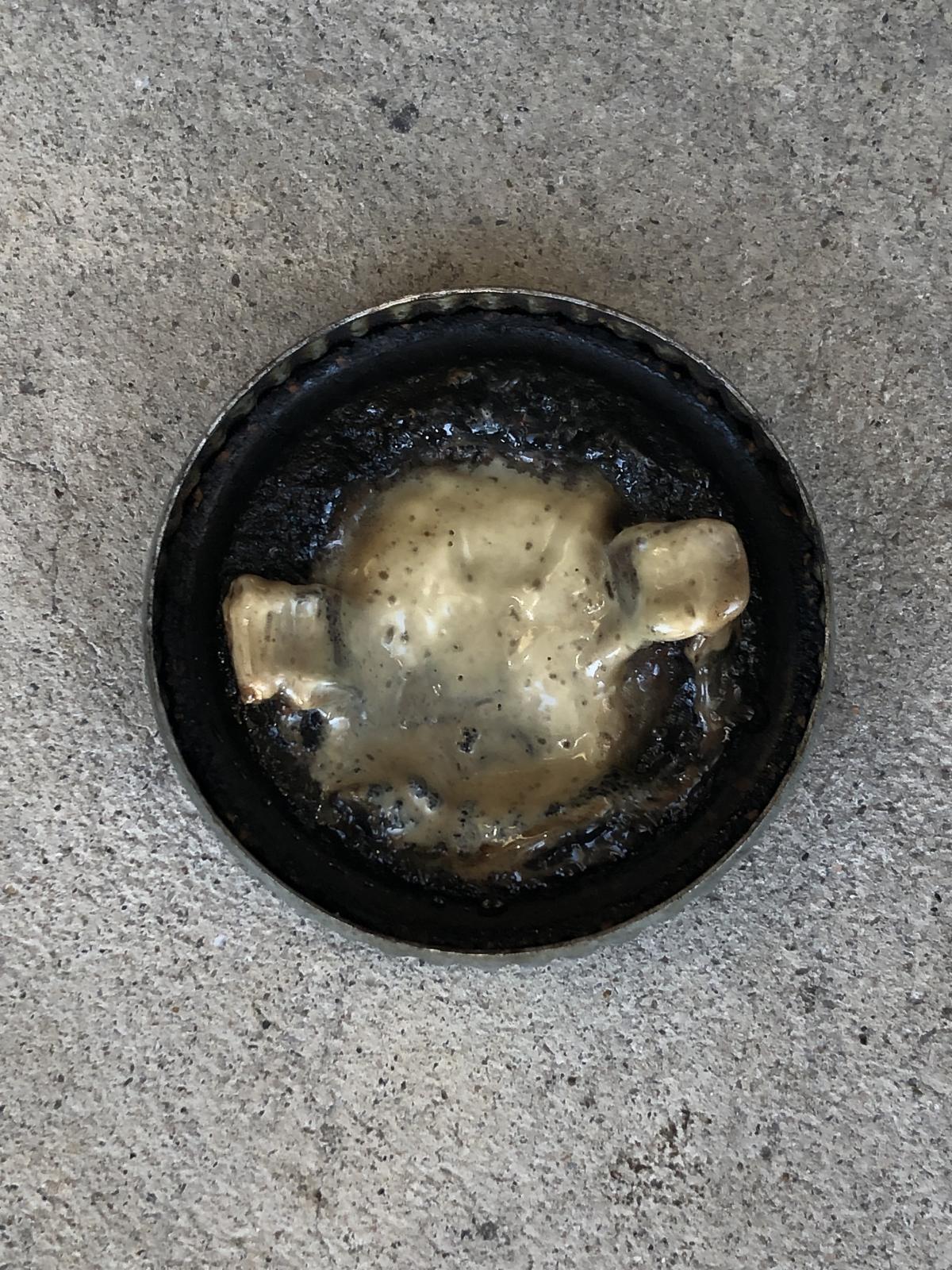

What color is the sludge?

I call it sludge, but it’s kind of a milky honey color. I’ll try to take a picture of it, but not sure if I’ll be able to get a good shot of the fill area but definitely can take cap off and get a shot of that.

PostPosted: Sun Mar 31, 2019 6:15 am    Post subject: Re: Oil fill and oil cap sludge Reply with quote
Moisture will make it a whitish or cream color.
Have you cleaned out the area and then recheck?

Oil fill at top of alternator stand and completely stock with breather in place.
Thermostat and flaps all in place and operational.

PostPosted: Sun Mar 31, 2019 6:27 am    Post subject: Re: Oil fill and oil cap sludge Reply with quote
This will fix your problem. The engine is not getting 'hot' enough to 'boil' out the moisture. Get a long stem cooking thermometer and put it down the dip stick tube and even after a long hard ride, the temp won't be over 170º. You'll need to get it up to over 212º to 'boil' the moisture out.

Ricksurfin wrote:
I have only been a member for about 15 minutes and already one of my questions has been addressed. The long-ish black air cleaner appears to be stock. I have the same one on my 1974 SB. Yours looks great (better than mine) and is inspiring. Not sure about the sludge as I am new to the VW thing, but I will be watching for the answers to come in.

PostPosted: Sun Mar 31, 2019 8:06 am    Post subject: Re: Oil fill and oil cap sludge Reply with quote
Here’s the pictures of what I’ve got going on.

PostPosted: Sun Mar 31, 2019 8:10 am    Post subject: Re: Oil fill and oil cap sludge Reply with quote
Don’t think I’d want my engine so hot that the heat would extend all the way up the oil fill tube to boil that out. Not sure if there’s a good answer to being able to drive that out. Might just have to clean it out periodically.
From the view of that picture I also see some cracking of the intake boot. I don’t have any symptoms of a vacuum leak but it’s going to be something I need to address before a problem arises.
