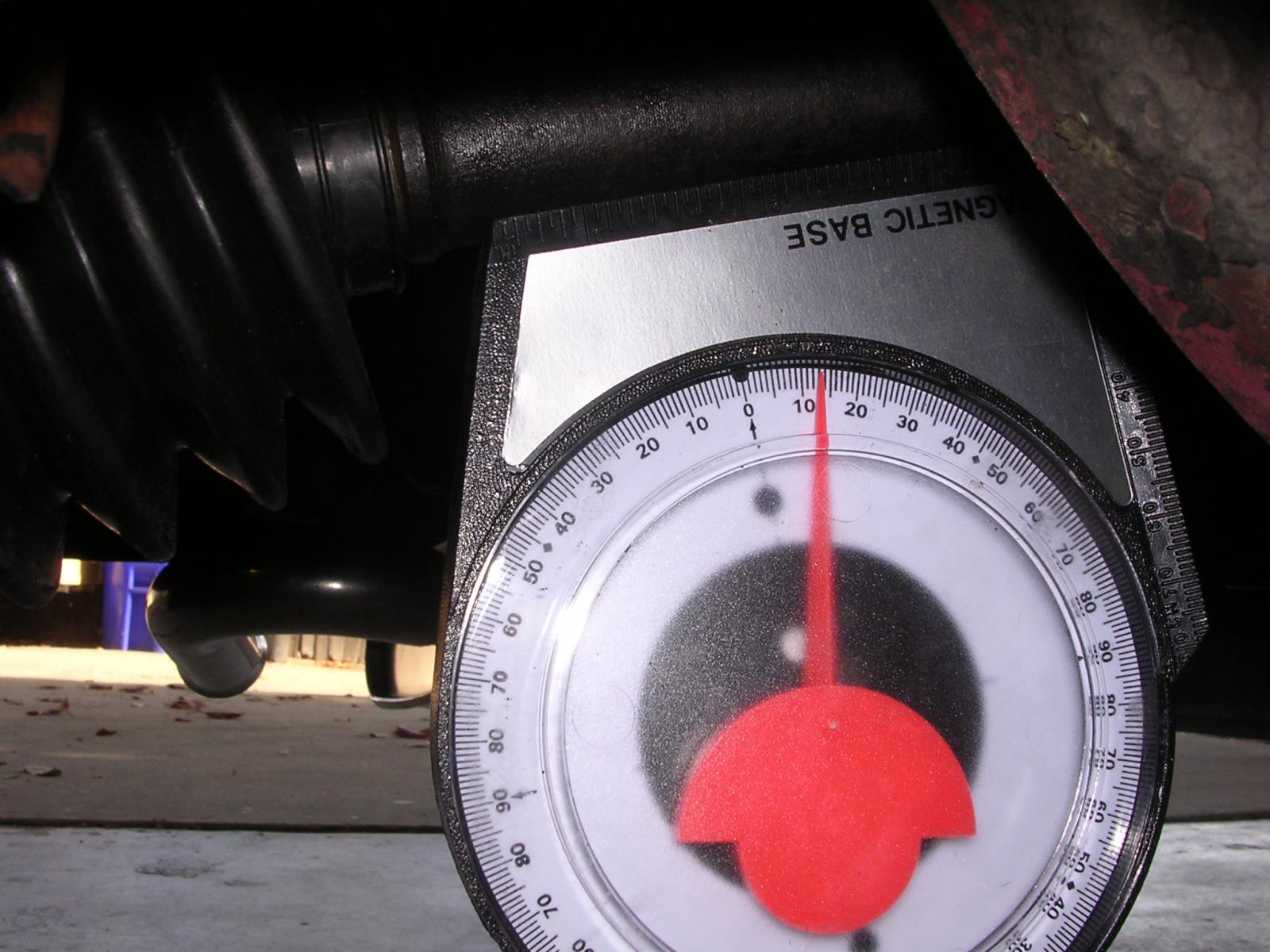

What’s the axle angle when it’s on the ground? A picture would be fine too. I’m interested in doing this.

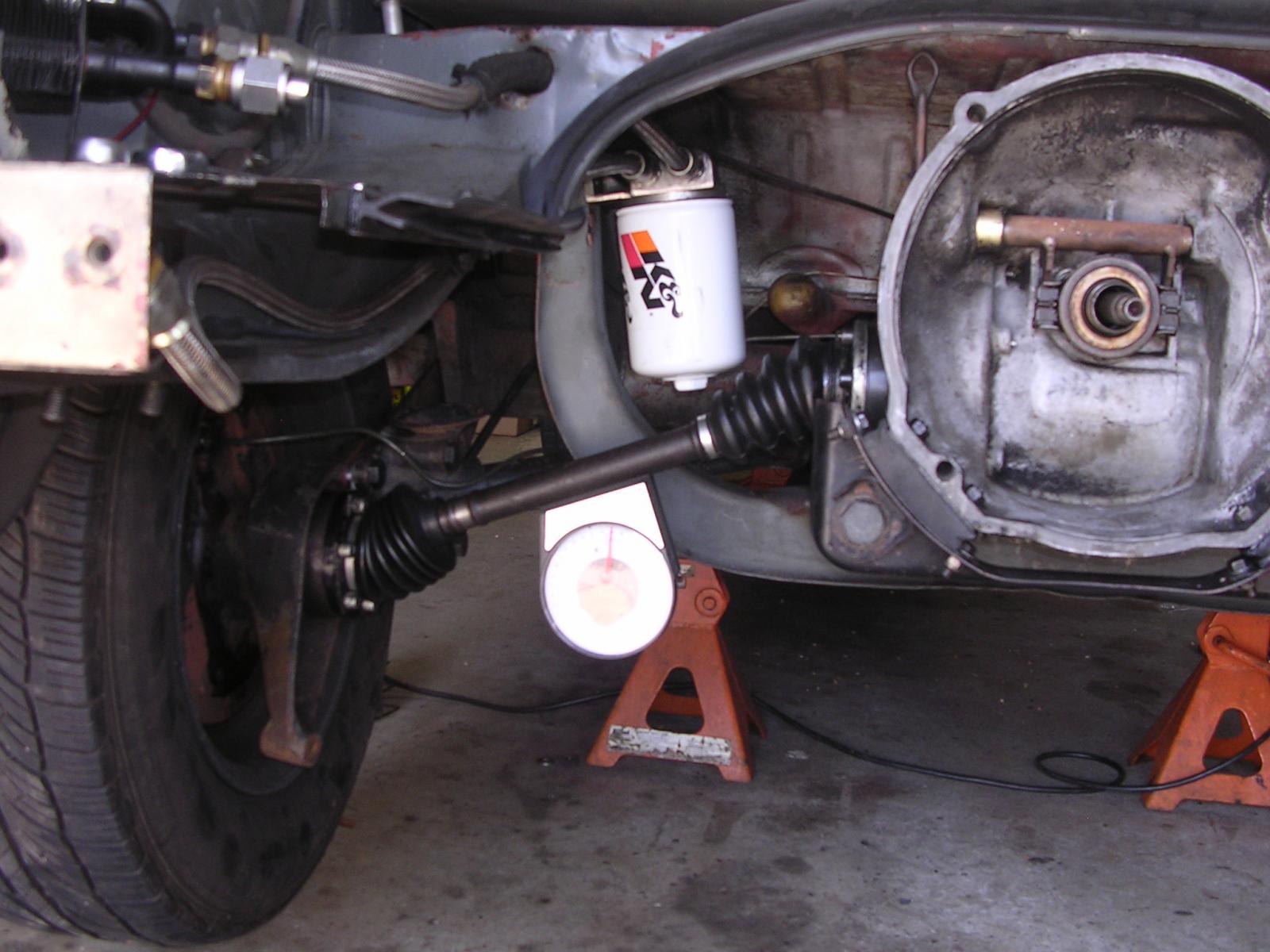

PostPosted: Fri Feb 07, 2025 5:22 pm    Post subject: Re: Stock height irs swap? Reply with quote
Check out my pictures. It’s not an easy bolt on affair. Some welding and machining work needs to be done. Cool
https://www.thesamba.com/vw/forum/album_search.php...t_dir=DESC
