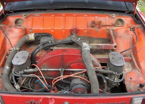

Yes it has been done before, but as others write: Dont do it!

my what was that guy thinking!!! So many waste valuable time butchering things.
