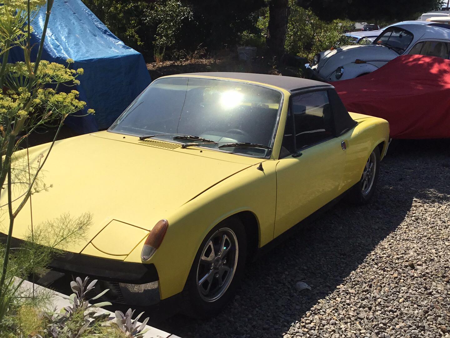

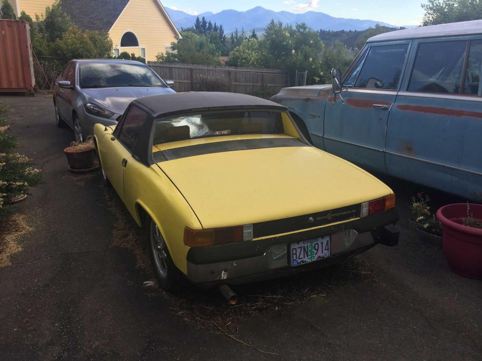

Have a list beginning. Mirrors at the top.
Motor’s got a noticeable exhaust leak. Most likely gonna pullit and substitute 2L that came from my wife’s 76. Only issue was the oil cooler leaking.
I’ll know more when I get that can or worms opened.
But, got her home and parked near the rest of the herd. She’d spent a couple days out in the street. That just wouldn’t do.
Took a moment and come polish and found some brightness beneath the oxidized paint. There’s hope there, yet.
