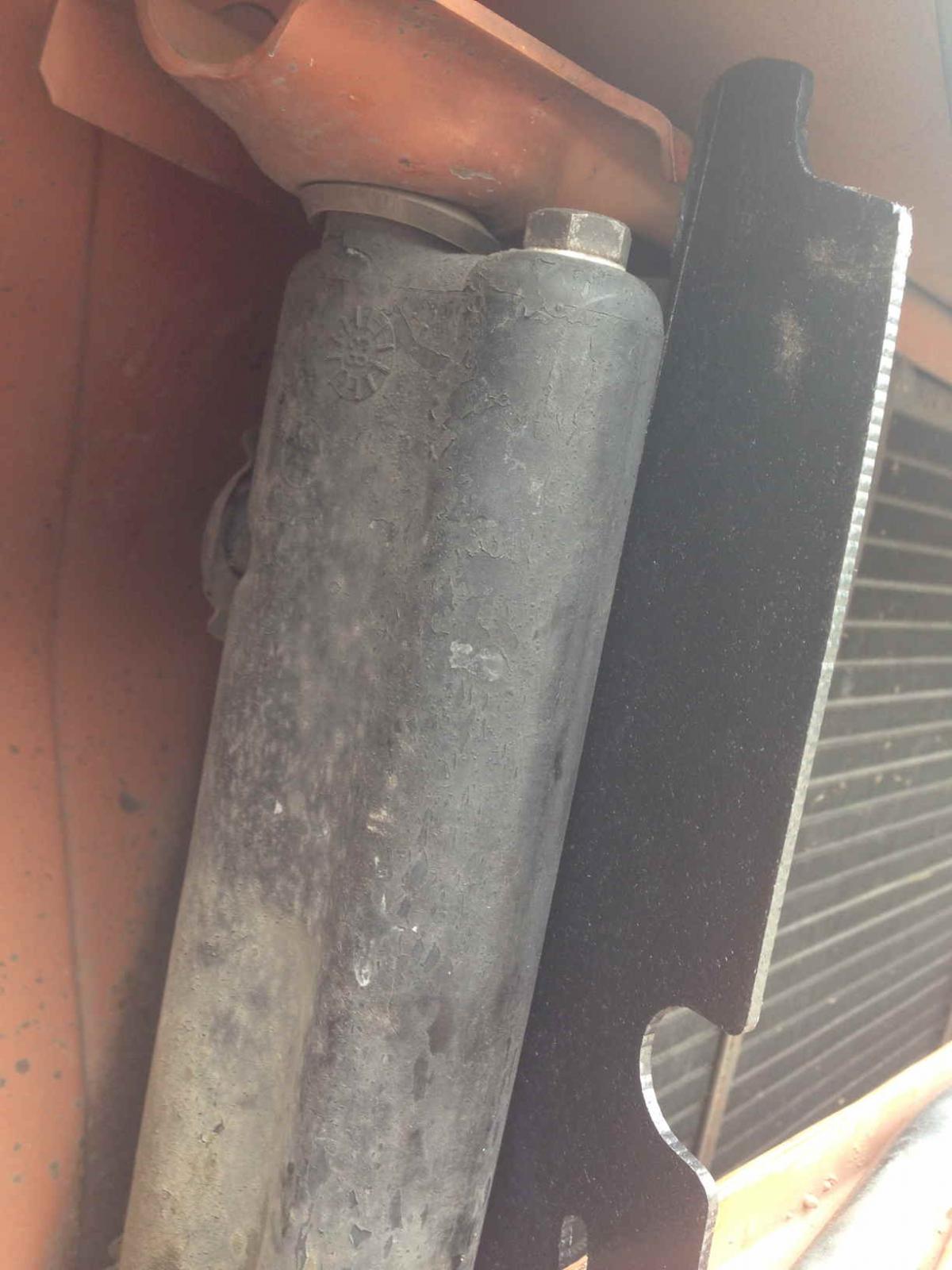

Pictured is the baffle on the passenger side lower, it was easy and turned out good:
I had to forcibly bend the plastic and tuck it into a groove between the radiator core and the tank. It may or may not stay there but I'll keep an eye on it. If I had not done this the flap would have covered too much of the radiator, in my opinion. This may be due to the larger radiator on the ’83 diesel, but I am not sure.

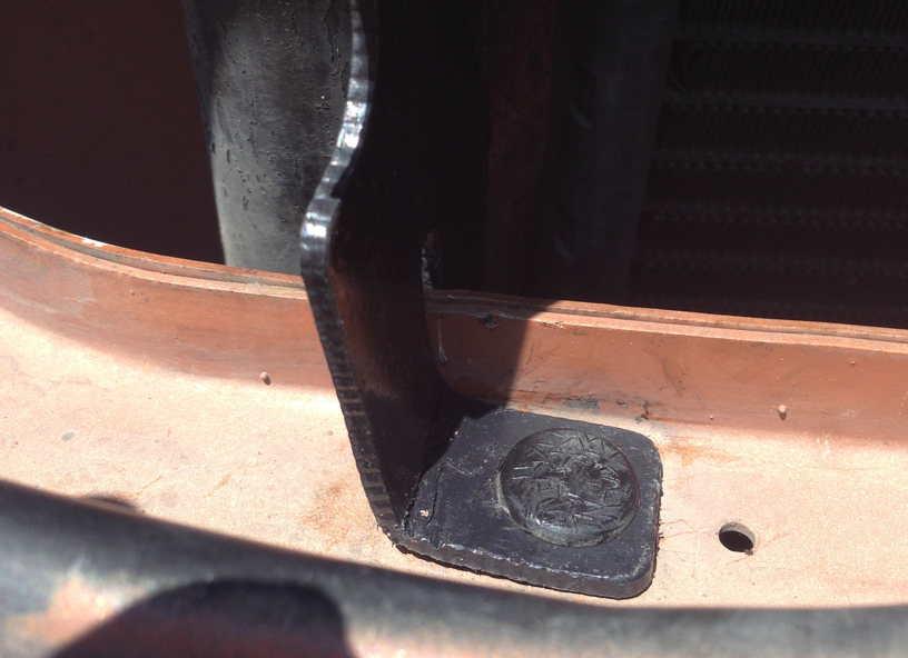

CAUTION! if you fasten the rivet tabs as they come from the factory you will damage them!
Notice the acute angle that applied too much tension on the rivet-downs and cracked the scored plastic at its fold. I then figured out what was wrong and bent the tabs the opposite way from how they came.
The plastic is not terribly flexible and is easily damaged by bending it too much. No instructions were included, so I naturally assumed they came from the factory with the tabs bent in the direction they are riveted down. DON’T MAKE THE MISTAKE I DID!
I then bent them them backwards, like this (passenger side):
The remains of the old paper baffle under the rivet told me that is how VW instlled the baffle too, the tabs were bend to the inside on the diesel.
GoWesty assured me that the exact same piece was installed on all watercooled models, so what gives? I believe that the high capacity radiator on the '83½ diesel has thicker side tanks and may have a larger surface area. The original fiberboard baffles were way more flexible than these plastic ones, so the same part was used despite their poor fit. The only difference being the direction the rivetdown tabs were bent upon installation.

Trim, adapt to fit properly would be the smartest thing to do.
I know they said it would fit all water cooled models--they obviously didn't take your diesel into consideration.
It's a make them fit kinda deal, or send them back and have nothing.
