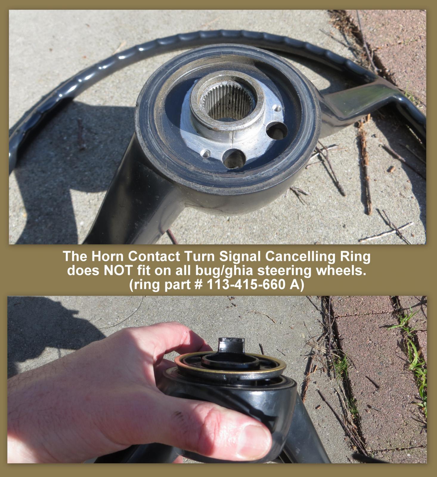

My cars left turn signal was working, when bought 3-4 months ago, but the automatic release(to indicate not turning anymore) doesn't work. I was told when the Momo steering wheel was put on they lost the auto release feature.

As far the turn signal releasing, I was told when they put the Momo wheel on they didn't have a specific part for it to work. Do you know what they were referencing?

The cancellation ring. It screws onto the bottom of the steering wheel and has a tab which directly interacts with the cams of the turn signal switch.
