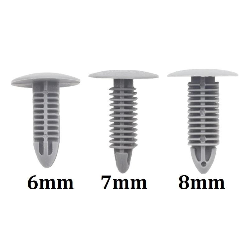

Easiest for now might be to stick a fastener into each hole

Like what Mr. Cusser has and add some silcon sealant.
