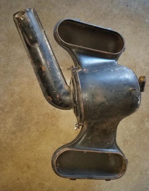

Hi all,
I have a 1971 911T with original 2.2 engine. I am trying to find an air cleaner box for it. I found an air cleaner box which has three round cutouts/holes (each side) to fit the carburetor cones as shown in first and second pictures. I also found some without the holes as shown in the third picture.
Do they all suppose to have cutouts?
Thanks all.

the holes are correct, the one without holes is for mechanical injection
