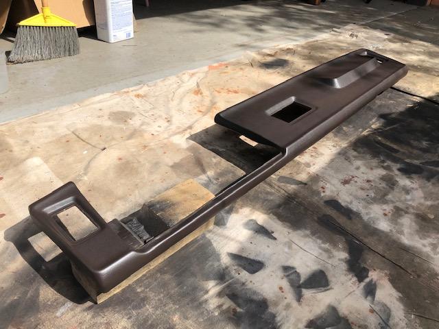

As an owner of a Westfalia with a brown interior mine has what almost all of these vans have, a dried and horribly cracked dash pad. I know some owners have opted to fill the cracks and recover their pads with vinyl. I decided to go a different route and paint a good black pad since they don't crack and are available at reasonable prices.
I've used vinyl paints before with great success and thought I could replicate the process on the pad. However when I painted seats, dash pads, consoles and other parts it was using a solid color, like black. The original brown dash pads are not a solid color but various shades of dark brown. By using a black pad I could use that color as a base and build up from there.
After cleaning it and using a vinyl paint prep I started with a light mist of Cordovan Brown from SEM. I then noticed that the black underneath was a little too faded to and would not let me start with an adequate base color. Luckily I had some Landau Black and misted a layer of that color on to to give me the dark base I wanted.

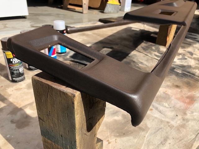

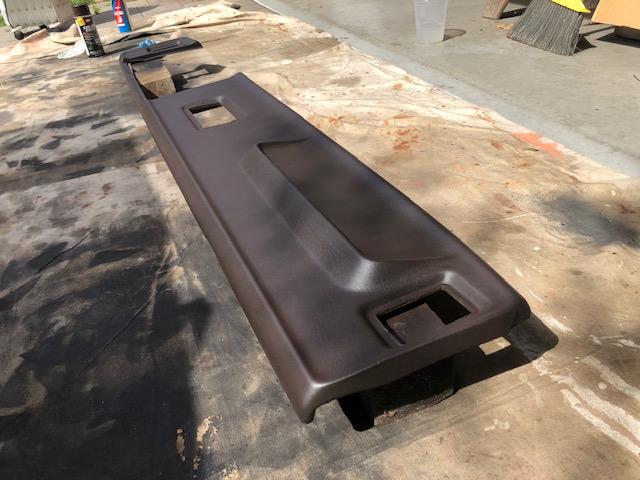

Now it was just a matter of putting three very light layers of Cordovan brown. The idea is to just put a light mist on each time so the paint droplets are very small and a little uneven. Also be sure to wait at least ten minutes per coat as per the cans instructions.
After the Cordovan Brown I switched to a lighter color - Bluebird Brown. Again I misted three coats of this color to create more depth. The last coat was slightly heavier in some spots but still trying to keep it random in depth.
I think the result looks great and was much easier then recovering.
