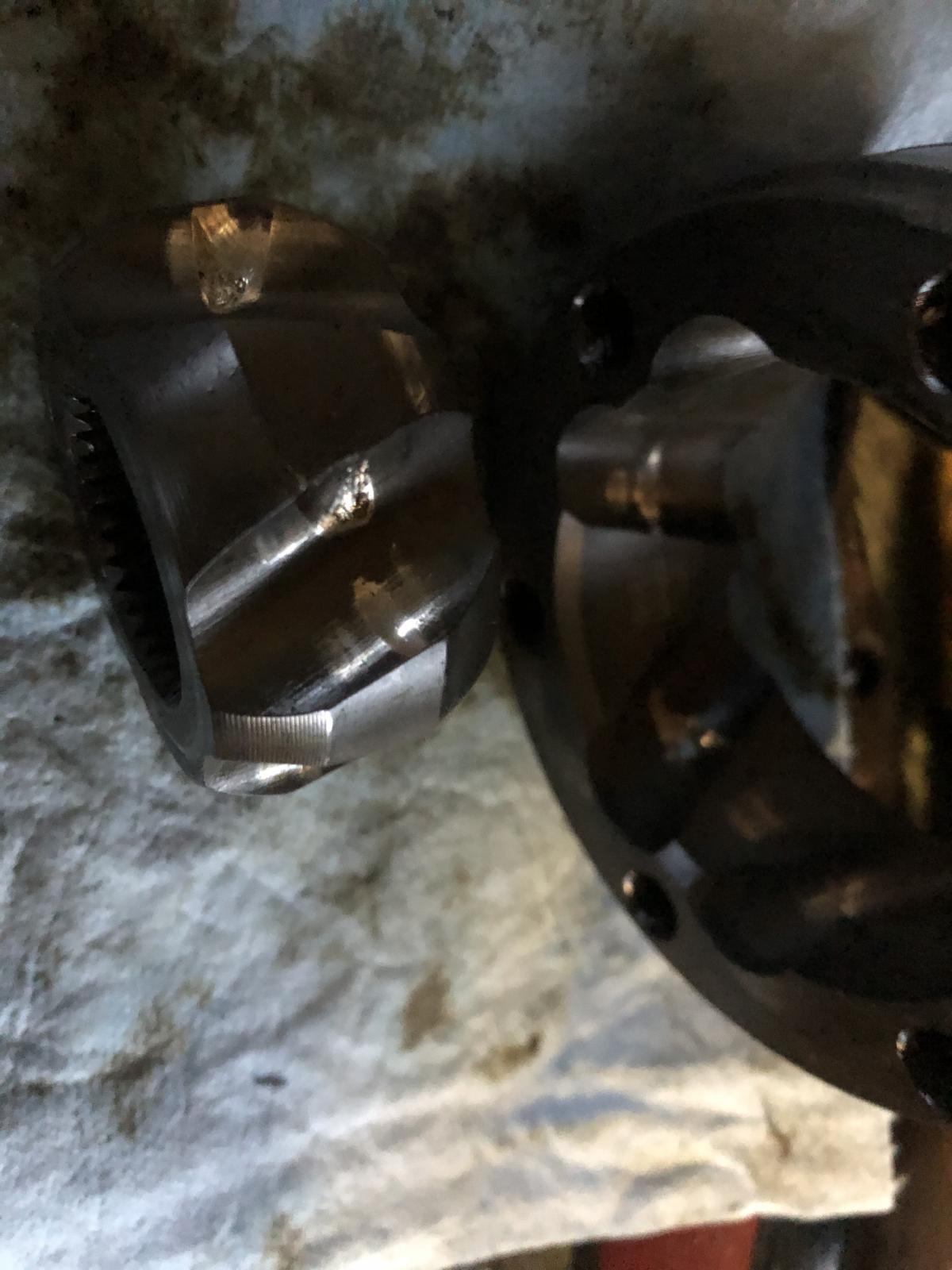

PostPosted: Wed Sep 23, 2020 4:56 pm    Post subject: Re: Left trans axel! Reply with quote
I know these large roller bearings can do OK with a little scoring but I think these need replacing?
73 Super Beetle outside bearing.
The grease was pretty dry on both outside ones. I haven’t gotten the Px bearing out yet..

PostPosted: Wed Sep 23, 2020 6:41 pm    Post subject: Re: Left trans axel! Reply with quote
Those are the CV joints...and they're badly worn. Replace them...probably easier and not any more expensive to just get assembled axles

PostPosted: Thu Sep 24, 2020 5:01 am    Post subject: Re: Left trans axel! Reply with quote
I agree replace!
