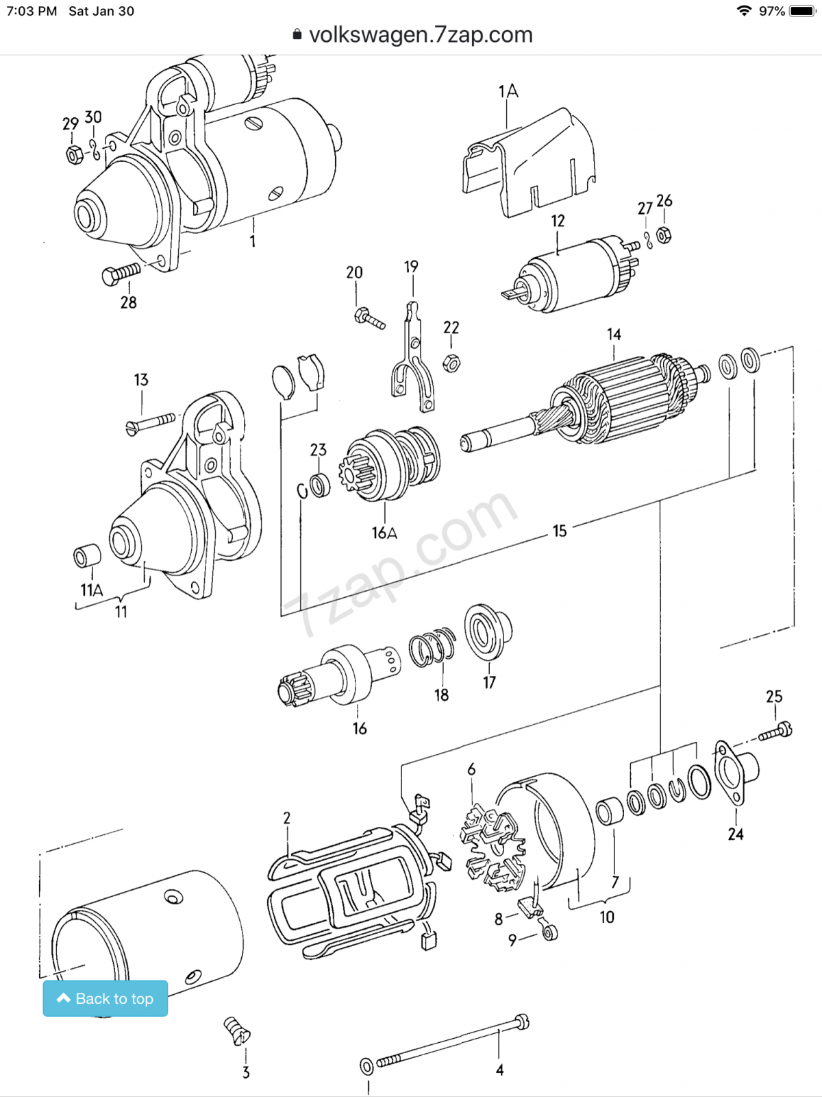

PostPosted: Sat Jan 30, 2021 5:13 pm    Post subject: Re: Faulty starter? Reply with quote
Parts schematic of generic starter, just start pulling bolts and screws .....

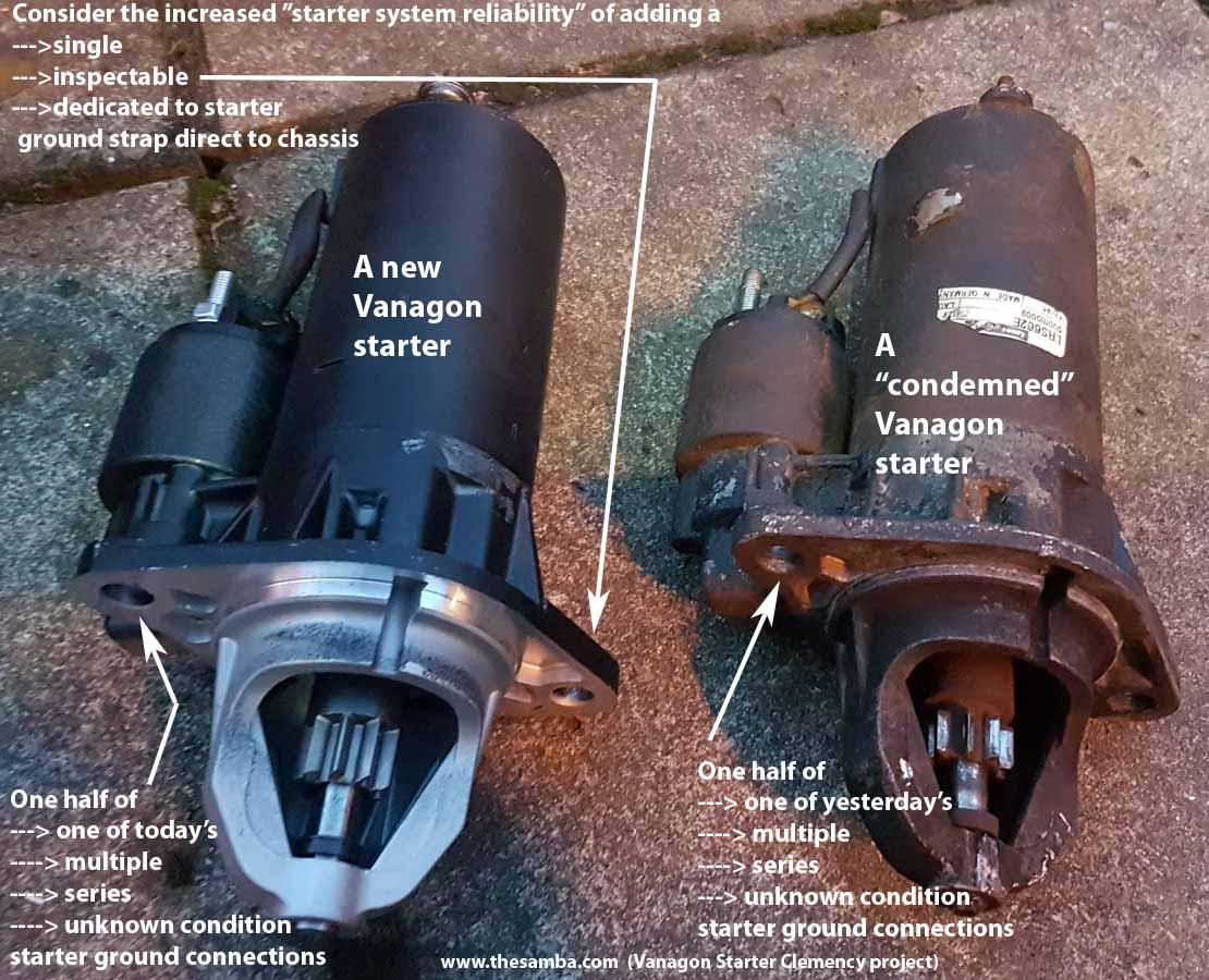

Sodo is online now
PostPosted: Sat Jan 30, 2021 8:03 pm    Post subject: Re: Faulty starter? Reply with quote
On some starters ( not sure which??) I think the armature rubs on the magnets if theres no bushing supporting the end.
Can you do a valid starter test if the armature is rubbing?
And this....
A built-in “starter failure point” on a 30-40 year-old Vanagon.
