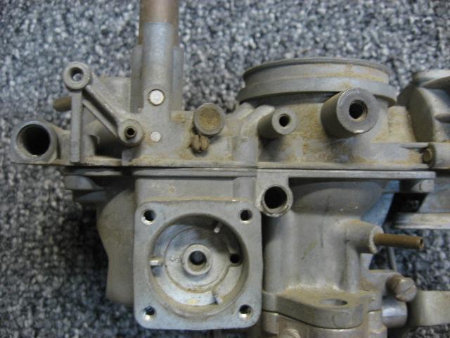

ive been working on a 72 asi bus
the gaskets on carbs have failed and so
Im planning on rebuilding some carbs out of the spare parts box
and just swap them out
I have several carbs and parts and really want to make sure
im installing correct complete 72 carbs
and not just follow the previous owner in making something work
here are some pics of the carbs that came on 72 bus
and here are some pics of the spares I have
carb #1
carb#1
notice the square on both sides ???
carb #2
carb#2

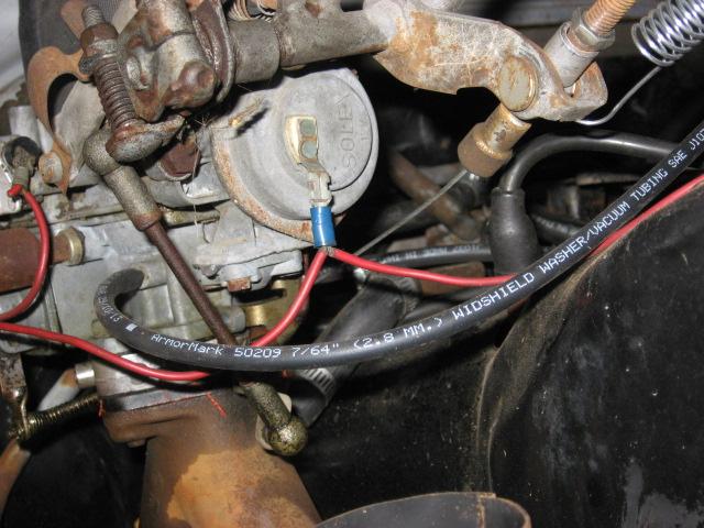

carb#2 looks the same as whats in the bus (except for the very bottom not pictured)
the pass side carbs I have look the same but the bottom is different on both ?
one of the carbs has the flat part that looks like something connects to it
the other carb has that bottom piece round
same gos for the driver side carbs
the one that looks the same as whats on the bus, has the bottom part
with the flat plate
while the one on bus has nothing
can you guys help me make sense of what makes 1 complete correct pair of 72 carb
ive read that 72 carbs are slightly different fron 73-74 carbs
but cant seam to figure out what to look for

Ha ha ha ha....., oh damn, now I've got to live up to a standard Embarassed Razz . I don't have a lot of literature in hand that matters on the early PDSIT's aside from some credible internet sources. Personally I haven't seen those throttle bodies with the flat spot on the side on unmolested 72's, quite a few on 73/74's and I suspect they were a superceded replacement part for all models. I have yet to see the flat spot actually used, it looks like a place for a bimetal valve of some sort that hasn't been fully machined like the fuel pump pads on FI engine cases.
My quick and dirty swap meet method for discerning early carbs from later ones is the holes in the throttle arms and the brackets for return springs, 73/74 used a short spring that was entirely contained on the carb, 72's originally (I think) had none but I've seen a few with springs down to the tin that I suspect were a dealer fix.

so that bottom flat piece just means
that the carb is probably from a 73-74 and has no function
'72 cross bar synchronizing is done with a screw on the left, later models are done on the right.
Bentley says pretty much the same thing

The rectangular deal on the throttle body is the mounting boss for a hot idle stabilizer that was used on automatic transmission buses so they wouldn't stall in the heat when you were in sitting in gear. Somebody just replaced their throttle body at some point in the carb's history and all replacement throttle bodies have those mountings cast in.
The square on the left carb cast near the central idling circuit is a vestigal organ that was superceded by the increasingly rare-to-find idle enrichment box found on some left side carbs the little box with an electrical spade connector on it.
These carburetors work beautifully when set up correctly, and you definitely like having that big ol stupid oil bath air cleaner to give you air filtration performance second to none.\

the first set of pics is the carb in my 72 right now
carb #1 and carb #2 are both driver side
and I want to use 1 of them to rebuild and replace carb currently in bus
the last pic with 2 carbs in it
are both pass side carbs (im assuming, please correct me if im wrong)
although the manifold is on backwards on 1 which makes me feel insecure
so in calling it vestige
it is ornamental and more than likely from a 73-74
the way im interrupting things right now is
unless the 72 was an automatic it should not have the flat part on throttle body
but if it does, its no big deal and there is nothing i have to cap off by having it
the extra square on the right side of the left carb
was a add-on to 73-74 carbs that was not very useful
so a proper 72 carb will not have this either
i think i see what busdaddy is talking about with the spring.....
i have a AW engine (core) that still has complete egr and smog pump installed and unmolested
the carbs on this engine have a extra little piece on bracket for a spring
both carbs have the flat part on throttle body
and the extra square on left carb
which means a correct 72 carb will have the smaller bracket without a spring
on the throttle
