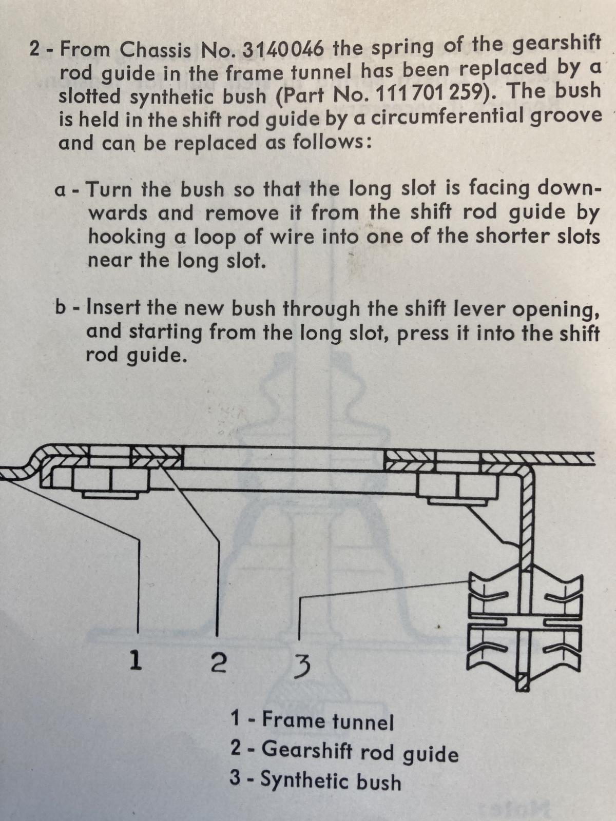

Kind of an old post.... but thought I would share my experience. I was having smooth shifting, but a squeaky shifting situation.... so I figured shift rod bushing...when I went to replace it, I noticed that there wasn’t an old one to replace... and the new one would not fit... checked the Bentley manual, and sure enough, up to a certain chassis number there is no bushing.... so anyway, I cleaned the shift rod and greased up the guide, works perfectly.... so in the future I’ll just need to grease that spot just behind the shifter... chocked that one up for experience.
calexican
Joined: June 11, 2008
Posts: 741
Location: El Paso, TX
calexican is offline
PostPosted: Sun Dec 20, 2020 10:17 am    Post subject: Re: Noisy Shifting Reply with quote

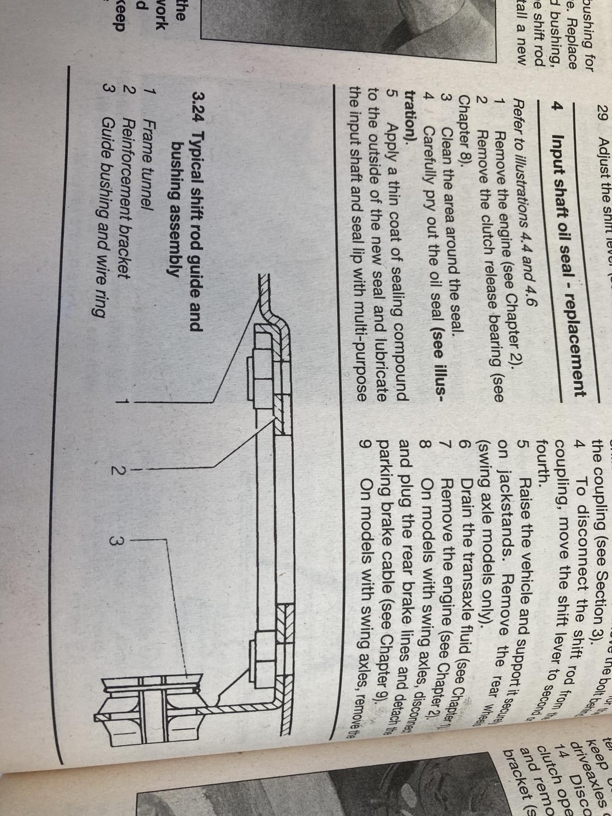

Notice no clip either in this illustration.
The Haynes manual has the clip in the illustration.
