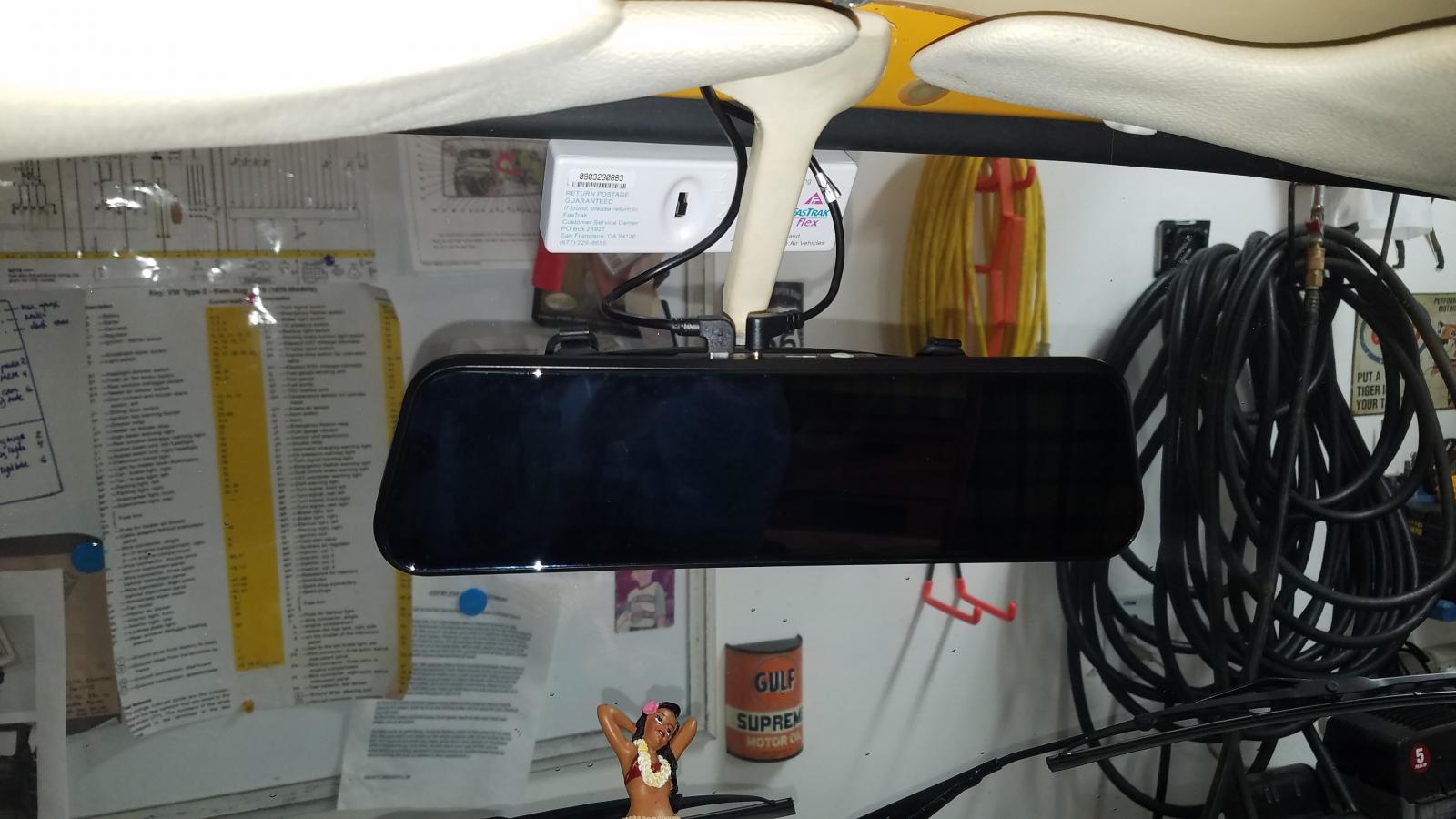

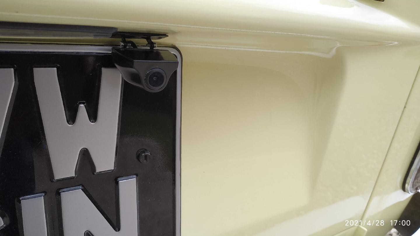

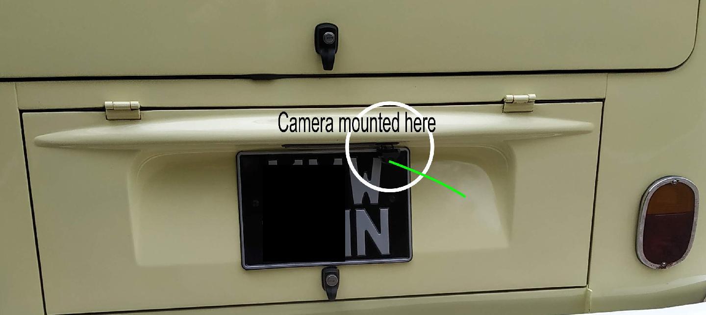

PostPosted: Tue Mar 09, 2021 1:10 pm    Post subject: Re: Rearview mirror dashcam camera Reply with quote

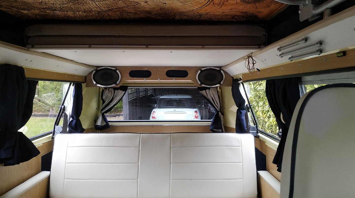

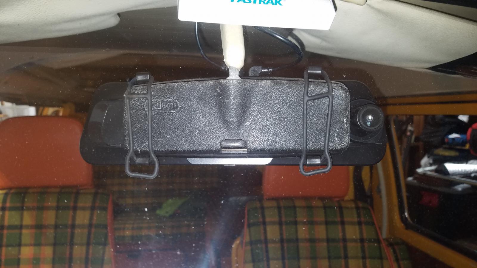

I installed a camera system on my rear view mirror and I am very happy with it.
It is a Vantop H610. You may be tempted to buy the 12" version. Do not as it will interfere with your visors. I purchased the add on hardwire kit as I did not want to power it with my cigarette lighter.
I like the parking monitor and I also like the ability to scroll on the rear view mirror screen to control and move move the field of vision of the rear camera. With my mounting, I can scroll all the way to the ground and see everything behind the bus and then raise the camera to monitor traffic just like a regular rear view mirror but with much greater field of vision and recording added. It also connects to your reverse circuit and provides a visual assist in the form of on screen colored lines when reversing.
I also decided to mount the rear camera inside to avoid damage/theft. The field of vision down near the rear license plate is not ideal for our buses. My chosen location really maximizes the field of vision. I surrounded the camera with a closed cell foam protective housing to prevent damage from rear cargo. I also covered that housing in Sunbrella fabric to match my curtains. The decal on the rear window helps make the camera less obvious. Hope this helps you. I am very happy and the increased safety and visibility really changes the driving experience.
https://www.vantop.com/products/vantop-h610-dash-camera Also available on Amazon.

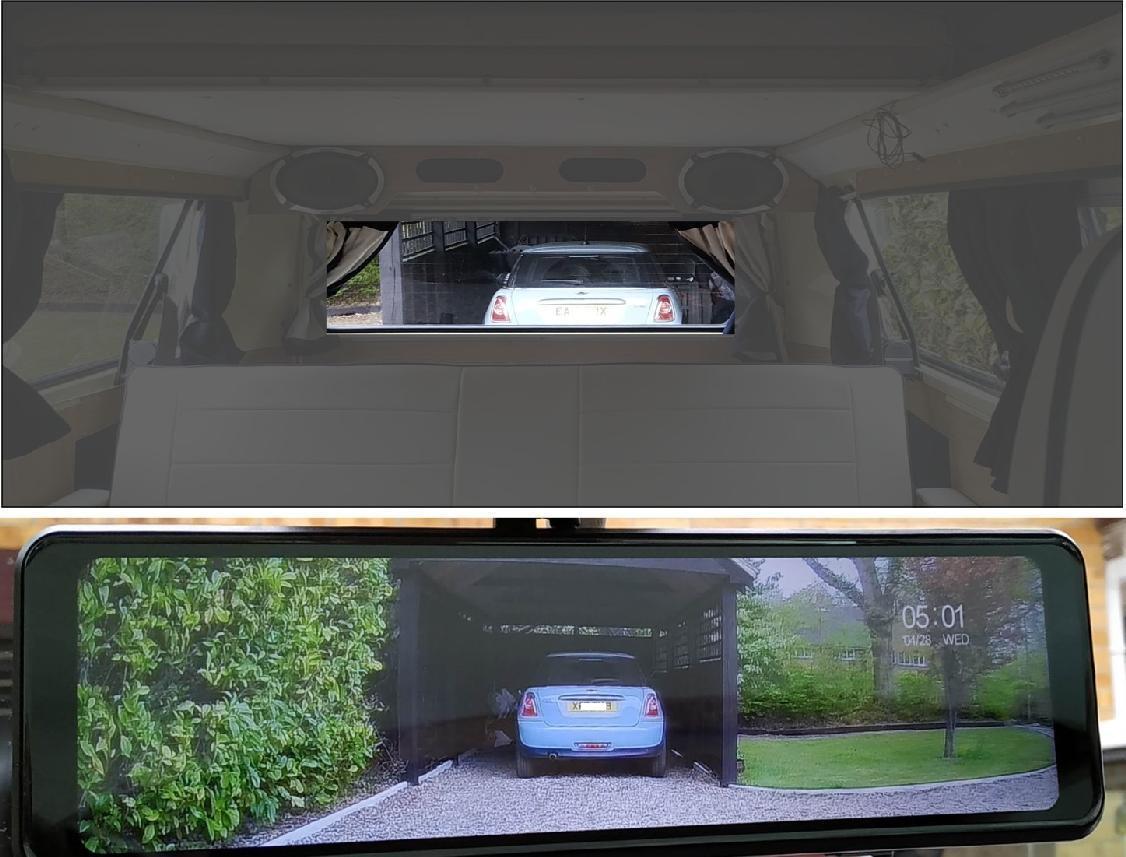

PostPosted: Wed Mar 10, 2021 1:23 am    Post subject: Re: Rearview mirror dashcam camera Reply with quote
thanks for posting that BUSBOSS.
I looked up the mirror and its a 10" , it doesn't look out of place at all.
I'd imagined it would be much to big/bulky but it looks ok.
Have you had it long? and what length cable did you use front to back camera, I see options for 6m or 10m?
thanks again, really appreciated !
PG

PostPosted: Wed Mar 10, 2021 10:04 am    Post subject: Re: Rearview mirror dashcam camera Reply with quote
PG
You are welcome. It is a 10" and hence the H610 model number - it fits perfectly in my opinion and does not look out of place from the interior or exterior. I have had it for about 9 months and went with the longer cable. I ran it in the headliner and then in the A pillar and then along the roof line channel to the back closet area. You might get away with the shorter cable if you follow that same route but I didn't chance it. If you run the cable under the bus, you definitely need the longer cable.

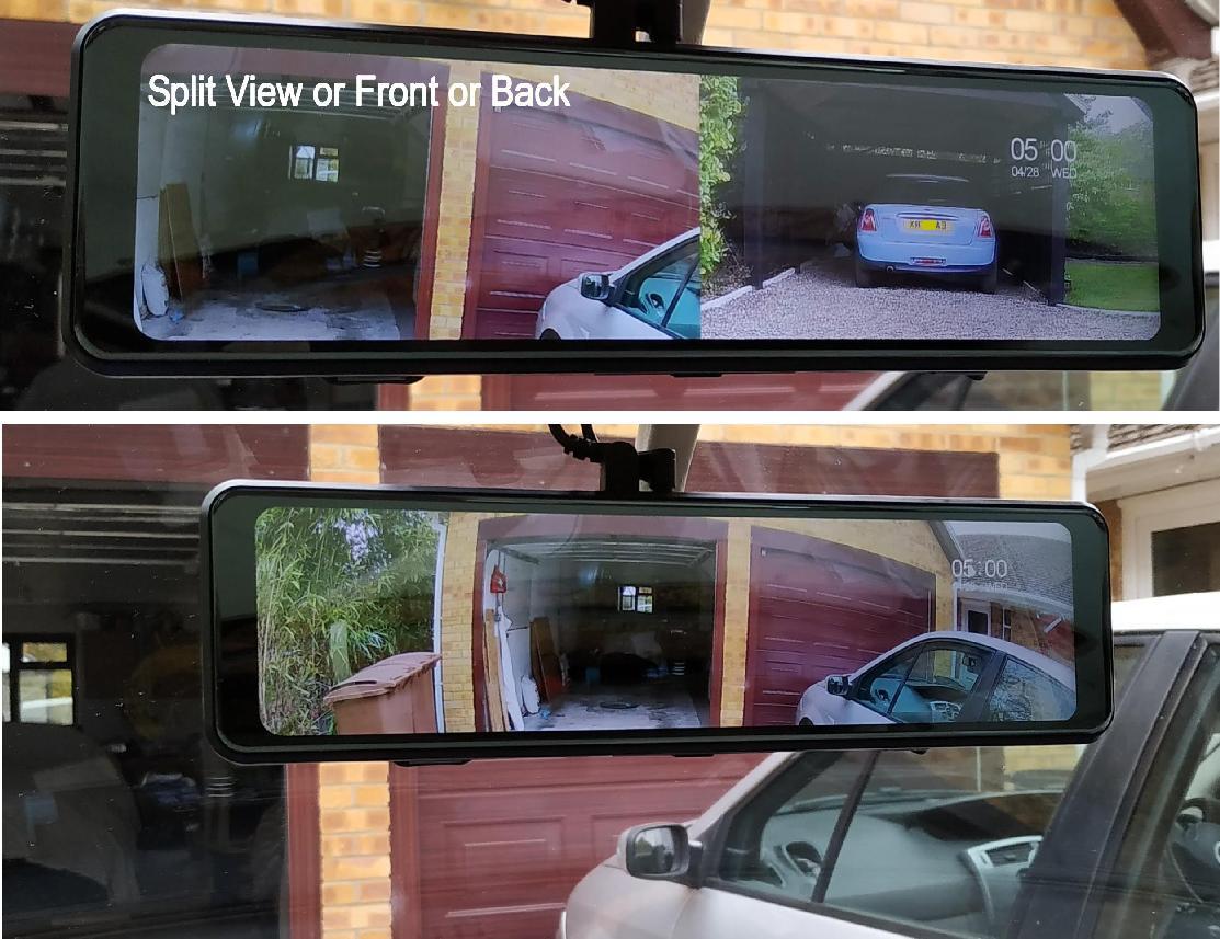

PostPosted: Thu Mar 11, 2021 3:49 am    Post subject: Re: Rearview mirror dashcam camera Reply with quote
One more Q Boss,
the sliding out camera, I see on yours its sliding out to the left.
So if you are LHD it slides out in front of your line of vision ?
I guess you are LHD?
Do you find that obstructs vision a little bit.?
I ask because I can get one with the camera that slides out from left or right but unsure which to get, I've got a LHD bus but (as I'm UK based) I drive on the right.
My thought was to get a slide out camera that slide away from me?
PG

PostPosted: Thu Mar 11, 2021 9:20 am    Post subject: Re: Rearview mirror dashcam camera Reply with quote
pgtips wrote:
One more Q Boss,
If you look closely at the photo taken from outside the bus you can see that the front facing camera does not extend out beyond the frame of the mirror. There is absolutely no obstruction with line of sight.

I use it almost exclusively as a rear camera. My rear camera is tilted down and I have had no issues with sunlight interfering with the view. I don't work for the company, get any kickbacks, and I paid for my product. I truly think it is one of the best additions I have made to my bus in terms of the driving experience. And it is under $100. If you buy it, I don't think you will regret it.

PostPosted: Thu Apr 08, 2021 3:54 am    Post subject: Re: Rearview mirror dashcam camera Reply with quote
How did you run the power for it? and i noticed you said there was an option for a longer cable for the rearview camera, is that something they ask you during purchase or an add on you can do? Very interested in something like this for our bus, as there is no way to see out the back!
58 ragtop bug on 61 pan / 71 bay window photo booth bus / 79 bay window California bus
BUSBOSS
Joined: January 21, 2009
Posts: 2161
Location: Northern California
BUSBOSS is offline
PostPosted: Thu Apr 08, 2021 4:08 am    Post subject: Re: Rearview mirror dashcam camera Reply with quote
I wired a Blue Sea Aux fuse box sourced by my aux battery and connected it there. It looks like they provide the longer cable as standard now.
Thank you, if you have any pictures of the power wires, that would be great. I have a 71 bay window which is converted to a mobile photo booth, but you cant see out the back window when driving or reversing, so something like this would be a real help. Also interested to see how you ran your aux battery!

Follow up from my about rear view mirror cameras I got mine fitted last night and thought I'd post up now I've got it installed.
I think this is a brilliant upgrade btw and I'm pleased with it.
I wanted a mirror that was similar in size to my existing one but that's pretty impossible to find, so I opted for a 10.88" Jansite, a newer model with a decent camera. Not too big, some are 12". Cost me £93 incl P&P with a 64gb card.
Less than half what the repair for my reversing into a low post was a couple of years ago!.
Its got two cameras, a front and a rear and records both cameras on a loop
Rear camera mount, for now mines attached with double sided number plate tape which means its not permanent but will be adequate for the job.
I read a lot of reviews, a few people say its lame in direct sunlight or rain but to be honest the view out the back of my van isn't great in the same conditions so a camera can't be any worse.
Fitting wise I ran it around the screen rubber so its barely noticeable, I got a 10m cable as suggested by BusBoss (option is 6m or 10m) which I thought would be a bit too long but by the time I had neatened up the runs there wasn't that much left. I drilled a hole in my spare wheel well to go into the engine bay and another hole behind the rear number plate to pass the camera cable through. The mirror itself clamps on over your existing mirror using bungee straps. Once I'm def sure about it I might make it a bit more permanent.
There's another "reversing cable" as well which can show parallel reverse lines onscreen if you want them, its an option you simply attach it to your reversing light cable and it works when you select reverse (guidelines appear onscreen).
I don't have reverse lights but there's been a cable in my rear loom redundant years, now it has a home !
When I powered up the screen (wiring is 3 wires, ign live, a perm battery live and earth) it was a "wow look at that".
What would be visible normally in rearview mirror
What I actually see out the back behind me is this tiny bit
With the camera mirror no obstruction in the view
I didn't realise you could do this (no pics unfortunately) but it can scroll up and down as though you are scrolling your phone screen (so imagine a picture and what you see is the middle of the picture on the screen, you have the option to scroll up to the top of the image or the bottom) so I can adjust the view to see close to the floor (low obstructions when reversing) or up higher than the normal view (overhanging tree or something). You just slide your finger up or down on the screen. By default (tap twice) it shows the centre.
Instead of just rear you can choose to see the front camera view or choose split of front and back view. It seems a bit pointless bar setting up the front view for recording, but its there anyway. So 3 view options.
Its really weird adjusting the mirror inside the van, obviously the image stays the same but your mind is used to the reflection moving about when you adjust.
The unit records on a continuous loop both cameras. If you are thinking of getting one make sure you get the camera on the same side you sit, there are options for L or R sided front facing cameras. It has to mimic your view of the road and be on the same side you sit. I like the fact its constantly recording, a dash cam front and rear.
When you turn off the ign the mirror shuts down.
It has a few basic options you can adjust, settings for contrast etc but its not complicated. Bottom line is its a mirror replacement with the added benefit it records. I did at one point start to look into if they come with sat nav options but I use my phone for that and I couldn't really see the benefit of more stuff on the screen.
Even though the mirror is bigger I don't think its obstructive. I think most modern motors have bigger mirrors so its something I'm used to anyway. It looks ok from the outside as well.
Because the original mirror is quite small the camera you can see on the right doesn't have to be extended, it just fits. I read some people said the mirror attachment rubber bands can be a bit flaky, it seems ok at the moment but if I can fix my bus by the side of the road I can stop a mirror wobbling, if it does happen I'll probably use mounting tape behind the unit to adhere it to the mirror more permanently.
Its a decent price and I like it, a good upgrade. If someone else is looking into these I hope this helped. A big thanks for the forum replies.
PG
