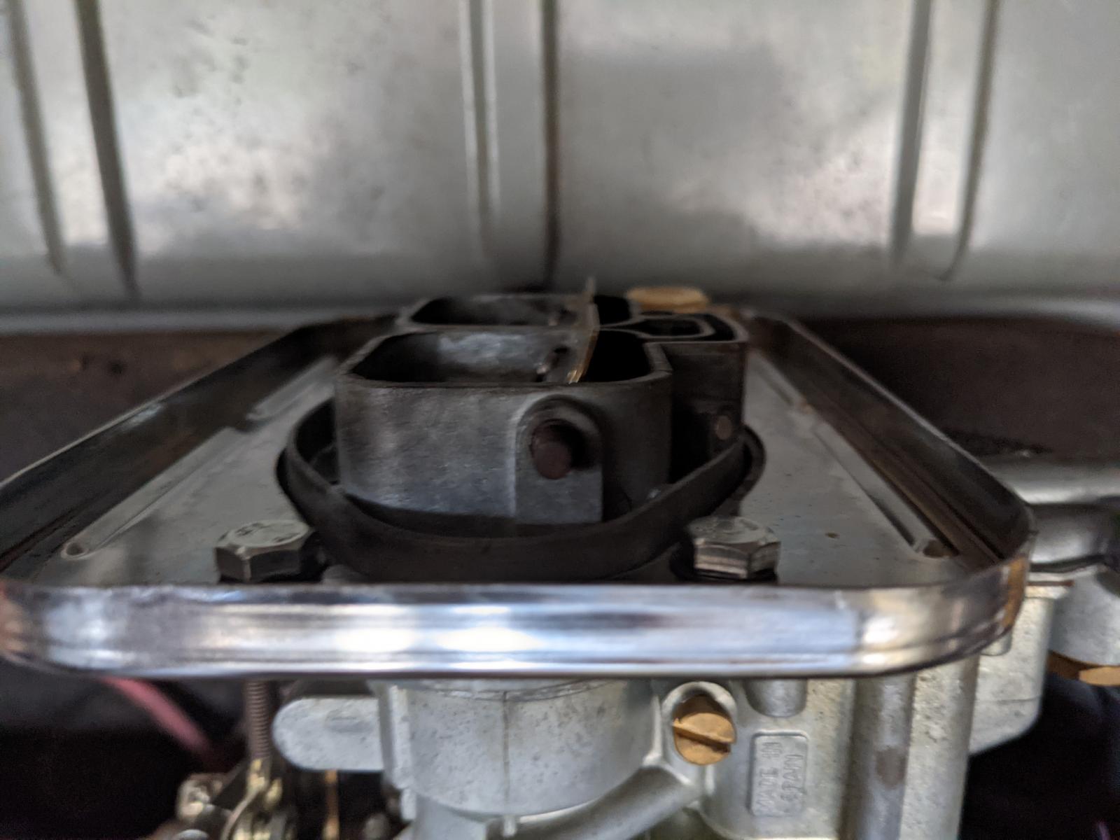

Thank you for the information. It looks to be set the way you describe. Here are a couple of pictures one after just starting and the other after a few minutes. Video link of the start up https://photos.app.goo.gl/q2k543tigJ8hY2Fb8

PostPosted: Tue Mar 09, 2021 9:18 pm    Post subject: Re: Running when Cold (or Not running well) Reply with quote
If you are letting your engine run for 5 minutes before driving off, maybe you are getting carburetor icing occurring and it just won't run well until the engine warms enough for the icing to dissipate.
I usually only allow my engine to run for a minute or so after a cold start before I drive off and not long afterwards with the engine being forced to work, the heads are dumping enough heat into my intake air preheat system that icing can not occur.
Note that when trying to move the choke butterfly by hand, to get the choke to close you need to simultaneously open the throttle a bit.

PostPosted: Tue Mar 09, 2021 10:42 pm    Post subject: Re: Running when Cold (or Not running well) Reply with quote
An eighth of an inch might just be the warm oil expanding. Check it again when cold.
As said, these carbs are real bad for icing. As the engine is warming up, you intake runners are getting colder and colder. After 5 minutes they are so cold that the fuel isn’t much of a vapor any more and you’ll get poor throttle response. Try starting up and just go. I bet it runs better for the first few miles. Still, you’re fighting an uphill battle trying to make your engine run good with that carb.

PostPosted: Wed Mar 10, 2021 4:59 am    Post subject: Re: Running when Cold (or Not running well) Reply with quote

PostPosted: Wed Mar 10, 2021 1:43 pm    Post subject: Re: Running when Cold (or Not running well) Reply with quote
Ryan P wrote:
When I rebuilt the carb last year there was a hole in the bottom of the air filter plate that did not have any connection to it. Could this have been a way to get warm air to the carb(crankcase vent hose was on top)?
Wildthings wrote:
Does your thermostat system work properly? A properly operating thermostat is important in the cooler months to get the engine to warm up quickly and stay warm.
Good question, I did not know it had a thermostat until now. I will have a look today.
The get in and go is what raised this post. When I left for work the other morning this is pretty much what I did. The longer it sits warming up the better it gets going.
Yes, 12v to the choke heater tag. Then the choke will cancel "because the engine has warmed up" after a while. It cancels temporarily at high RPM through an internal vacuum actuator.
The brass pipe is a feed for vacuum advance signal to an SVDA distributor.
If you think you are getting fuel in the oil, then change the fuel metering needle valve in the carburettor: they wear with vibration and leak. And possibly fit a solenoid shutoff valve in the fuel line to stop the fuel metering valve dripping while it is stopped.

PostPosted: Wed Mar 10, 2021 4:09 pm    Post subject: Re: Running when Cold (or Not running well) Reply with quote
Sorry, I should have said the picture of the carb is from before I rebuilt it. I have the red-circled items taken care of. I grab the picture from an old post of mine. The question is what do you think the PO had connected to the port coming out of the bottom of the air filter plate. He had the Crankcase hose on the top.
