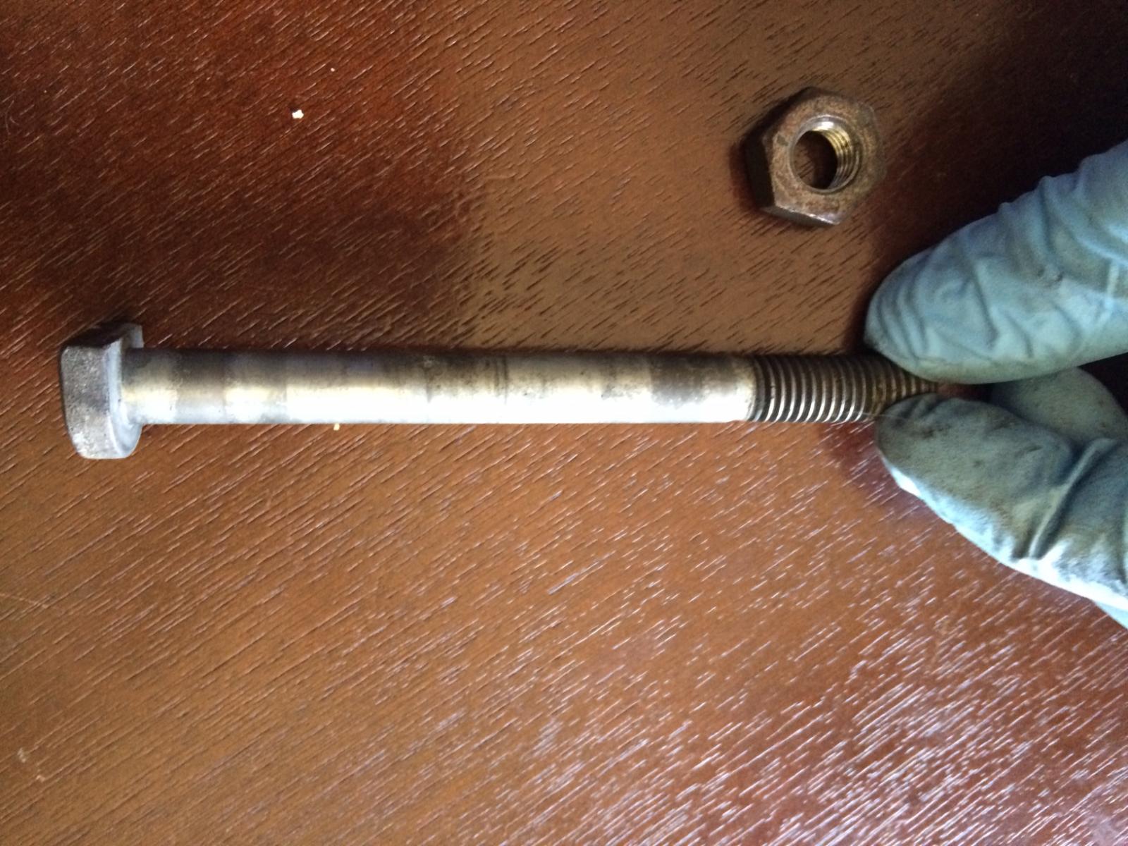

hi all,
I decided to replace my muffler and manifold this last week and when I finally got it all apart I noticed that all of my engine compartment seals are shot. Completely torn, rotted, etc. In the process of researching I've seen that it's much easier to remove the engine to replace the firewall and other seals.
Well, I started looking at my engine mounts and a couple items stuck out.
1. There is no bolt on the drivers side top of the engine.
2. The bolt for the passenger side top looks like it's not correct. I noticed this because the bolt was spinning freely, which I assumed wasn't good. I tried to remove the bolt only to find that the nut on the front is 17mm but the backside of the bolt is an odd shape. See pic:
So my questions are pretty obvious:
1. Is it really necessary to remove the engine to replace the firewall and other seals?
2. I've read that the driver's side upper engine bolt isn't essential. (seems odd but ok). Do I need it and what size is it?
3. Is the bolt I found on the passenger side upper engine mount correct and if not what is the correct size/kind of bolt? If it's correct, what in the world do I use to hold the bolt end to tighten it?
4. Is there anything else I should do maintenance-wise while I'm this far in?
Thanks as always,
Brett

1. Yes.... while possible, it will drive you insane trying to do it.
2. Yes you need it. M10x70mm
3. It is correct. It has a "D" head and should be M10x110mm
4. Check your throwout bearing and tranny input shaft seal.

The bolt in your picture is for the passenger side top (assuming left hand drive)
It is like that due to the starter. The flat spot is what keeps it from turning when you tighten the other end.
Unfortunately it is common to not replace the top drivers side bolt but I assume the designers put it there for a reason so I picked up a stainless bolt and nut at Ace Hardware for a buck or two and put one in. Can't remember the size but i am sure it is listed on a schematic somewhere or someone will chime in with it. I took another bolt to compare. Easy piece of mind.
Removing the engine is easy and will allow you to do the seal and firewall.
What else to do? If it is on the stand do whatever you can since it will all be accessible. I just did exhaust, cleaning, rear seal, new clutch, valve adjustment, rebuilt carb, intake boots, new fuel lines, etc because it was out and easy. Depends on what yours needs but most engine work is easier on the stand so take advantage of it being out and do what it needs.
Edit - we were typing at the same time. Never mind my post.....just read what Glenn said Wink

hi there,
I appreciate the reply. Of course I found some info on the d bolt after I posted. However, in my particular situation I don't see how the d design keeps it from spinning. When I split the d bolt into the left side all the way against the starter it just spins freely regardless the direction I turn it. Am I missing something?
Thanks,

If you remove the driver's side rear wheel it is a lot easier to get at the missing bolt. It is located just inboard of where the external clutch lever arm connects to the clutch cable. There may well be a nutsert already in the engine case, so all you have to do is thread in the bolt from the bell housing side. A short extension on a ratchet does wonders with a regular length socket.

I jus checked mine and when I get it seated right it stays tight. I can't get a picture from the other side though to show you.
If it was spinning how did you loosen the nut and get it out?

Unfortunately it was loose enough that I just worked my hand around back to the d side and used my other hand to unscrew the nut from it.
Perhaps when I get it tighter it magically stays without turning?

It is only held on place when it is fully rearwards and engages with the bellhousing or starter, not sure which of the two. If you push it forward a 1/2" while attempting to thread on the nut, it is no longer engaged, and will spin freely.

For some reason even when I push it all the way as far back toward the engine (flush against starter), it still spins freely. perhaps I'm missing something on the starter or bell housing?

The "D" bolt at the starter is shoved through the upper starter flange with the flat side of the "D" resting against the body of the starter. It cannot turn once engaged in this manner.
However, when you try to install that bolt's nut, the bolt wants to back out on you. There are two methods to keep this from happening.
The first, go to ACE Hardware and get some plumber's putty. It comes in a small tub. Clean the bolt and area where the bolt will meet the starter flange. Get a bit of putty and make a snake--like when you were a kid, playing with Play-doh. The snake should be about 1/4 inch thick and about an inch long. Wrap the snake around the inside edge of the "D" in the bolt and squish it on well. Stick the bolt in the starter flange hole and squish it home. You may have to push it home with a screwdriver.
Now the bolt is temporarily stuck in position.
Now go around to the engine compartment and gently start the nut on the protruding starter-bolt head. Finger it down as tight as you can. Then finish it off with your wrench--only 22 lbs., if I remember correctly.
The putty will have squished out and it will fall into oblivion.
The second method? Some people simply duct tape the bolt at the back side of the "D". I have never tried this and it seems like it's a bit too tight in there to get the tape onto the "D" head.
Remove the duct tape after tightening the nut.
Get the top driver-side bolt, too. It's no big deal to install it, using two extensions, stuck together; a socket/rachet, and a flashlight to see the hole.

3rd method: get a kid to help for that step.
Actually, I've always been able to shove that D-head bold rearward into position, then carefully get the nut started in the engine compartment. After the nut catches, I pull the nut towards the rear as I tighten, to keep the D head in position. Once it's tight enough that it stays "caught", then I can use my 17mm socket or 17mm box wrench; next time I will try my 17mm "gear" wrench there, to see if it has enough room...

Well, trying to set that nut on the "D" bolt--for me, at least--without the plumber's-putty trick is like playing a game of Wack-A-Mole. But the score is ass-backwards ....

Image from Asiab3
Here you can see the "D" is supposed to wedge against a piece on the starter. If yours no longer has a place to wedge it against I would suggest replacing it with a normal head bolt and getting help tightening it down.
What I did to hold it in place is to put a piece of electrical tape around the shaft right next to the head, it's able to wedge it into the hole enough to let me start tightening it.

I used duct tape to hold the bolt. Worked fine for me. Just have to be gentle when you start the nut, and as you are turning the nut pull the bolt towards the fan housing to keep it locked into place on the starter.

I just rest a small sledgehammer on top of the transmission and it holds the bolt in place, just don't forget to grab that hammer when you're done!
