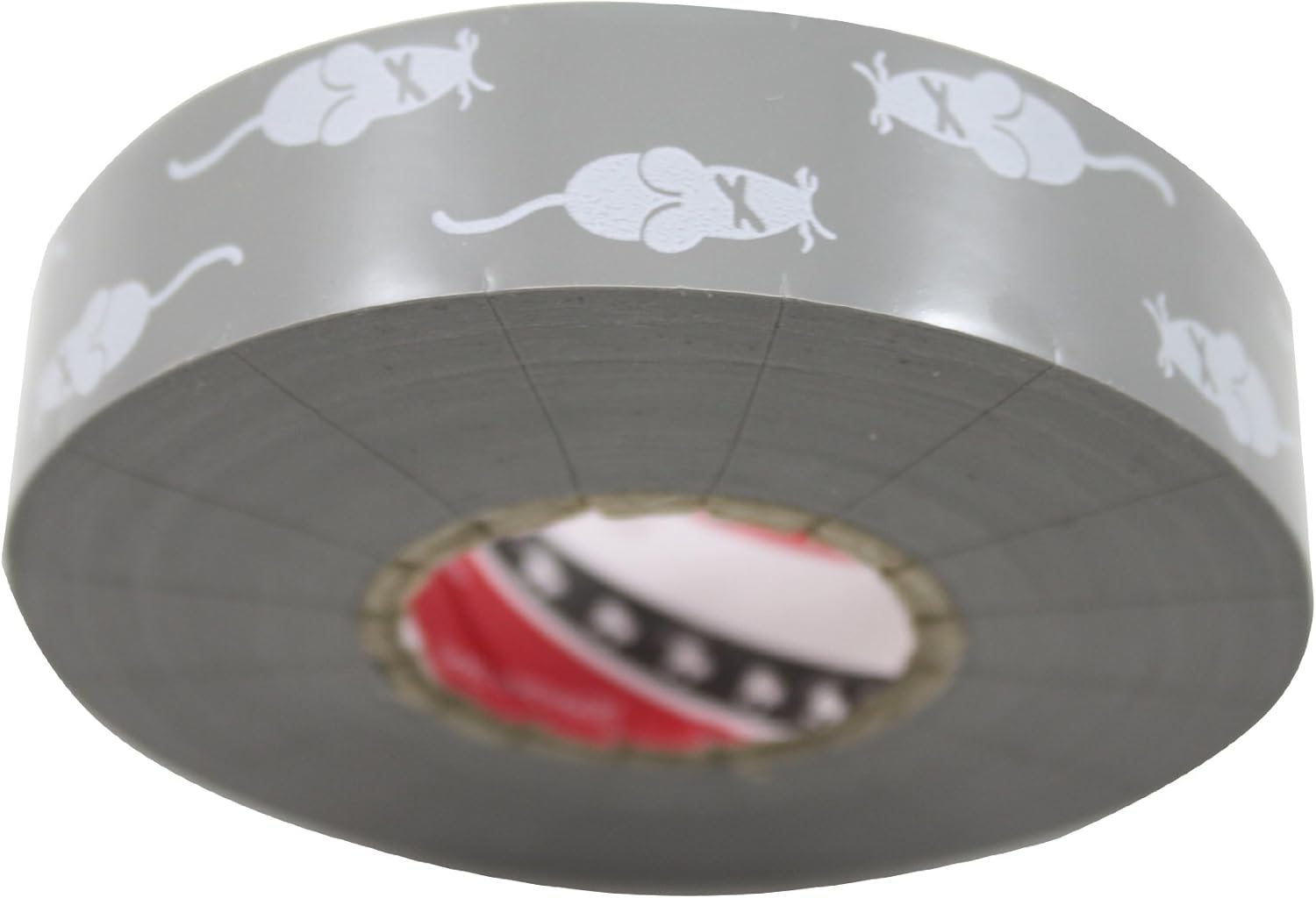

I used to deal with chewed wiring all the time when I worked for Porsche, one of the things I was told in tech school (not sure if true or not just wanted to share) is that in recent years companies are using some form of soy in the wiring sheathing, whether it be oil or powder I don't know exactly. 1 thing I do know for sure, is that Honda sells a rodent tape, it's a light gray tape with a white "NO symbol" (the circle with the line thru it) and it has a mouse head in the circle,it smells terrible I was told to use gloves when handling it. I guess it has some form of poison in it.... I don't know the cost of said tape, nor do I know exactly how to ask for it, but I do know i was given 2 rolls from a customer who was in for his 3rd wiring repair. Might be worth checking out. hope this helps not only you but others as well.

colbysmith28 wrote:
.... 1 thing I do know for sure, is that Honda sells a rodent tape, it's a light gray tape with a white "NO symbol" (the circle with the line thru it) and it has a mouse head in the circle,it smells terrible I was told to use gloves when handling it. .....
Honda PN 4019-2317 PVC tape impregnated with capsicum. about $45 for 65 feet. good idea.
slipping a stainless steel braid tube over the fuel line might be necessary in some areas. about $3/ft for 3/8" diameter. cheaper than a fire.
