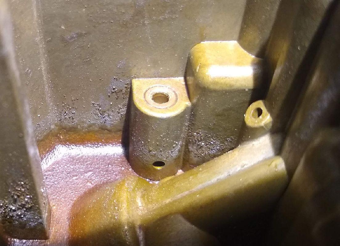

Hi All,
I'm back with my '67 beetle after about fifteen years of it waiting patiently in the garage for me.
So I'm starting to clean out the carburetor and notice the following:
No threads on the brass check ball plug! This is supposed to be M4 x 0.7 threaded for easy removal.
Someone on another thread (Cusser, maybe?) said he had to tap his, but I don't want to damage mine in the process. You can probably see the starting scratches of an aborted tapping attempt in the picture.
So, any tips, tricks, or alternate approaches out there?
Thanks.

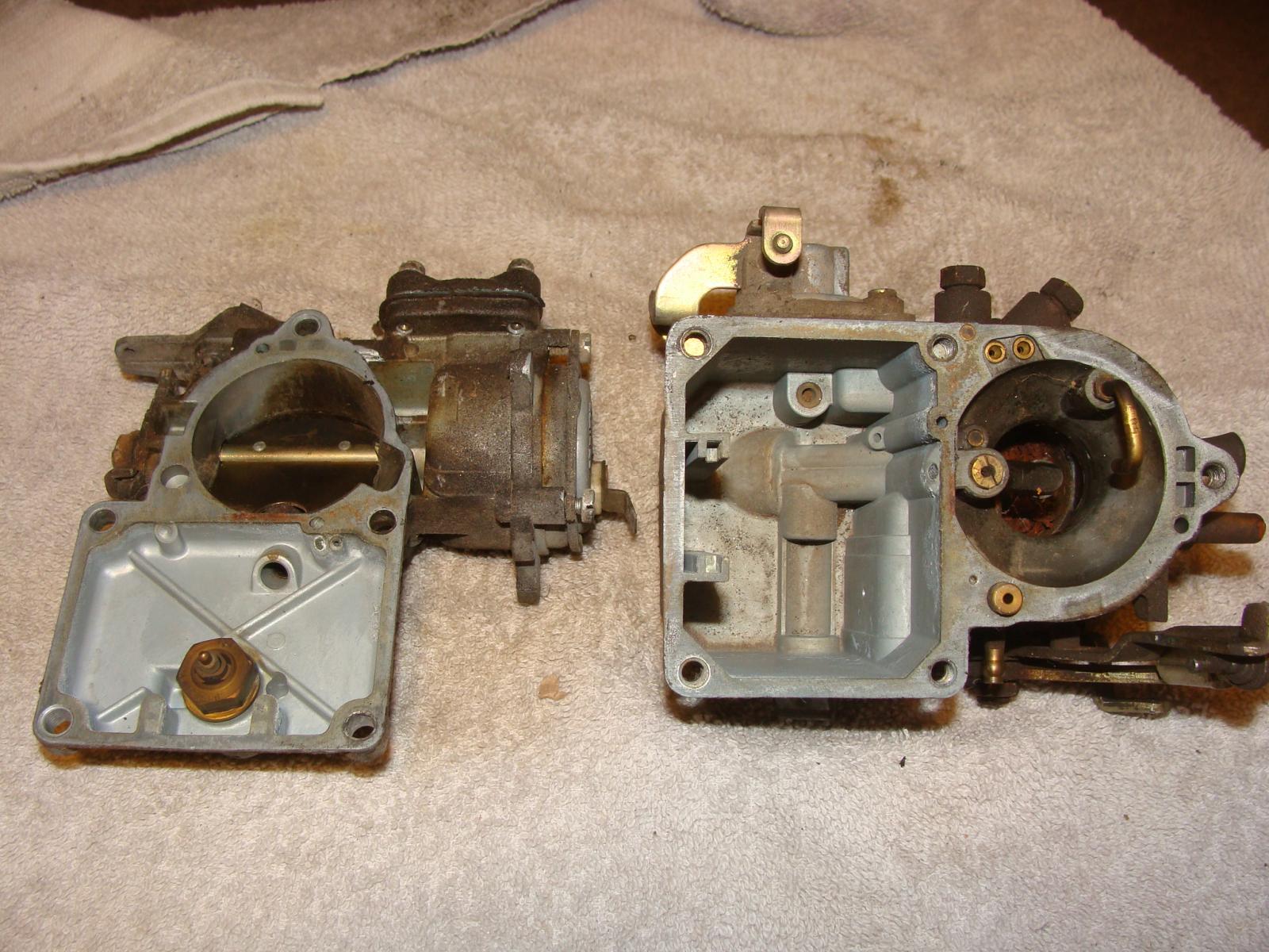

Further information:
I opened up a Brazilian H30/31 I had obtained as a spare, and it showed the same unthreaded plug. So I'm guessing it was a feature of some rebuild kits.
I'm thinking of using my newly purchased M4 x .7 stainless steel machine screw/plug extraction tool and some force to tap into the brass plug directly, but I will probably wimp out and buy the right sized tap instead.

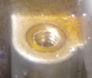

Here is the newly threaded plug:

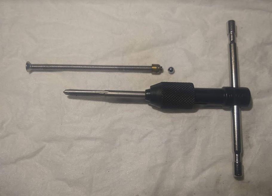

And here is the successfully extracted check ball, plug, "extraction tool" (a long M4 x 0.7 screw), and the tap that made it all possible:
