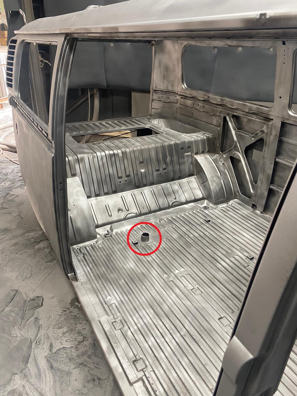

Hi forum,
I'm looking for the triangular shaped heater outlet under the rear bench. It directs the hot air through the ventilation. On my M-plate, it's the D53/005 option. I have only seen one picture of this item online but i can't seem to find it back. When I bought my bus, the outline of the item was still on the wood, but the original owner closed off the hole (no idea why). Can someone tell me what this part is called, what part number it has, or where I can find it online ?

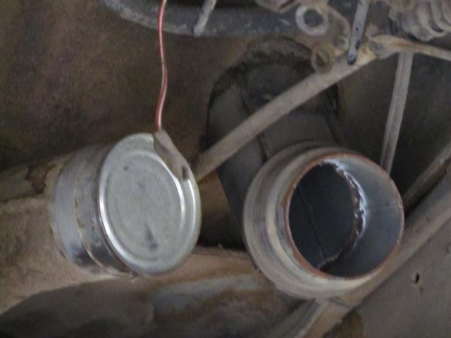

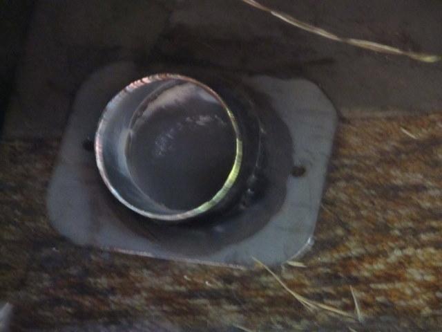

Do yourself a favor and copy what I did. Instead of fixing the stock VW system what supplies an anemic amount of heat at best, take all the air from the right heater box and direct it to come out under the rear seat. Doing this by itself with double the amount of heat reaching the cab, but be wary of what you put in front of the outlet as the temperature of the air will approach 400°F on a long climb and will melt and destroy many non metallic items.

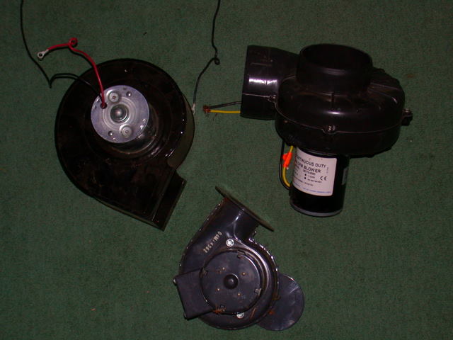

If you then add a booster fan up front under the floor beneath the defroster tee, you will get even more airflow to the front than you have now, so will have more and hotter air to both the front and back. Over all I get more than three times the stock amount of heat moving into the cab.
Under seat outlet
Ducting to under seat outlet from engine side, note that it connects directly to the accordion tube
I just have a top quality inline bilge fan, but there are centrifugal fans available
Check out the Bluemaxx thread and ignore the naysayers, my system including the plastic fan is now almost 12 years old:
