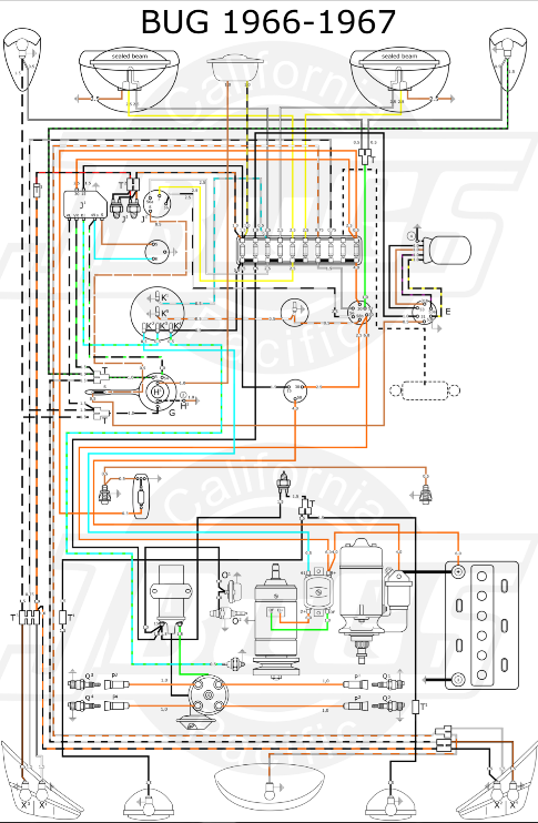

Actually all the stock wiring diagrams you may need are right here in this site, found under the "Technical" tab in header....
OR if you want simple...

Well, I gotta do something different. I ran the blue wire from the regulator, to a light, to the on wire coming off the ignition switch (black) and the light just stays on when the switch is on, whether the engine is running or not.
Is the regulator supposed to break the ground when the engine is running for the light to go out? That circuit also has the coil wire on it but no grounds per se.
BTW, my steering golumn is out of '72 ghia so I am going by that schematic in the Tech Section.
Suggestions? |

| ... Is the regulator supposed to break the ground when the engine is running for the light to go out? |
Yes, that's how the idiot light indicates all's well with the generator. (That is, of course, provided all actually is okay.) But your light stays on, even tho you're sure charging system is working properly?
