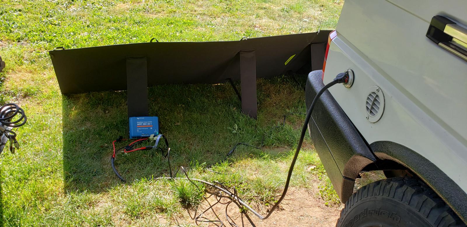

This is a small part of a much larger project where I'm replacing most of my 12v connectors with Anderson Powerpole's. In this phase, I replaced my old zamp SAE solar port with the Powerwerx Panel Mount Housing for Two Anderson Powerpole Connectors with a Weather Resistant Cover.

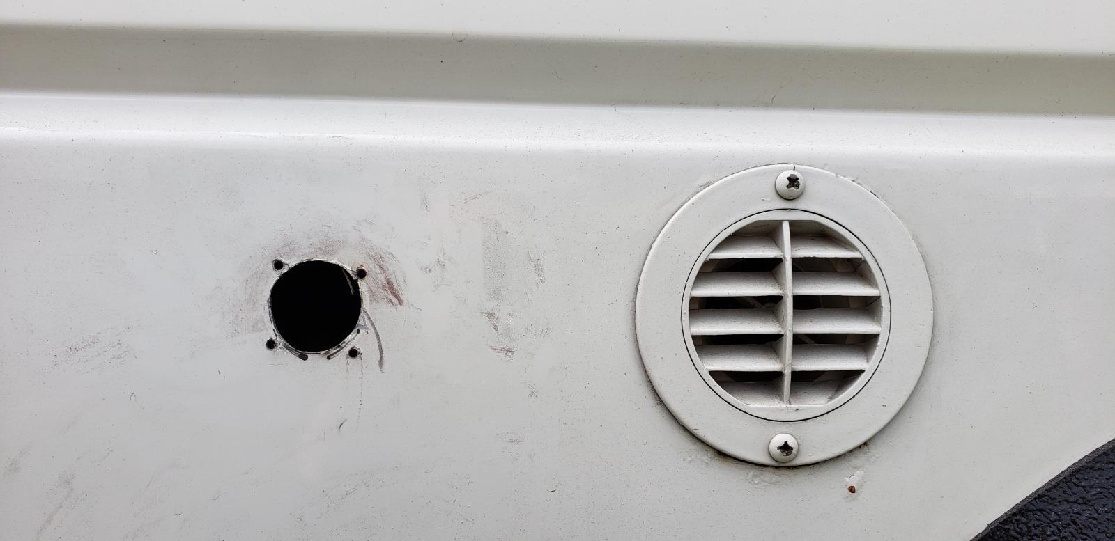

The old zamp SAE removed:

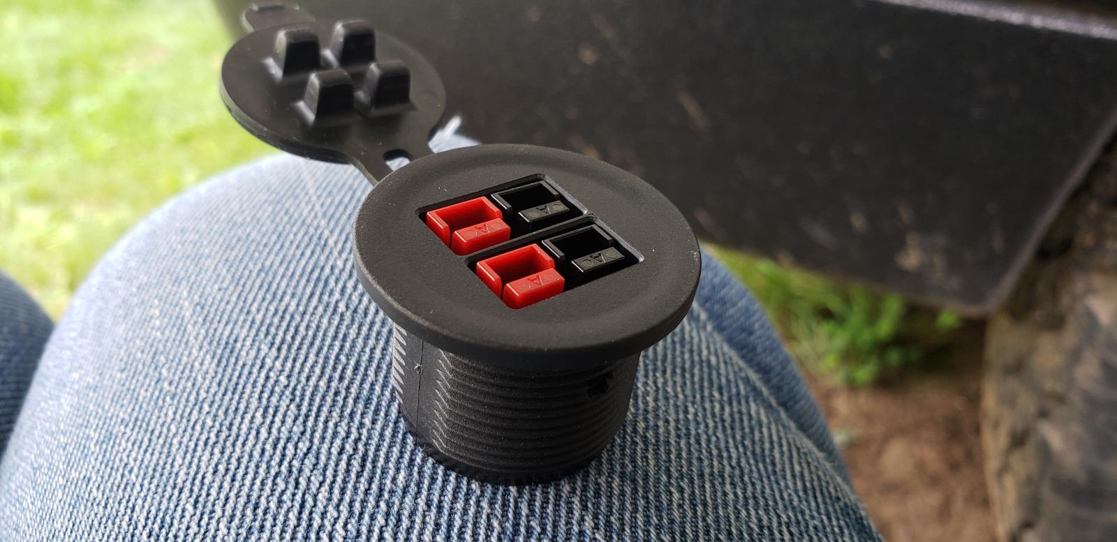

The new Powerwerx Housing:

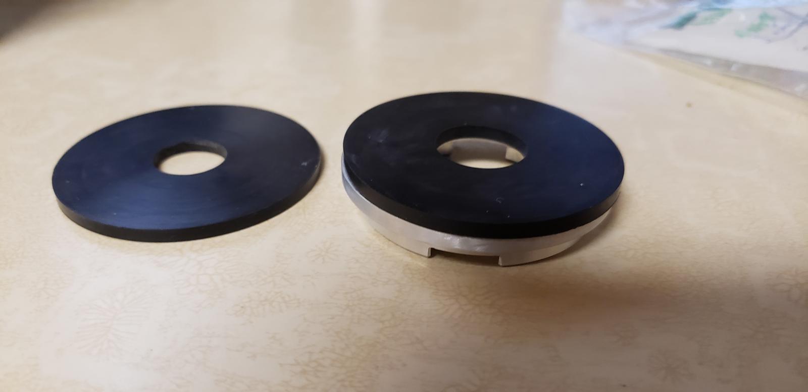

I should have taken a picture showing the aluminum housing a co-worker fabricated that would cover the old screw holes & accomondate the new housing.
Here are the Ace Hardware neoprene washers I found that fit the outer dimensions perfectly. Just had to enlarge the inner hole:

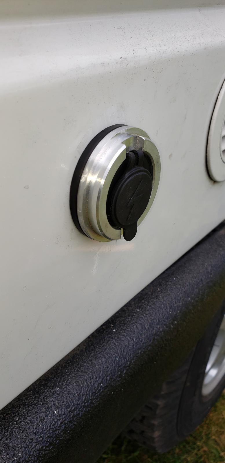

Outside view:
This Powerwerx housing connects to my new Bluesea fuse box. I can charge the house battery and also connect various accessories to this port. I have a battery selector that I use to switch between the house battery & my Goal Zero Yeti 1500X. This housing will also let me charge the GZ 1500X while it sits safely inside my van.
