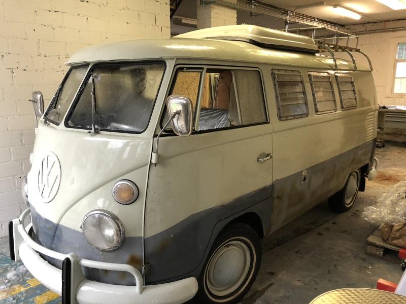

This is how the bus arrived just a few days before christmas. I had someone in the US sandblasting the lower part of the bus for me. Saltwater and snow/rain have gone through the primer. I wouldn't do that overseas next time.

Seeing the pictures from the Samba ad, I have a question. I looks like it doesn't have any serious rust on the outside skin.
Why did you take the paint off the bottom half by sandblasting?

Was that original paint?

Apparently the current paint job is not 100% original.
Only saying this because the worn away sticker that says TR/BG... and the paint code on the M-code plate (523320).
1963-1967 Westfalia/Commercial Codes/Special Order Paint Code:
The code is preceded by 523 where 5 = export model and 23 = Model Kombi)
320 = Beige grey over Titian red

Yes, the bus was original two colored and I want to bring it back to it's original colors. My agent in the US did some closeup pics and there we have seen that paint bubbles are present, an indication for rust under the paint. Also the paint job wasn't good. As it turned out, it was just an overspray and the original paint is still under some layers. Looking back, I would probably strip away the upper layers and try to preserve the original. But now it is sandblasted on the lower half and therefore I will probably do a full professional paint job in the correct colors.
Door inside has still the red coloring.

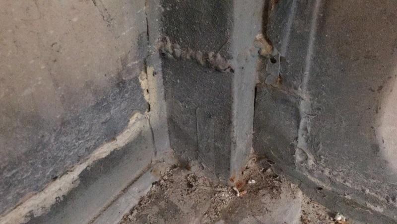

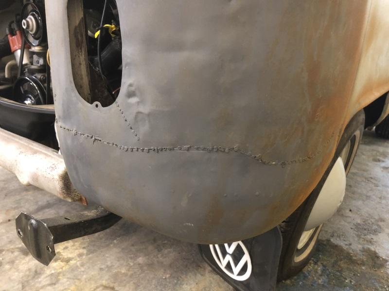

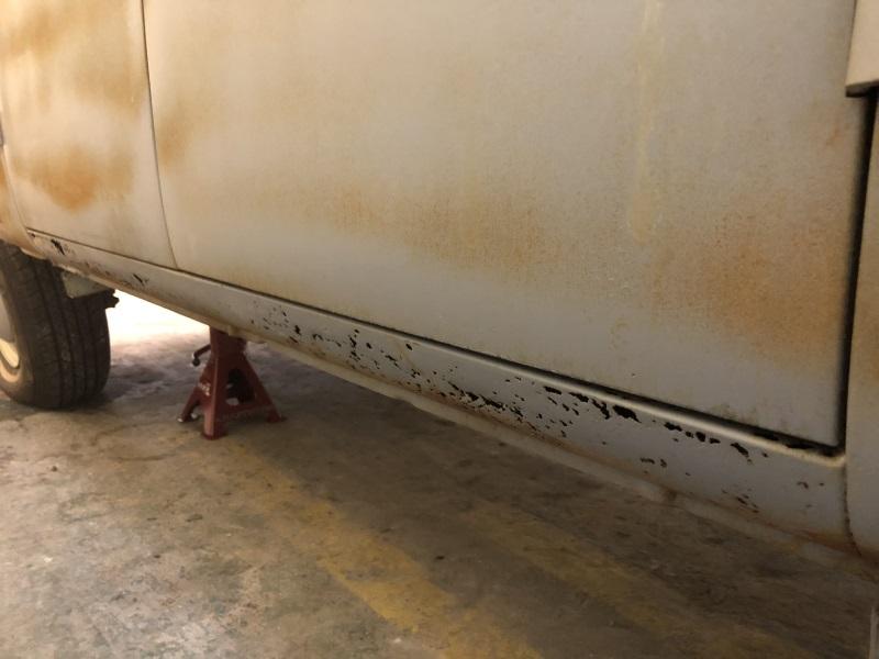

PostPosted: Tue Jan 09, 2018 3:17 pm    Post subject: Re: Swiss cheese - 1967 westy Reply with quote
Here we go with the rust issues. My agent did replace the front floor and fixed issues with the doglegs.
Front floor before:
Left dogleg before:
Parcel tray:
Left side (previous owner did a fix, but doesn't look good):
Same location from the inside:
Cargo rocker:
Behind cargo door:
Cargo door locking plate (also C pillar issues):
Cargo door has some fixing too?:
Left B pillar behind wall:
Left corner:
Right corner:
Battery tray (replaced but not nice):
Heating tube needs to be replaced:
Baggage area got some water too:
As you can see, there are a few spots and some previous owner repairs which I want (need) to fix.

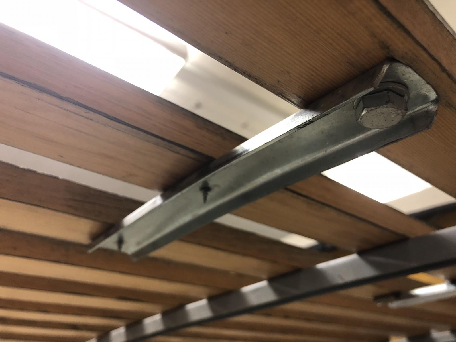

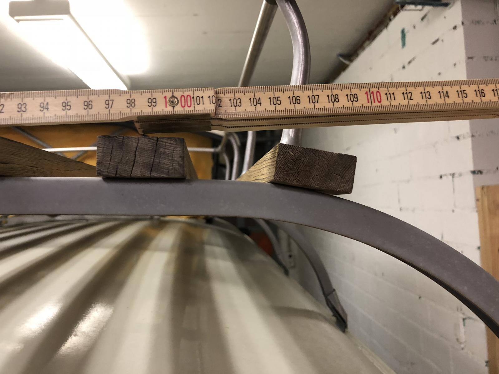

To me, everything about that rack says '62ish and in fine condition. Can you post pictures of the fasteners holding the clamps both machine screw head and nuts and describe what you think the fastener materials/coating are?
swiss_bulli
Joined: February 17, 2017
Posts: 123
Location: Switzerland
swiss_bulli is offline
PostPosted: Fri Jan 19, 2018 11:51 am    Post subject: Re: Swiss cheese - 1967 westy Reply with quote
Barry, here is a close shoot of the clamp and the width and length of the wood slats (in metric / centimeters). I can check the rest on Sunday.

PostPosted: Fri Jan 19, 2018 5:08 pm    Post subject: Re: Swiss cheese - 1967 westy Reply with quote
Looks like a reproduction rack to me. Uprights and corner pieces look like they do not have a casting ridge. Bows are painted the same grey color like on repo racks. Repo clamp hardware.

PostPosted: Fri Jan 19, 2018 5:40 pm    Post subject: Re: Swiss cheese - 1967 westy Reply with quote
Definitely a repro rack/clamps. Its next to impossible to buy a Westy and not have to find at least a few important bits (your's looks very compete though).
