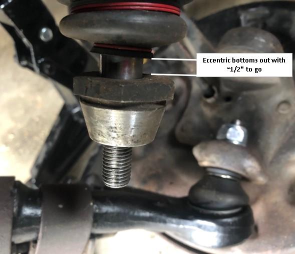

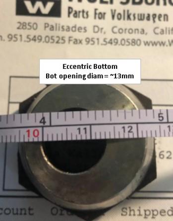

I ordered new Ball Joints for my '66 Beetle from Wolfsburg West. A local shop pressed them into the torsion arms and I installed them. The first thing I noticed was that the washers did not fit over the BJ threads, so I drilled them out. When to trying to put the upper BJ into the eccentric, it does not seat. It appears that the BJ taper is too large to fit into the eccentric (see pics). I called WCM and they said there are no other BJ's for this year, so I must have the wrong size eccentrics (?). I have since ordered a new set of eccentrics from WW, after confirming that their eccentrics have larger openings in them. I am hoping they will fit into the hole in the steering knuckle.
Has anyone seen this before? Are there different sizes eccentrics (smaller) on other VW models and someone along they way swapped out steering knuckles, BJ's, etc.?

'67 'stuff' was of a smaller diameter that '69 'stuff'. Like tie rod ends and inner wheel bearings, not sure of ball joints.

Thing eccentrics have a larger hole for a larger joint shaft. Maybe the joints you received are mistakenly packaged Thing joints.

I would get a caliper, do some measuring, and calling on specs before ordering any more parts. There are three different eccentrics similar to a Beetle, Type 1 for Beetle/Ghia, Type 181 for Thing, and Type 2 for the Bay Buses. Pretty sure a Bus Ball joint isnít going to fit in a Beetle torsion arm, so that pretty much rules that out. Either your ball joint was made incorrectly, or packaged incorrectly. In the hundreds of joints Iíve installed in arms/on cars, Iíve never had an issue with the eccentric not fitting properly with at least five different manufacturers joints. Any of the aftermarket eccentrics Iíve used have been the exact dimensions of the stock ones, outside, and inside diameter. Iím going to assume the new eccentrics you get are going to do the same thing as the ones you have.
