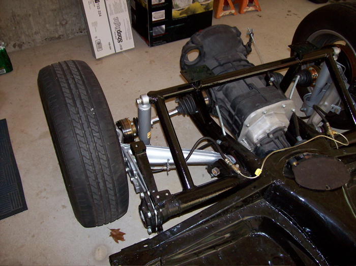

The kit is for this style front mount. Rear mounts are different, also. But I think the kit would replace all of it. You could probably fabricate a front mount.
Nuts missing in the pic.
