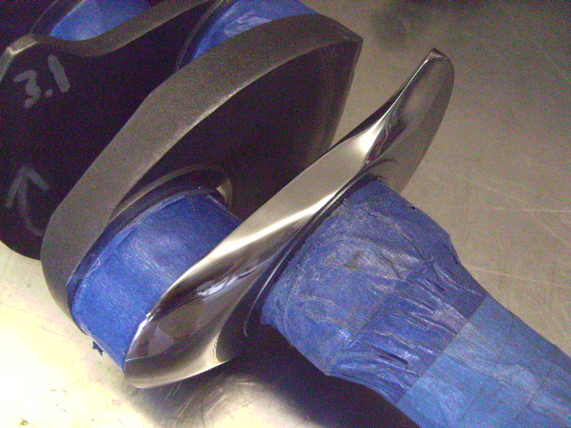

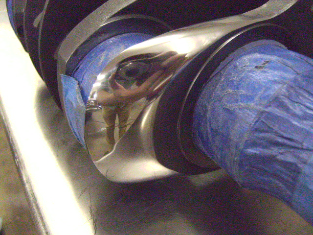

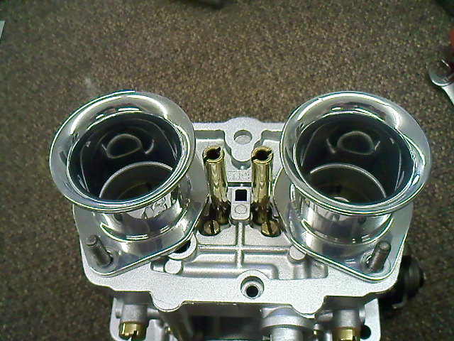

Here's my method for polishing aluminum.
If its a cast part that hasn't been previously smoothed/polished, I'll use a grinder with various sanding drums and flap wheels to smooth the part. Then use 120-180 grit with a 3M Wetordry sponge pad to get the part "leveled", kinda like block sanding body filler or primer. You don't want the reflection to be distorted.
If the part has already been polished but is dull/damaged, figure out an appropriate grit to remove the imperfections without creating excessively deep scratches.
Once the part is leveled, then begin smoothing the finish by using progressively finer grit sand paper. I like 3M wetordry paper, or even better Nikken/Meguires' Unigrit paper. Add a little dish detergent to your water to lube the sandpaper and keep it from clogging as easily. If using a water bucket for your wetsanding, wash out the bucket and get fresh water whenever you work up to the next finer grit.
If working up from 220 grit or rougher, I like to cover the part with a guide coat to make sure I've sanded out all of the previous step's sanding scratches. Sharpie markers and Dykem works well.
Once all the rough grit sanding is done, start working up to finer grit paper, making sure to get all of the previous step's sanding scratches out or they'll show up later on. Each time you change to a finer grit, also change the direction you are sanding. For example, sand the part top to bottom with 220 grit until all you see are sanding scratches that go from top to bottom. When you move up to 320, sand from side to side until all the top to bottom sanding scratches are gone. This is how you will know that all of the rougher sanding scratches are gone.
Work up through these grits, cleaning the part between steps. You don't want leftover sanding residue that has rougher grit in it than the sandpaper you've moved up to; you'll never get all the rougher grit scratches out without cleaning the part thoroughly.
120-180
220
320
500
800
1000
1500

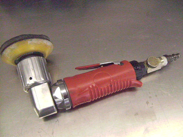

Once I work up to 1500 grit, I've got a 3" mini D/A sander/buffer that I use with Mirka Abralon wet sanding pads in 2000 and 4000 grit.
After all the sanding is done I use Wenol Metal Polish in the red tube and it comes out looking like chrome.
The biggest mistake people make when trying to polish is getting in a hurry and skipping steps. Polishing is just like bodywork/paint prep; you have to level and smooth the part before you can successfully make it shiny. Skip those steps and you'll have a very distorted reflection and not much of a shine.
A couple of examples of items polished using this method.
Crankshaft rod throws and counterweight edges. Steel, not aluminum but it's the same process:
Aluminum velocity stacks:

Astronaut, Nice work! Where did you get that 3 inch DA from?
theastronaut
Joined: November 19, 2007
Posts: 1635
Location: Anderson, SC
theastronaut is offline
PostPosted: Tue Oct 12, 2010 5:35 am    Post subject: Reply with quote
The DA/buffer came from Griot's Garage. They also sell an electric version. It's made for polishing swirl marks out of paint but works great for wetsanding too.
Pneumatic version with variable speed control and aimable exhaust:
http://www.griotsgarage.com/product/car+care/car+p...orbital.do
Electric version, also with variable speed control:

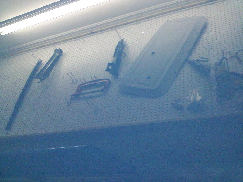

Another tip, this applies to bodywork and color sanding/buffing paint but the principle is the same for polishing metal.
When starting the rough bodywork- after the metal straightening is finished, use rougher grip paper to level the surface. Finer grit paper will just smooth the surface, not level it. You'll end up with a panel that is smooth and shiny but also distorted with ripples and waves, even if a sanding block was used.
Alot of guys block sand high-build primer starting with ~320 grit. This works to get the primer smooth, but doesn't do much to level the surface. I like to start with 80 and work up to 150-180 before going to the next round of block sanding. The rough paper on a flat block will easily shape the primer down flat, removing ripples and waves. Then using a guide coat to make sure the rough paper's scratches are gone, you can start to smooth the surface in preparation for paint.
When color sanding orange peel from paint, start off with 1000 grit to level the surface and then work up to ~3000 grit to ready the paint for buffing. You must have at least 3-4 coats of paint/clear to do this. Use a squeegee and check your progress often; stop sanding with 1000 grit as soon as the surface is leveled and all orange peel is gone. I like using Nikken/Meguires UniGrit paper to make sure the scratch left by the paper is a uniform size; some brands of sand paper don't have a uniform grit size and can leave deeper scratches that are hard to buff out.
Example of paint cut/buffed this way. Polishing aluminum using these principles produces the same results.
This is shot of the reflection of our pegboard storage wall. Notice that there is no distortion in the reflection; all the holes of the pegboard are lined up straight.
Painted panel on left (you can faintly see the outline- left of center in the pic), actual shop van in background on right:
If bodywork is 90% of a paint job; leveling and smoothing (removing all of the sanding scratches) is also 90% of a great polishing job.
That looks awesome Cool
