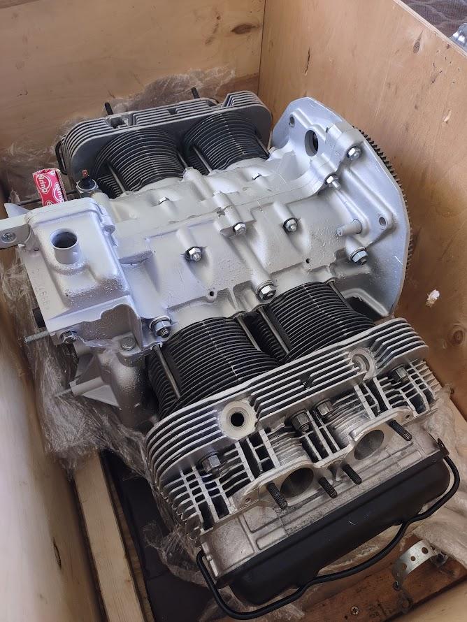

Due to the mileage of the van, around 190K I budgeted for a rebuilt engine.
After reading reviews here, contacting a few local builders and not so local, I went with Brothers' VW in Ontario. They had a type IV on the shelf and shipped it to me. It arrived today.

I'm not up to the time of learning and doing a rebuild myself, but swapping the engine seems like a fun couple of weekends.
