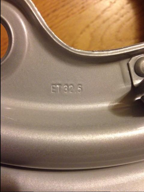

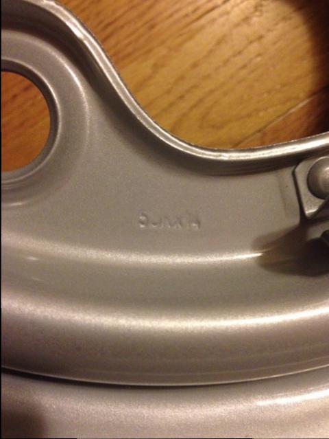

I know this is a dumb question but I have been looking for a couple days. I seen a picture on here of where the 5JKx14 is located on Thing Rims. I just can't find it. If any one could point me to that picture I would appreciate it. I am trying to buy some rims and want to make sure they are the correct rims.

The size is normally stamped near the bolt holes. 5JKx14 was also used on buses, but bus rims won't work on the front end of a 181 because they have the wrong offset. The correct offset is ET 32.5
Here are a couple of pictures of my spare. Oddly enough, I couldn't find a date code on the spare.

Thank you. Just what I needed.
