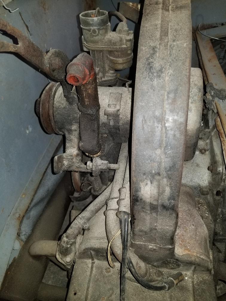

Can anyone help me ID an engine. There is only "14" stamped on the generator stand below the firing order casting. The engine is in a 1950 vw powered tempo matador which originally came with a 25 hp. Thanks.

looks like an aluminum case . believe they where used to early 50 ?
see if it has casting dates. that may be a clue. or replacement case .
is it complete? heads and tin are different 25hp vs. 36hp.
that will tell you more. or try a different forum. other vw vehicles / volksrods.
maybe better luck there. not to many of those around. cool ride.

The engine is complete and still installed in the Tempo. Where would casting dates be and what tin differences should I look for?

Here are a couple photos...left and right side of the motor:

Casting dates should be just under the fuel pump boss and on the left side of the generator pedestal.

Depending on the age of your engine case (up to early 1950 cases), you may find the casting dates behind the dizzy and generator stand, albeit covered by the fan shroud.

25hp for sure. very cool. looks to have all the correct stuff.

Found it! Tempo stamps the number between the fan housing and clutch.
If you can't read them...the casting on the generator stand is 4-8-20 and the engine number is 121-0220477

looks like a winner casting date 4th day 8th month 2nd production shift 1950 Applause
congrats. 121- must be a matador thing. 122 is industrial. no other vw
stamped the number there except type-3's probably easier to see due to the design .
i think there is only 10 or so known in existence. only made a few hundred.

js99nielsen
Joined: August 12, 2002
Posts: 116
Location: Battle Ground, WA
js99nielsen is offline
PostPosted: Thu Sep 29, 2022 4:38 pm    Post subject: Re: Engine ID help Reply with quote
Thanks for the info 50 split. Knowing there are 2 others with original engines does not dampen my excitement about mine. I'm actually glad there are others. These are awesome vehicles and the more that come to light for people to appreciate the better.
Now, do you have any spare parts? 😁
