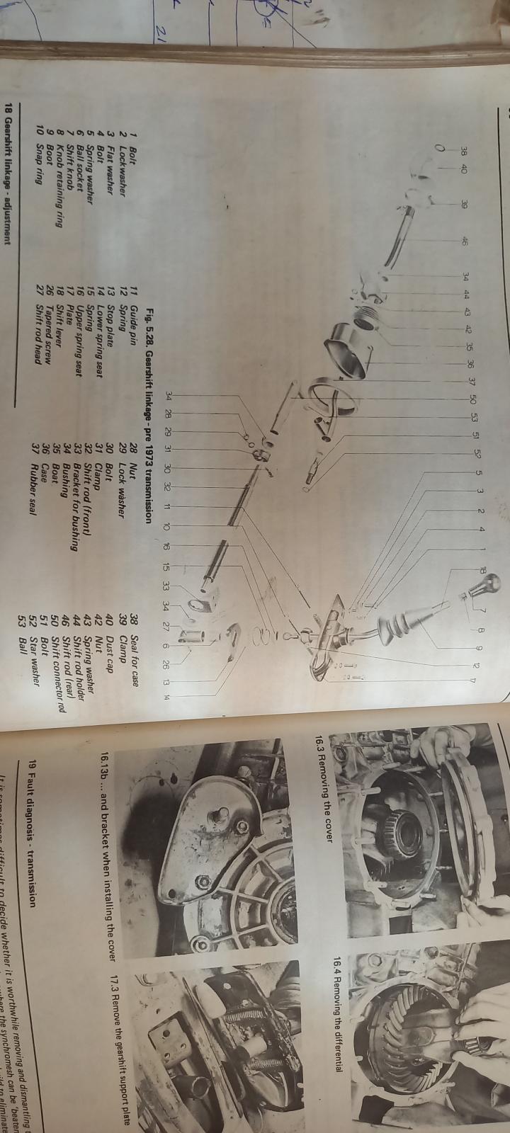

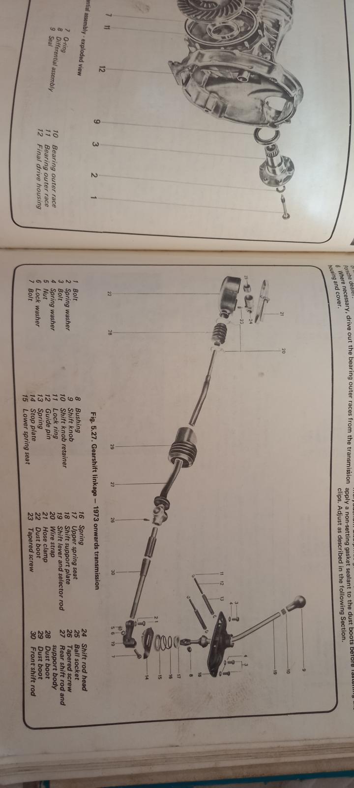

Your car is a pre 73 trany, in 72 at the end of the 914/6 production porsche decided redesign the linkage,as the pre 73 was difficult to adjust and keep that adjustment k within factory spec., leading a very mediocre gear change at best.
The 73 onwards was a great gearbox/linkage very smooth and precise.
What you will need to find is a complete 914 73 onwards gearbox linkage. It could be a bolt out ,bolt in the new or you might have to find and fit some a 73 onwards chassis steel work, so cut and weld. But well worth it either way.

You need everything in the 73 onwards pic bar the gear knob, by the looks of things some minor chassis work is needed or there might exist a kit out there. I would put higher compression euro 2056 pistons and cylinders while the engine is out, it makes all the difference especially with the earlier exhaust muffler.
